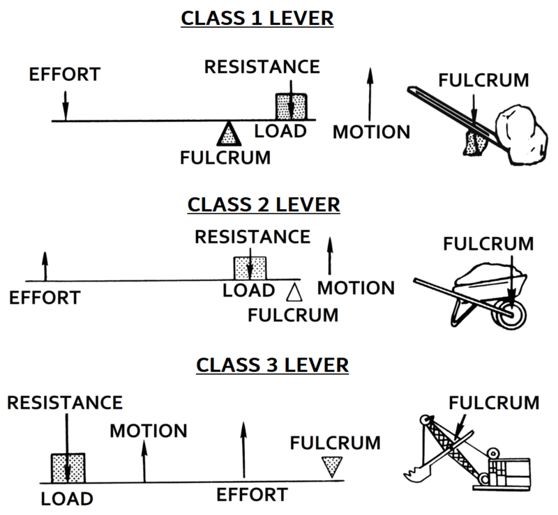

I have enough weight on my rear tires that tipping is not a concern. That being said looking at the physics of it weight in the rear tires does nothing to alleviate load on the front axle, and could even make it worse. A ballast box or heavy 3pt implement behind the tractor would however reduce the load on the front axle. Curious how big of a deal this is. Normally I have something on the back of the tractor but many times it is light enough that it probably isn't doing much.
   / Ballast to prevent overloading of front axle #2
You've got the right idea. Always have rear ballast when doing fel work. Loaded rears help keep the back end planted, where as 3 point ballast creates a fulcrum at the rear axle which takes some of the load off of the front axle.
   / Ballast to prevent overloading of front axle #3
This is debated a fair bit. If the front axle is considered to be the fulcrum rear ballast does nothing to reduce the front axle load.
If you have enough rear ballast then the rear axle becomes the fulcrum point.

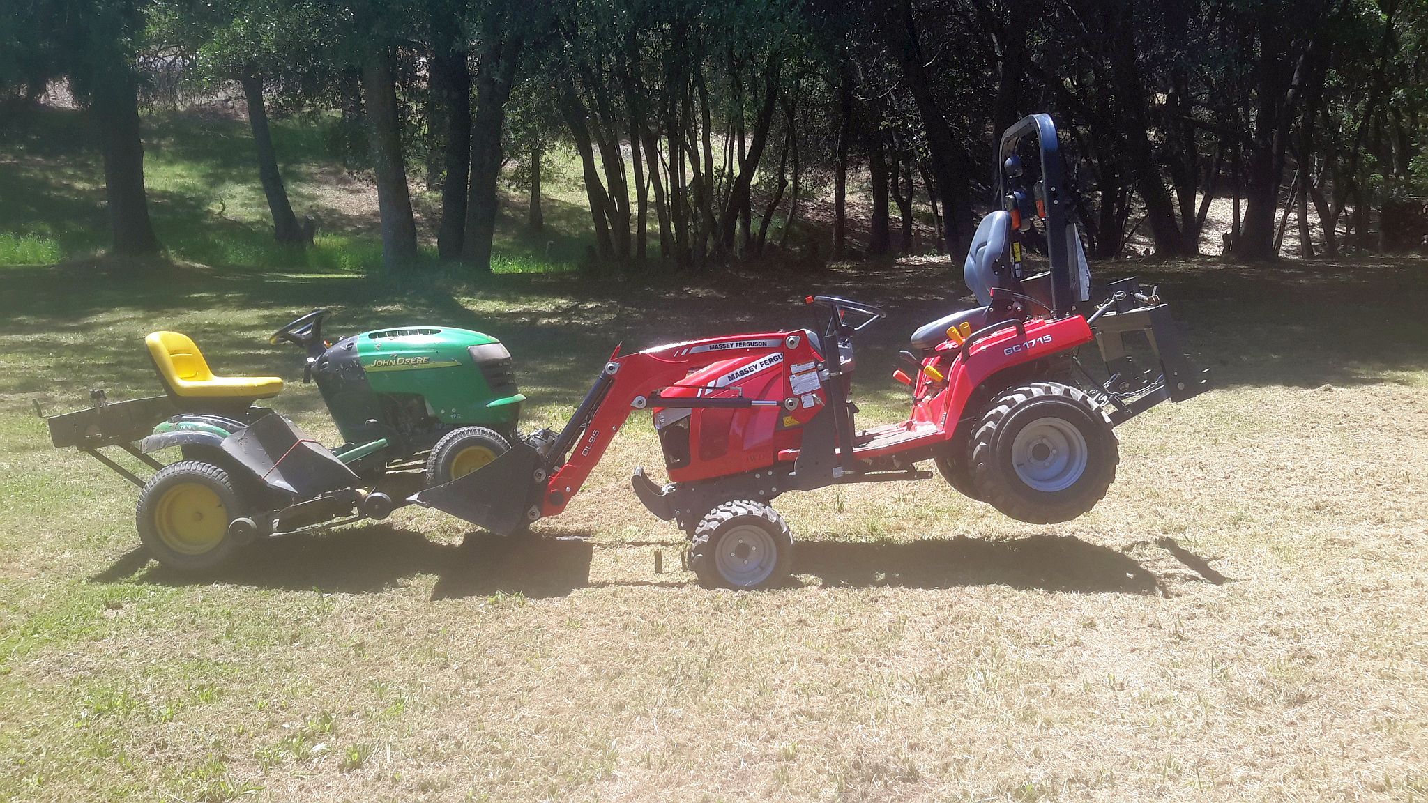

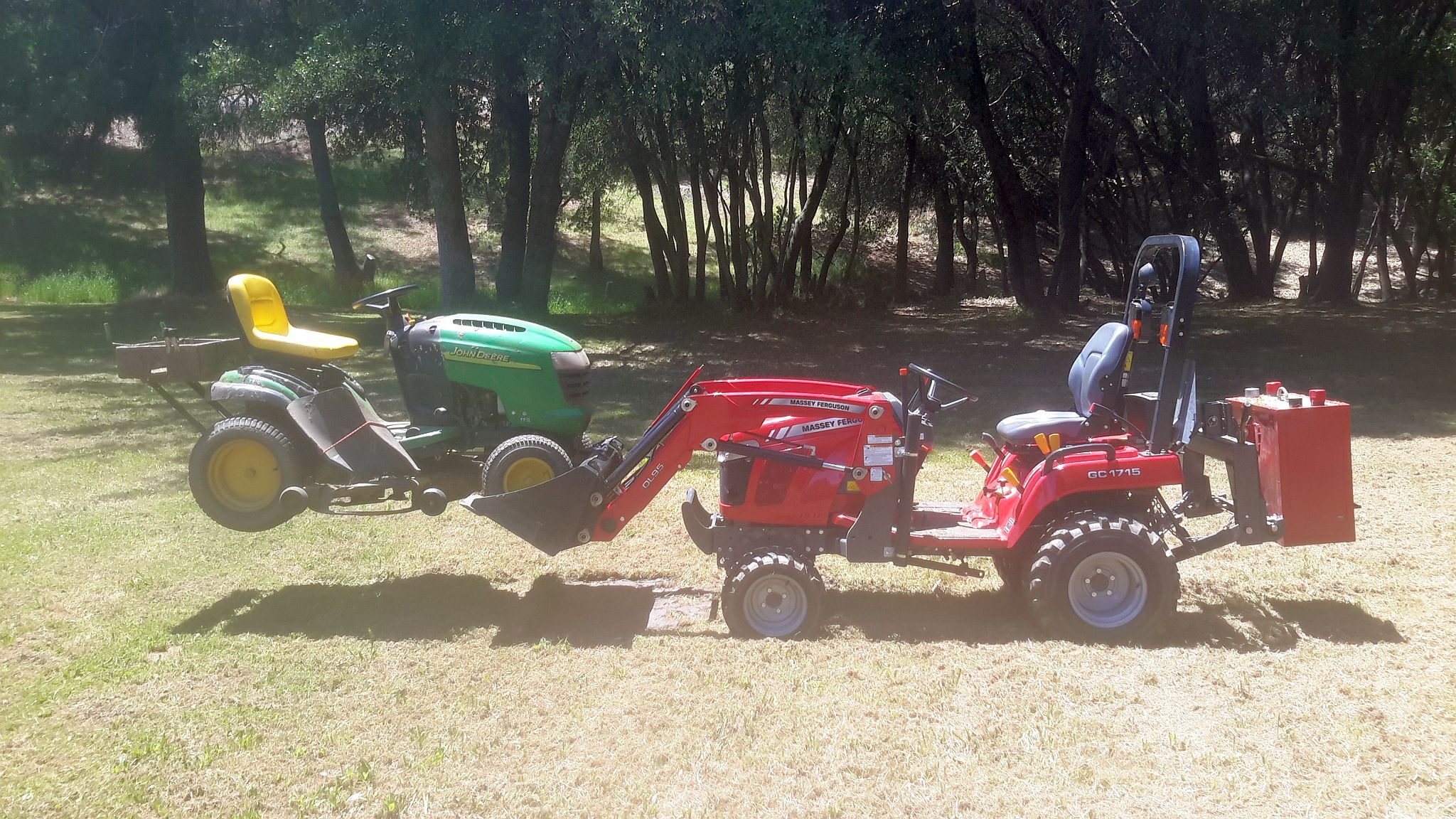

I like rear ballast for FEL Work.... about 500-600 pounds....
20190513_134020-jpg.604578
20190513_134501-jpg.604577
JD mower is 540 lbs by JD specs... Yes there is a low bumper on front of dead deere that is wedged under bucket lip....
   / Ballast to prevent overloading of front axle #8
"Yes there is a low bumper on front of dead deere that is wedged under bucket lip...."
You shouldn't have told us this. I was trying to figure out how the Deere was balancing so perfectly!
