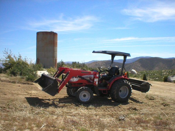

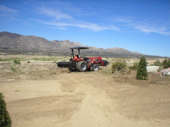

Arcspark, I have a Mahindra 3215HST, (is the same size as your CK35) I loaded my tires to just above the rim. (75%) I would get your your tires filled up to that point if it were me. All the extra weight that you can get will make the dirt work that you do that much easier. I typically work with a 66" heavy box blade on the 3PT and with that my rear has always been weighted sufficiently. I would recommend you plan on using the heaver weight on the rear.

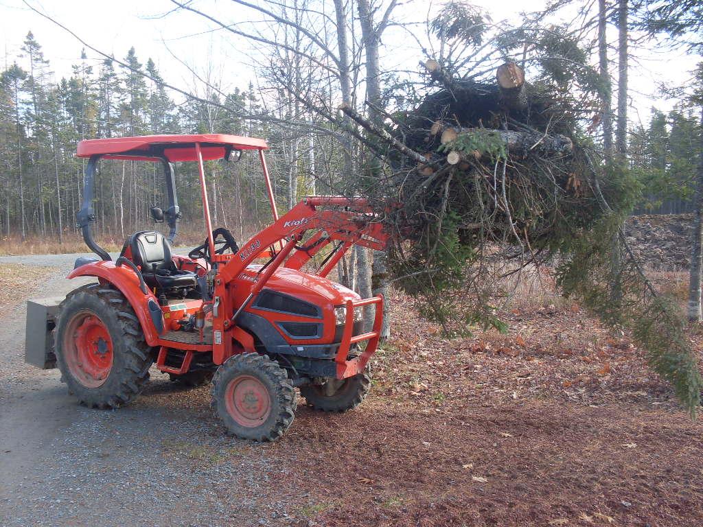

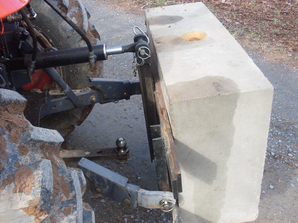

Here's my get up, just drop it off when not needed. Weighs about 900lbs
Steve

Hey Steve that is nice!
I don't have a ballast box yet and my tires are not loaded (a mistake I say that I should deal with).
I put the BH on whenever I do any serious loader work. It may be my imagination but I think the whole lift and drive is more stable with the ballast. Like the others said, I'd think nothing of 750 to 1000lbs. I use a box blade with a couple of suitcase type weights on it for light duty work so I don't think your idea of two different weights would have anything wrong with it. Doubt the light one would get used much though.
