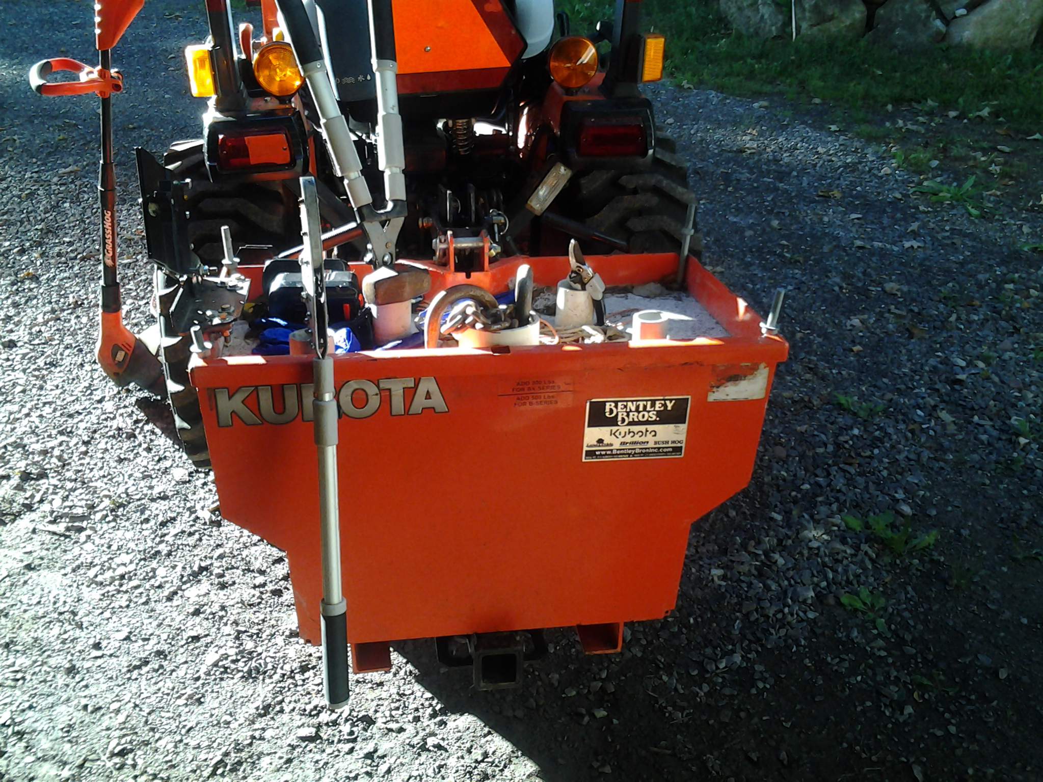

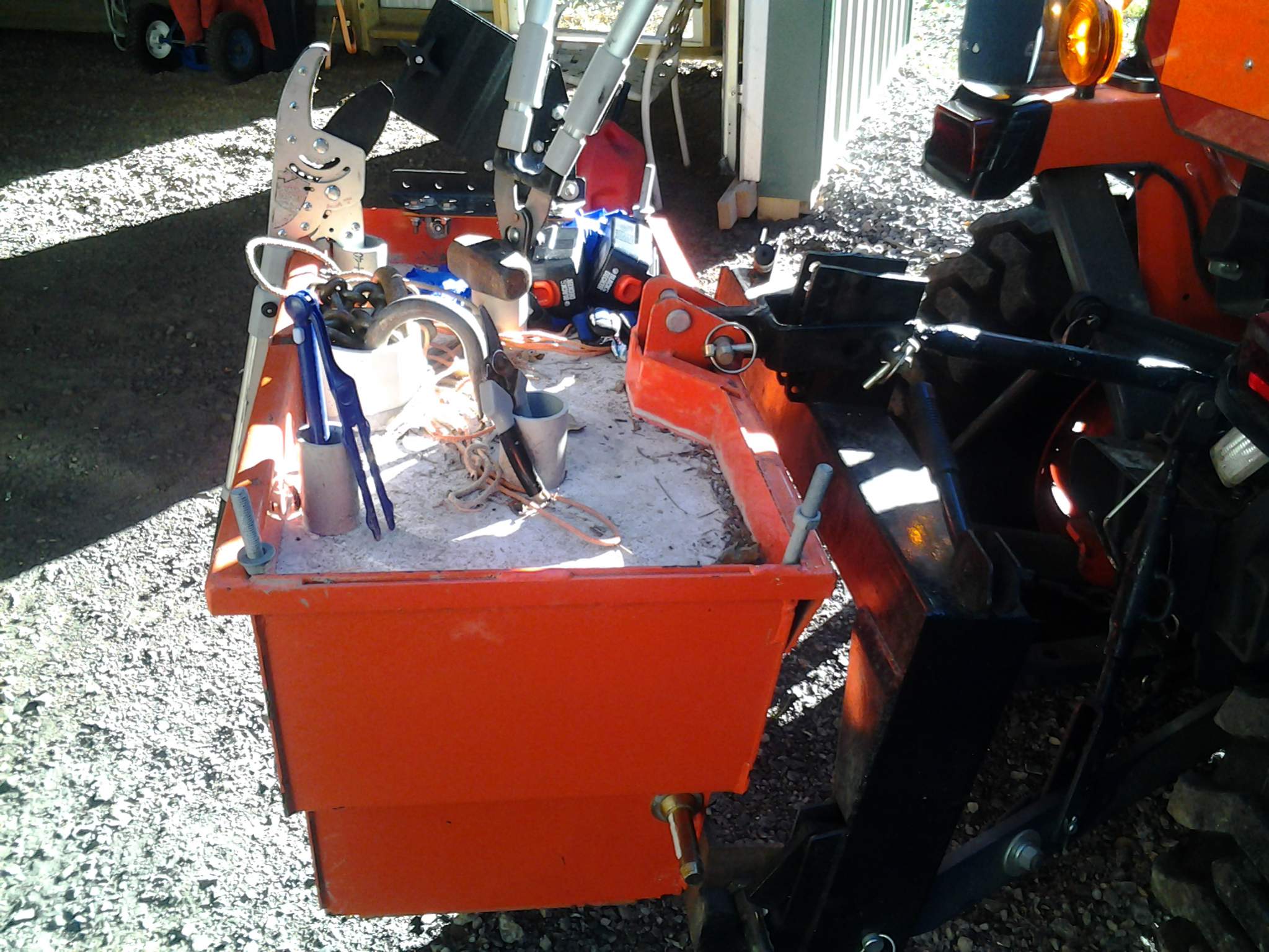

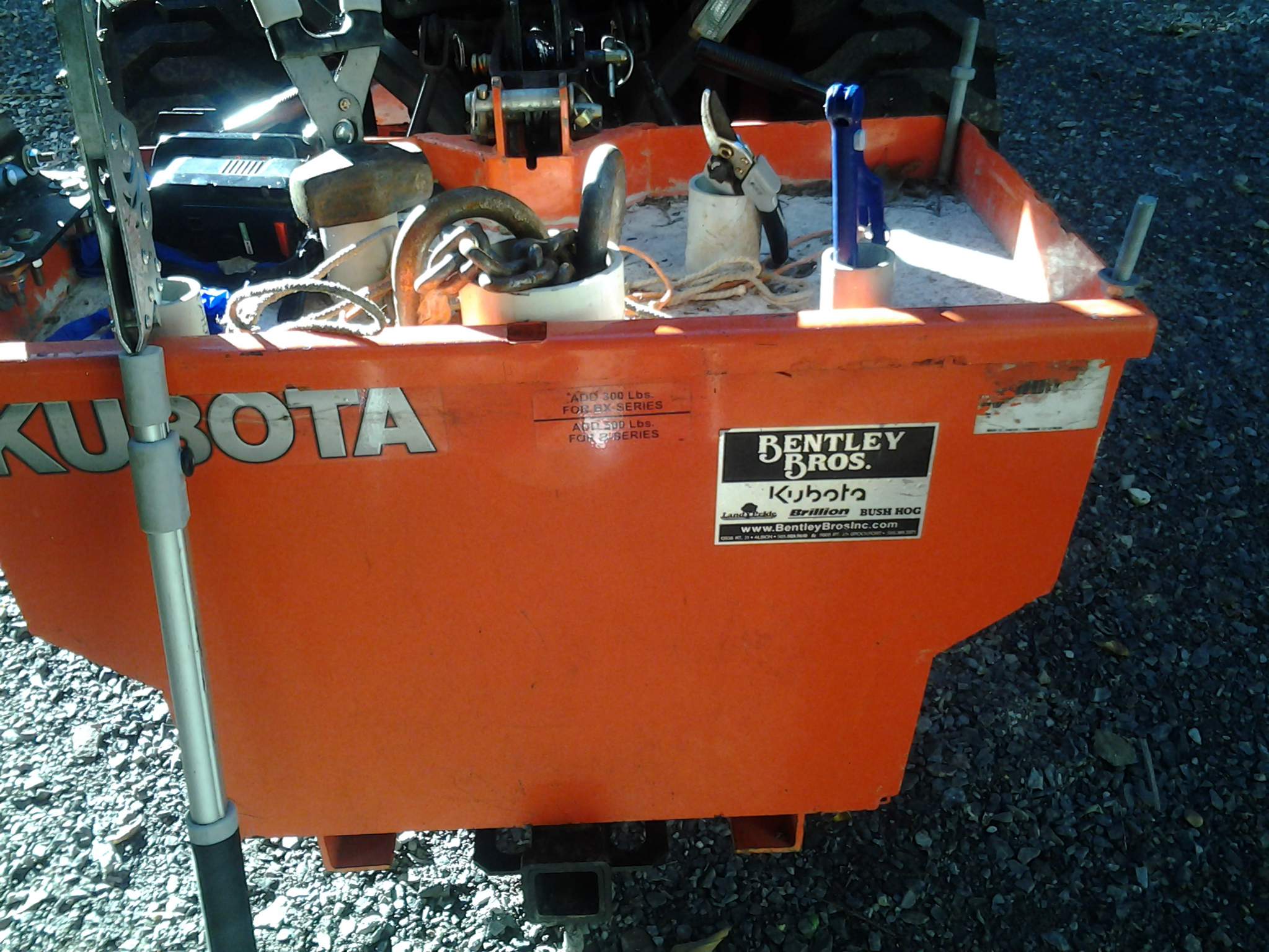

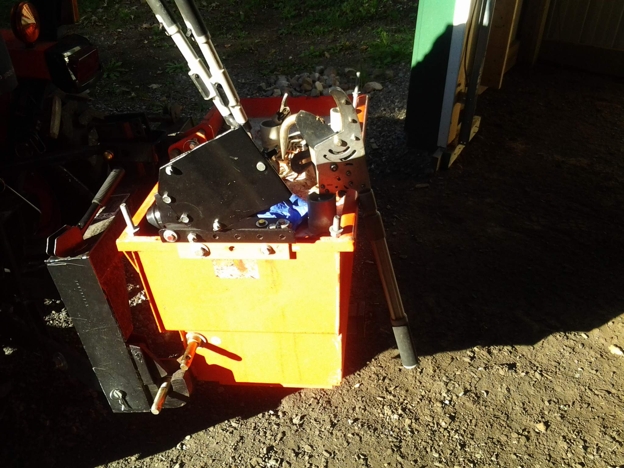

My SWMBO talked our Kubota dealer into throwing in a ballast box AFTER we finished signing the deal- so I did this- saved used brake disks from all our vehicles, and stacked them into the box in several piles, then put a piece of PVC pipe through the center of each for long-handled tool storage, and then filled the whole thing the rest of the way with bags of Sack-rete.
We leave it on unless we're using the box blade or rake, and between that and rim-guarded rears, we've never had any rear wheel lifts since.
It also makes a great carry-all for the chain saw, garden tools, and what ever- plus I mounted a bumper hitch from HF on the bottom, so we can tow our little HF utility trailer w/o removing the ballast.
We also have a HF QH, so I had to make new 3-pt mounts for it.
Between the 275# of brake disks [one stack around each of those pipes, and I don't know how many bags of concrete, we figure it's well over what that little sticker recommended, but it works for us.
