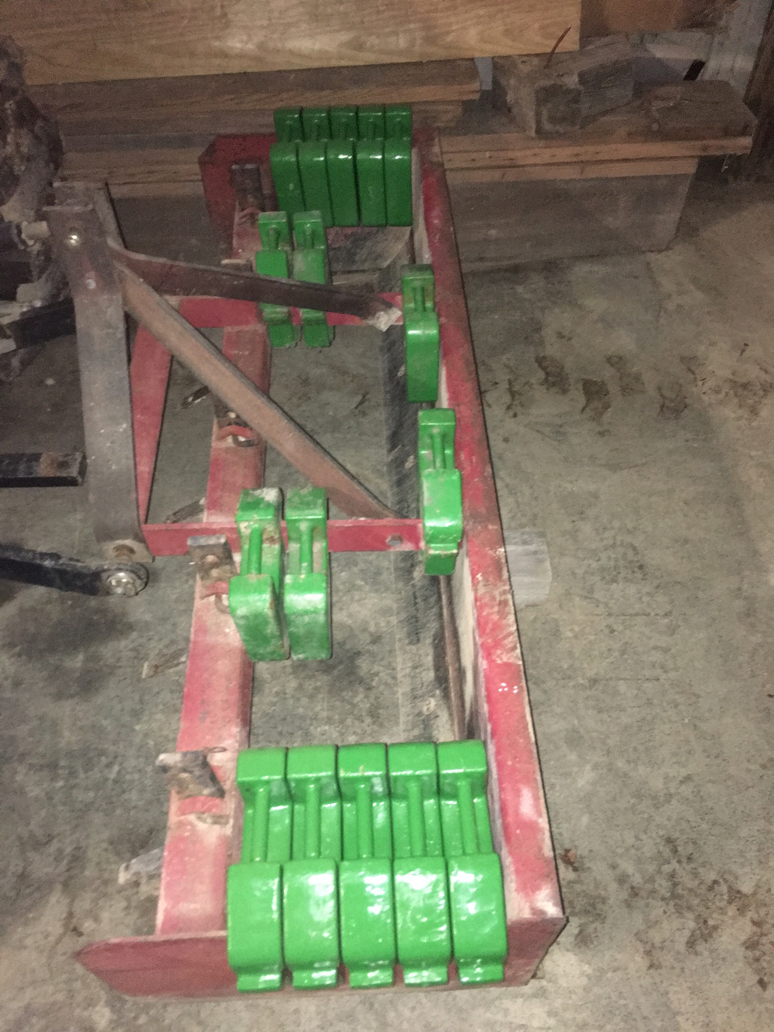

I just want to get the rear wheels a bit more planted. I notice that with the work I’m doing lately, I’m getting a lot of wheel spin and therefore a loss of traction. I don’t load up the FEL to the point where the back gets light, but I’m hoping that 500-odd pounds hanging nice and low behind me might keep me a bit more planted and keep my centre of gravity a bit lower on a slope.

I prefer adjustable ballast weight because it becomes easy to find the sweet spot in regards to how much you need.
Yeah...I’m thinking about a half-barrel of cement, with a bunch of rocks/iron that I can take off/on as needs be.
Easily adjustable rear ballast.

The fel is on my 4410. I have a quick attach and the bracket I made holds the center of the weights approximately a foot behind the bottom hook on the quick attach.

It'll take around a thousand pounds to keep the rear end on the ground with a larger compact tractor. Any amount of weight between zero and that point adds weight to the front axel under a max lift. Once you reach that point your either going to need literally tons or a boom pole to take a meaningful amount off the front axel. Your working the short side of the lever here. Anyone who can't understand this needs to retake 5th grade physics. This is another TBN created myth that holds no water.

Yes and no. On paper, rear ballast will reduce front axle load. However, it will also allow you to load the front axle even heavier, if you can still pick up the rear tires. In practice, rear ballast should be used for tractor stability, not to protect the front axle.
The operator has much more impact on front axle longevity than the ballast does.
