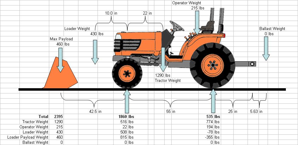

I've actually e-mailed New Holland because I'd like to know about where the CG of my tractor is, both vertically and axially (i.e. % of wheelbase). I don't have access to scales and have some really steep ground to work on. I figure if I have the information for the tractor, I can get a better idea of how to ballast.
& Thanks, hazmat, for the link to the old thread. Someone remarked that the math is tough, but as I'm sure you know, it really isn't. I was calculating CG's before I got out of high school, and I'm no Einstein. More important is that you have good information.
I'm trying to think through a rather scary way to figure out how high my CG is from the ground. If I tip the tractor, say in a garage or somewhere safe, until it's just on the verge of tipping (i.e balanced on two wheels), the CG of the tractor is obviously above this point. Now I need the angle the axle makes with the ground, and I'm thinking use a digital camera or something to keep me from having to mess around under the machine. To be complete, of course, I'd need to tip it both left and right (just in case it's a little off center as well).
Tangential to the thread (my apologies), but I cant figure out how much I'm lowering my CG without knowing where it is in the first place.
   / Ballasts / Rear weight information #12
If anyone out there has a set of scales and has the ability to measure the weight of one axle at a time, and one side at a time, you can find the horizontal (sideways, and lengthways) position of the cg. In order to find the vertial position, you have to have the ability to lift one axle at least 24 inches, and set it back down on the scale. The idea is knowing the level weight of both axles, the level and raised wheel base, and recording how much weight is transfered when you raise one end 24 inches, and plugging it into the formulas. If anyone is set up to measure this, let me know and i'll give more details.
