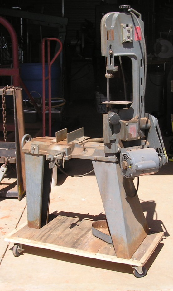

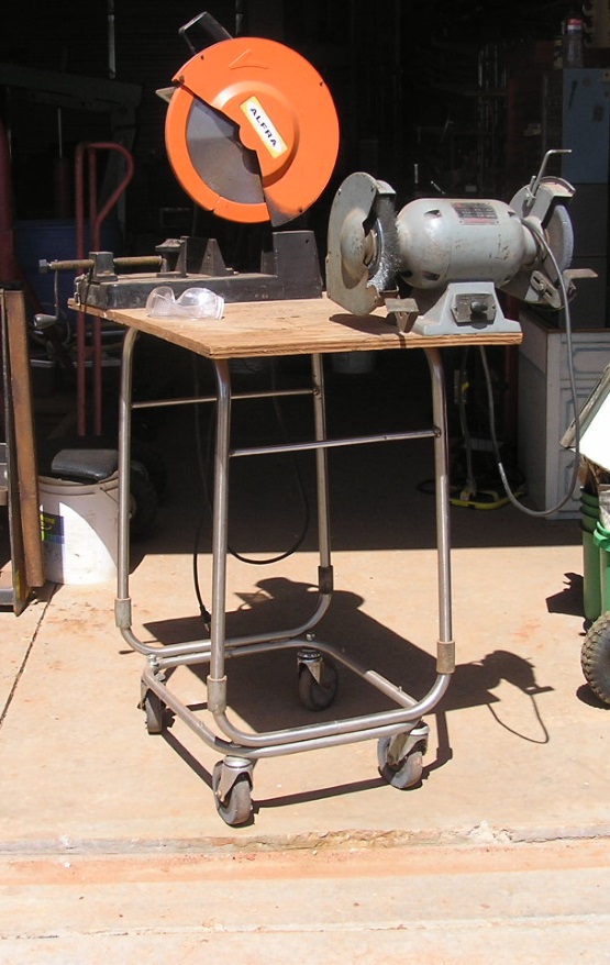

I have an Alfra dry cut that I bought at a local welding supply store and an old Dayton H/V Bandsaw at an auction many years ago.
Would not want to give up either one.
