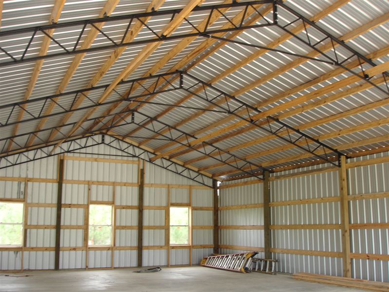

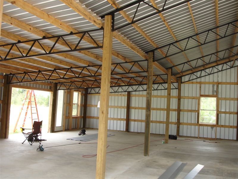

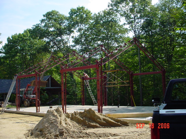

I am interviewing contractors to build a barn approximately 32x48. Please look at the photos and share feedback to let me know if the construction looks acceptable.
thank you in advance to the construction gurus.

   / Barn Construction ok? #3
I'd say I love to have that barn on my place.
Is that what you're looking at or are you just soliciting opinions on that type construction?
If you're concerned about the contractor doing a good job, most engineered systems like that have a manual for installation. You might find it on the web or just ask the wholeseller for the manual. Then you can "QC" the instalation.
That's a fine looking clearspan building.
   / Barn Construction ok? #4
My question is about you.
The reason I ask is we need to know what you want out of your barn. What are your plans for it's future? If it's just a shed to hold your equipment out of the weather, similar to a farmer's then that barn is more than fine in my book.
On the other hand if your barn is going to be working shop and you're wanting to insulate for twelve months a year use then I'd have my reservations. Not because of the quality of the work, that appears fine, but the framing is going to make it more difficult, aka, expensive.
You save on the original installation and then your pay more down the road to finish it out.
So give us more information. It helps to judge apples to apples.
   / Barn Construction ok? #5
My first thought is that it may not hold up to a significant snow load... then I saw you are in Florida. No problem I guess, do they rate it for wind load (hurricane)?

   / Barn Construction ok? #7
I'd accept that type of construction in a New York minute. Basically it's a pole barn with engineered steel rafters. Overall the construction in those pictures looks well done.
Just my two cents.

   / Barn Construction ok? #8
The overall construction looks very well done. I would call it acceptable. Looks as if you are going to have a very nice structure. Enjoy it.:)
   / Barn Construction ok? #9
Looks very interesting to me. However, without a cost estimate it is hard to know if this is a good deal or not.
I like the clear span and steel trusses. Is this a photo of another job they did? I can't tell for sure from the photo, but are the 6x6 supports set into the concrete or are they on Simpson brackets?
I'm looking at doing something similar next spring and would be most interested in what they want for the complete package.
   / Barn Construction ok? #10
I live in Duval county/jacksonville,florida and I have one question that has been asked. Will it meet Florida hurricane code now.
Looks light construction to me
