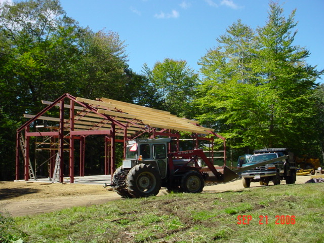

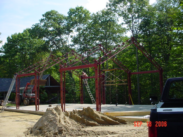

It looks like light construction type to me. I just helped a guy put this up in MA. It is much heavier than yours. We do have snow load up here to contend with. I see what you are talking about in your first photo. The rear two uprights on the back wall that are mickey moused in my opinion. This building is 30x60

Here's the link the builder sent me. Miracle Steel Structures
I can say that this building we put up is there for the long haul. The studs in the cement foundation are 3/4" in diameter and 14" long with a foot buried in concrete. All the uprights have 4 studs on each beam. All the bracing and roof trusses are 3/4 diameter bolts. I helped him install the main frame, some of the roof boards and the ends. I'll stop over at the barn and get some more pictures this week for you to see. The whole outside frame is done now. I only work with him when he needs an extra set of hands for the heavy parts. It was an interesting experience building this barn. I think he told me the building itself was $32,000. That did not include the wood, foundation, doors or windows. I'll get more info asap for you.

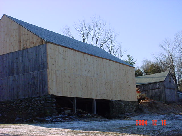

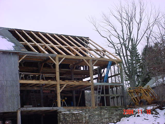

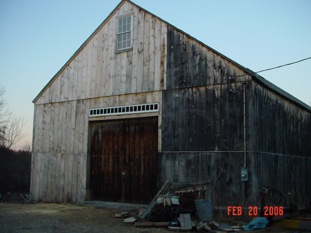

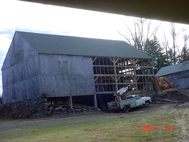

Hayden, You ask what are the difference between a steel building and a traditional wooden barn. That all depends on what type of construction and size of the beams you use in the wooden structure. This barn here was built in 1840. I have rebuilt it, jacked it up 9 inches in the center and pulled it over in the middle by 13 inches. It is built with 8x8's and is post and beam construction. It has sustained quite a few hurricanes in its lifetime and many a blizzard. Right now I think it will last another 100 years at least if my daughter keeps a good roof on it.

This 30x60 building was $27,500 and came with the engineered plans to make the building inspector happy.
