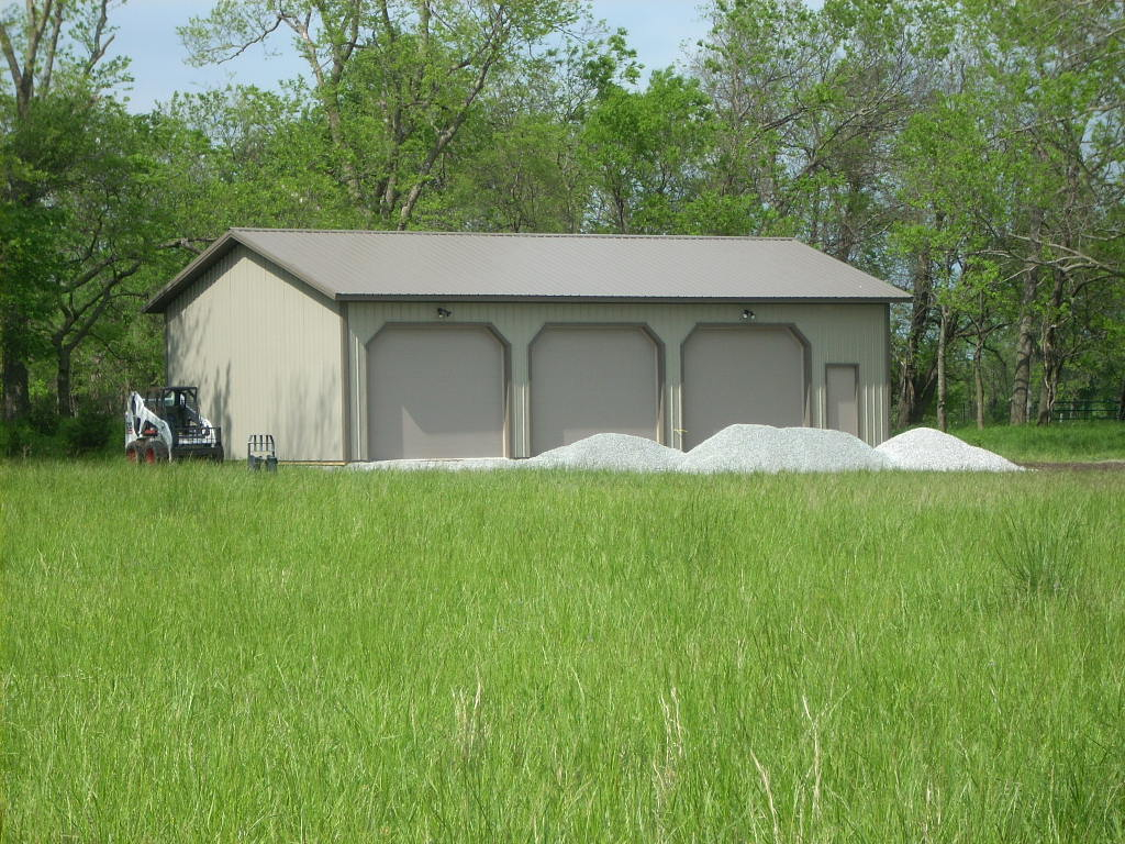

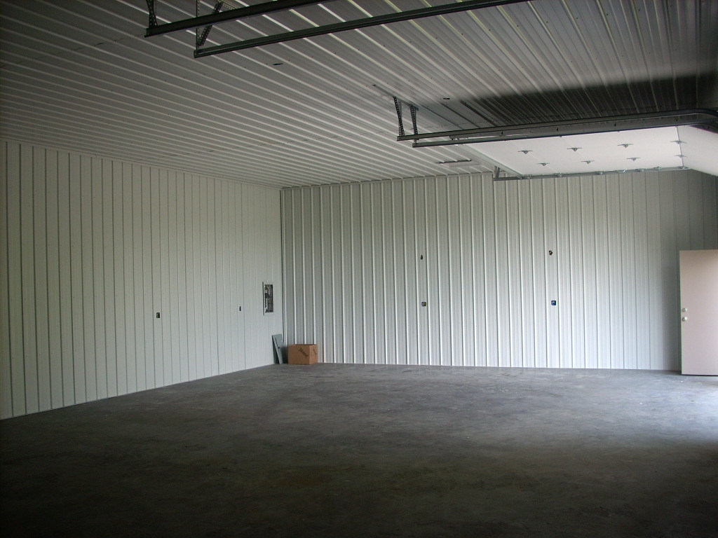

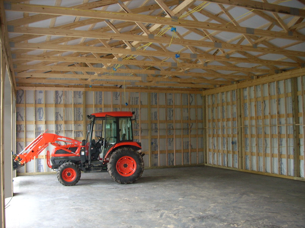

I went with a pole barn. 30x50x12 with 10' doors. Finished interior and fully insulated. $30k
