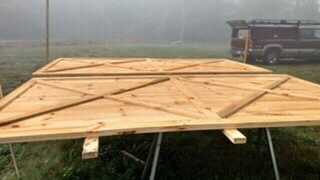

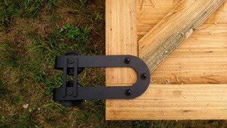

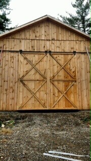

   / Barn door #19
I built these doors for my barn a few years back. Nothing special and dint cost too much. The opening is 10w x 12h.
