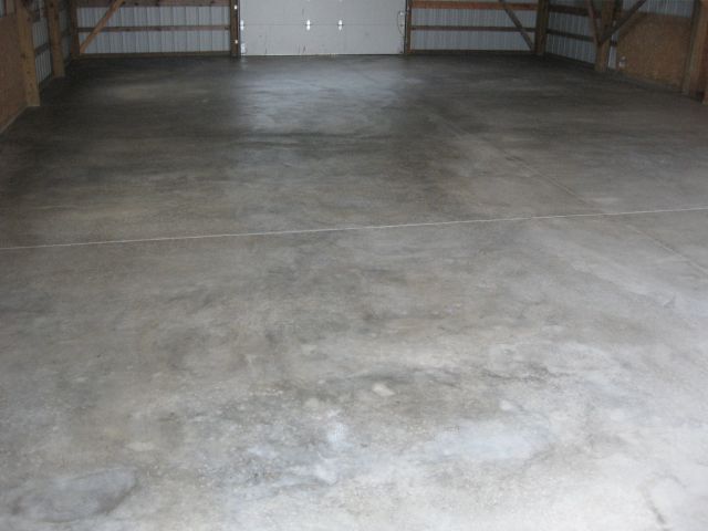

What kind of sealer are you going to use? My 30X40X12 floor is about two months old and I want to seal it.
Vocomp-20 it's a Curer / sealer. Got it at the local brick / concrete supply company. It can go on immediate after the water has evaporated and you can walk on the concrete. HD also sells a concrete sealer, and a curer/sealer.

applied 2 coats of the curer/sealer. It said it would cover up to 300sf per gallon, so I bought a 5 gal bucket and an extra 1 gal jug. It only took about 2.5 gal for the 2 coats, but it's all I'm doing. I still need to fill the control joints with a caulk.

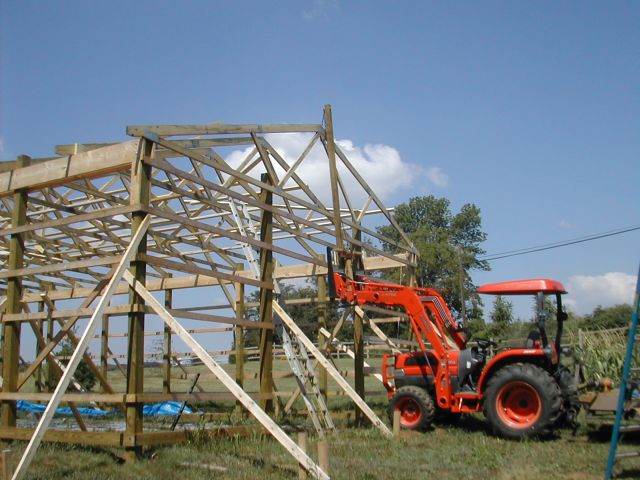

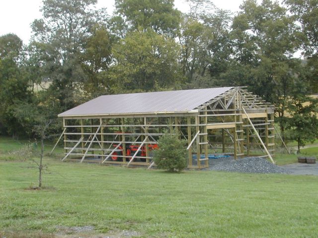

Added a couple other pictures from construction, one is using the tractor to set the roof trusses, and one putting on the roof metal.
