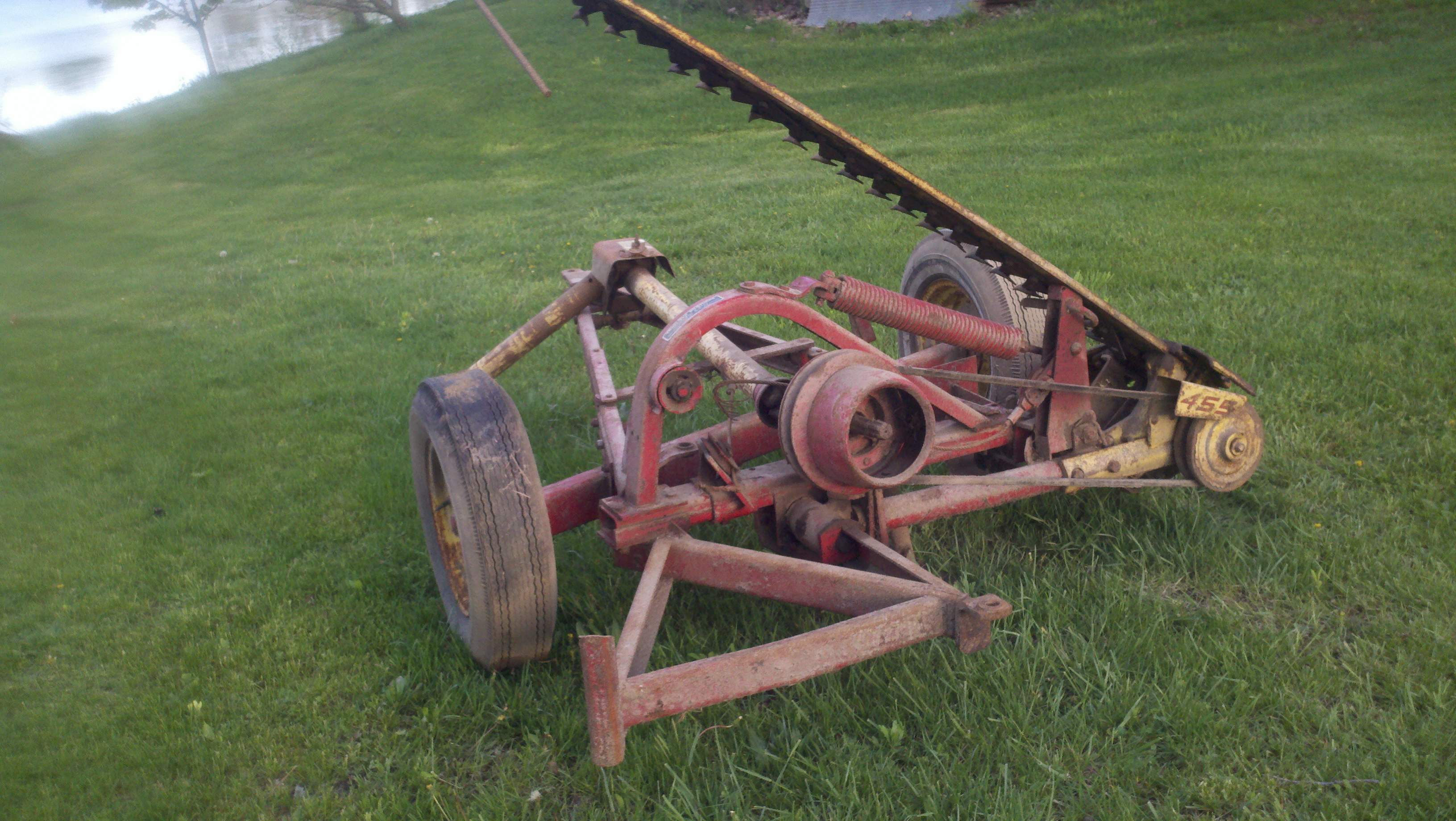

Here is a photo of my drawbar. I went to the New Holland dealer and their information did not even show this setup but I went to tractor house and looked at photos of 1710s and all the photos that showed it had this setup. now I am really confused. 2012-01-11_20-29-37_601.jpg

Did some cutting today - it cut very well!
I disassembled the complete sickle bar - it was missing a few guards and things. I took all the sections off of the bar and found the bar was bent in both directions at about three different spots and had been broken and welded once and not very well. I found a new international sickle bar that fit. The head of the sickle is in pretty good shape just bent a little. So I straightened it and put on the new sickel bar with all new sections.
The guards were all rusted so i used a rotary wire brush to clean them up - they looked to be in pretty good shape. Even the ledger plates look OK. I was missing some hold downs and wear plates but I found a source. I finally got it all together today - well at least mostly I am missing two holdowns. I had to try it and it cut very well.
Tomorrow I will start adjusting it because my tractor is so low. I purchased a drawbar for the 3 pt but the back of this mower is very heavy and without a down pressure 3 pt I could not get the hitch to stay down so I chained the 3 pt arms to the drawbar. The sickle is tipped down too much and the back of the mower is too high which keeps the base shoe from riding on the ground. That is why I ran it - to see what else I have to change.

I would have a longer drawbar made at a machine shop. Take your drawbar to them and tell them how much longer you need it to be.
   / Barn Find - Sickle Bar Mower #28
If you want to just fox the cutter side, I would get a 1' piece of 3/4"x2" bar stock. Punch a hole in the end, one in ~3" to go through the current pin, weld on a crosspiece to catch both sides of the the A frame and bold the crossbar to the A frame.

I am seriously considering having the longer drawbar made. What I have now is not real stable and is a pain to get everything set up right.
The problem with raising the drawbar is that the PTO is very close vertically to the drawbar so i do not have much real estate. I have to see how much adjustment in tilt the mower has - I think it is going to be a balancing act.
   / Barn Find - Sickle Bar Mower #30
Creamers,
Can you design the new drawbar to drop a few inches, either by bending or welding a spacer block on the lower side with extension welded to spacer?

Today I did some real mowing of grass for hay and it cut like I remember old sickle bars doing - so much better than bush hogging! Quicker too! Everything just lays so nice and smooth.
Last week I mowed around the edge of my pond even letting the end go right in the water - it worked great!
