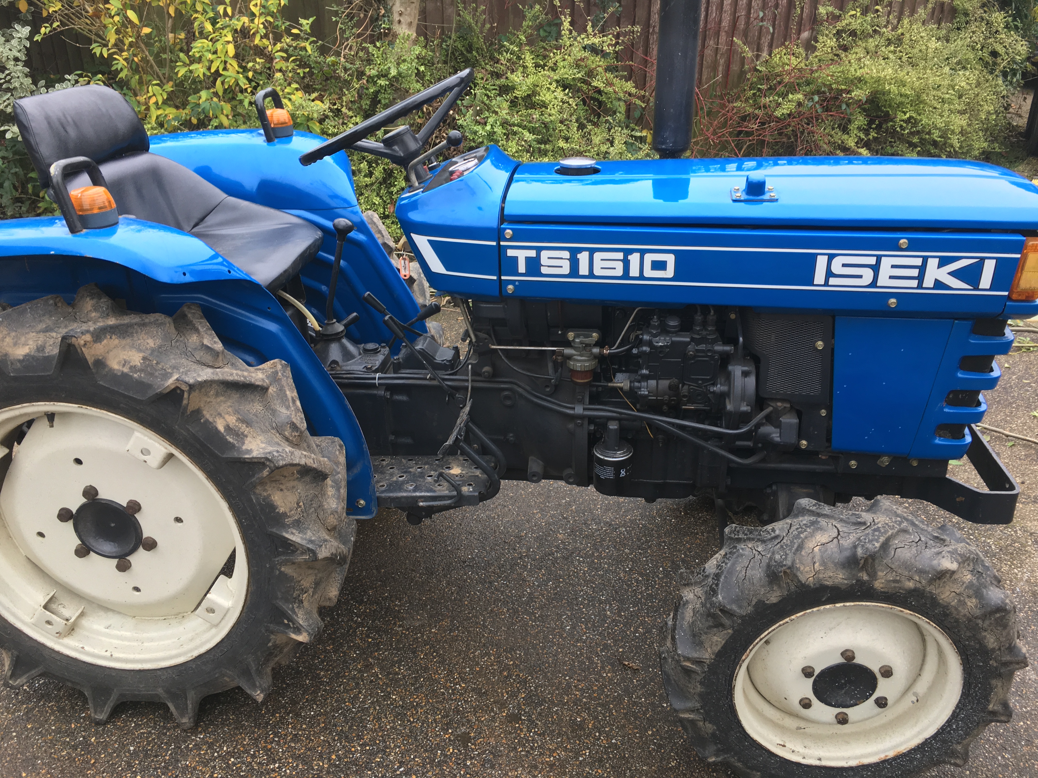

Hi guys, first time poster,
ive acquired a 1610 thats been hardly used and stored in a barn on a small holding.. its a very very clean machine, i will get some pictures later today ..
it looks to be in great condition, bar badly perished front tyres, ..
its starts ok, but lazy, im guessing it needs new glow plugs and it chugs for 10 seconds or o before catching.. once warm it fires back up fine..
ive no operators manual just the parts manual ive forum on iseki website..

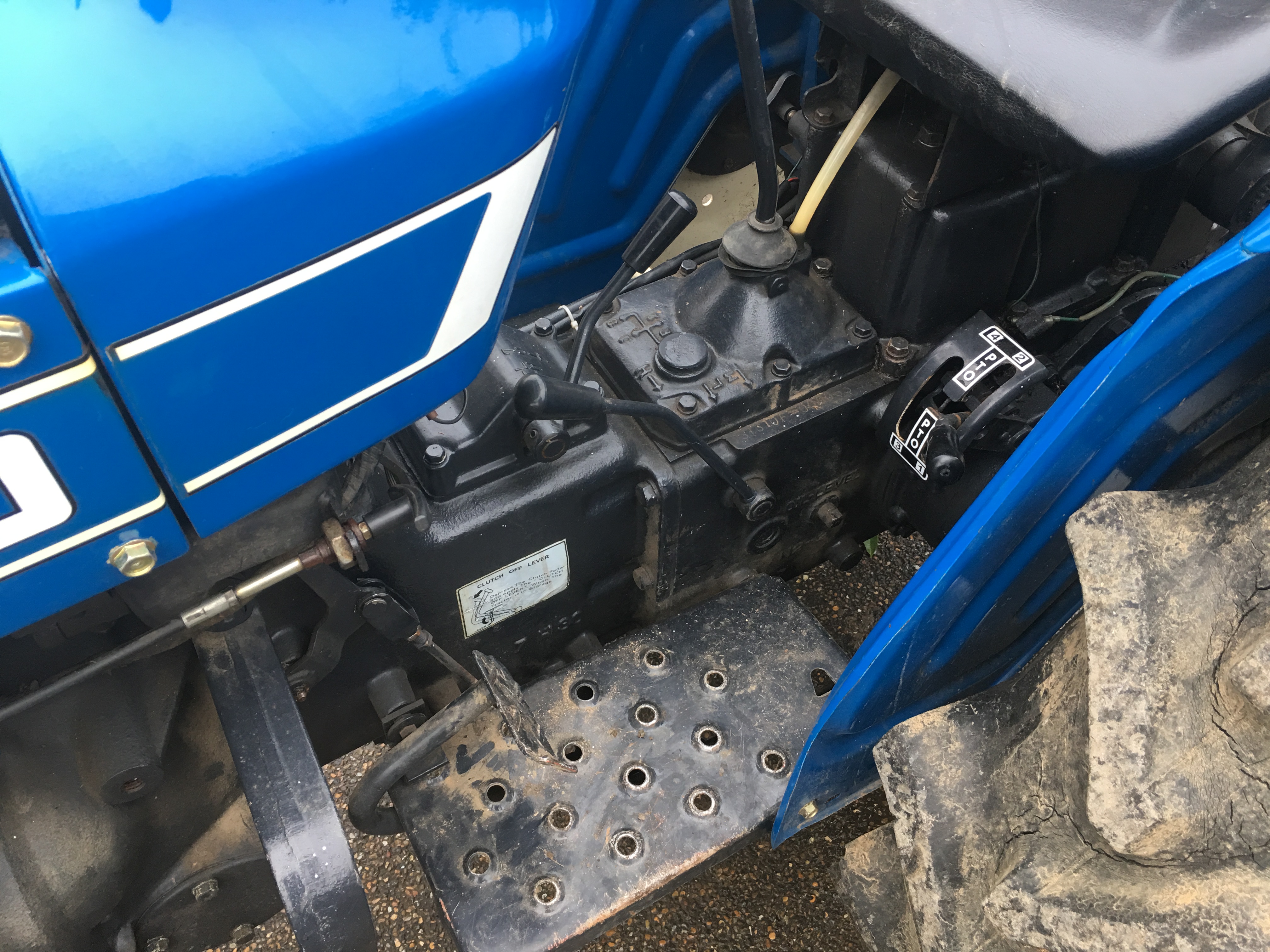

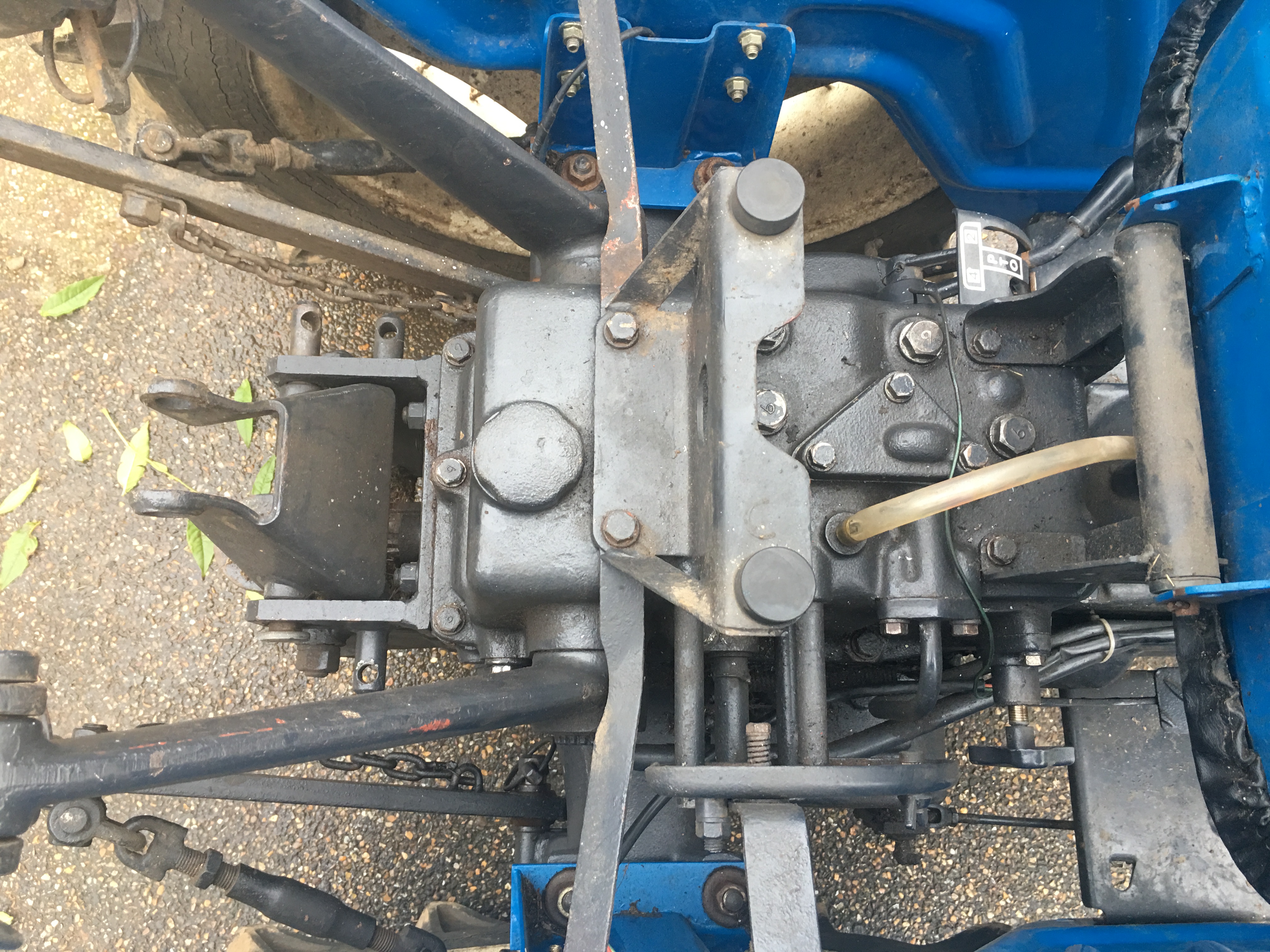

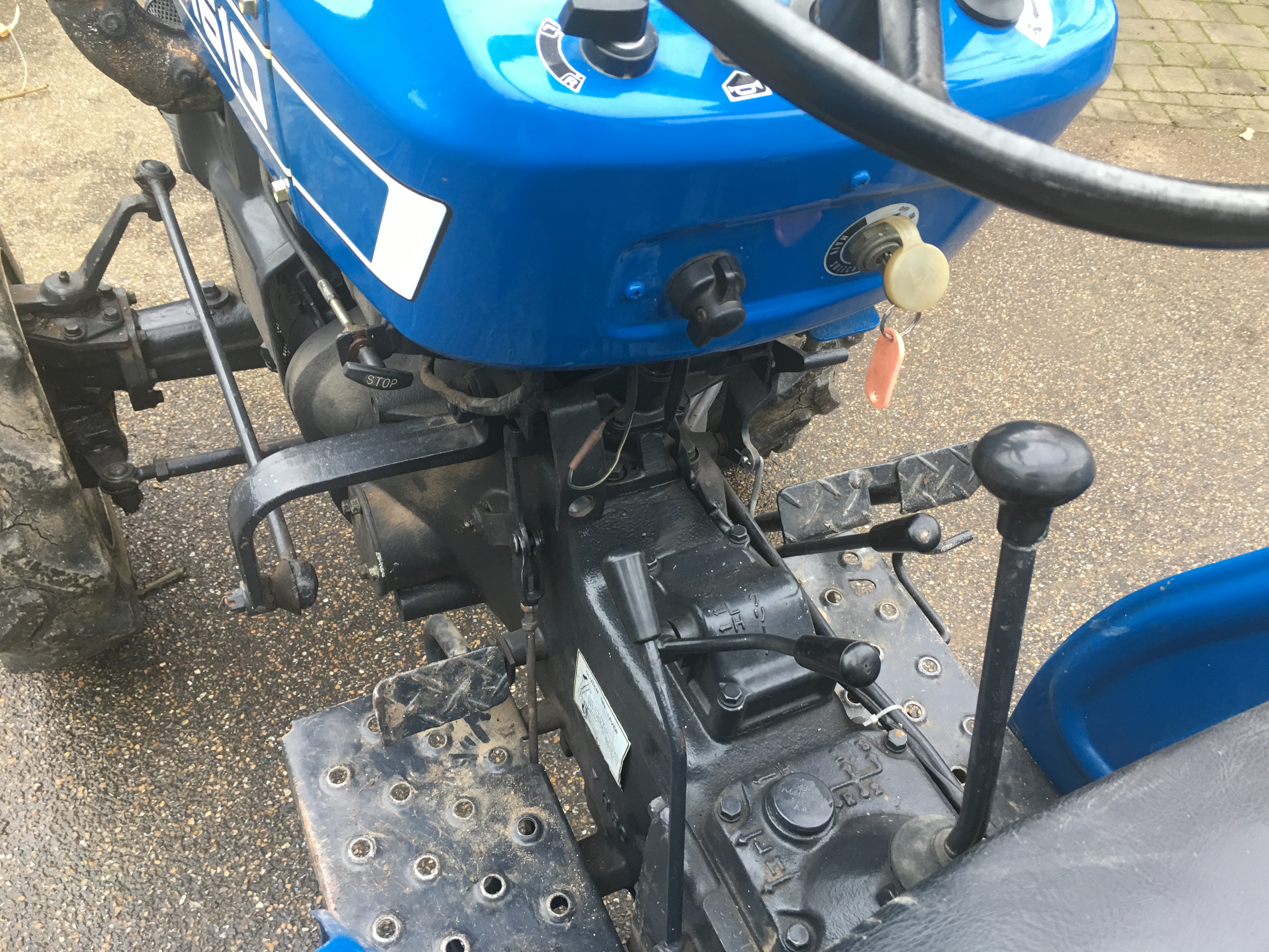

pto works spins ok, but i cannot lower or raise the rear control arms, there is a lever on the rhs of the seat which i guess should lower and raise the rear arms depending on where it is positioned but i get no movement what so ever.. there is also a knob that turns in and out iust in front of the arms which i guess is something to do with the hydraulics.. ive tried it wound in or wound out.. but still no operation at all..
what do the cleaver people on here advise could be the problem?
also if i keep teh little tractor i would like to if possible add a hydraulic take off if thats possible to raise and lower a small tipping trailer..

so basically if engine is running and the screw in screw out hand valve is out/open the lever beside the seat shoul raise and lower the botom rear links. if that the case then somethings defo up..

Nice looking little tractor, hope you can get every thing on it figured out.
It is possible that your lift arms are stuck in the lifted position.
I don't know anything about the Iseki tractors.
That said I would make sure than any control knob are screwed out to at least the halfway position,
place the lever on the right side most of the way forward (down) then carefully put some weight on the lift arms and see if you can get them to drop.
Many times lift arms will get stuck in raised position.
I don't know were you are located but I'd say one of the first things to do would be to find an operators manual for your tractor.
It may answer many of your questions.

will try that, L ouny, thanks, i will drop the hydraulic fluid and filter, it may be blocked.. ive found a manual online, but the sites require credit cards to read which looks a little odd, not sure i trust the sites, will see if theres an actual one to buy
