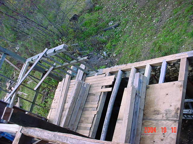

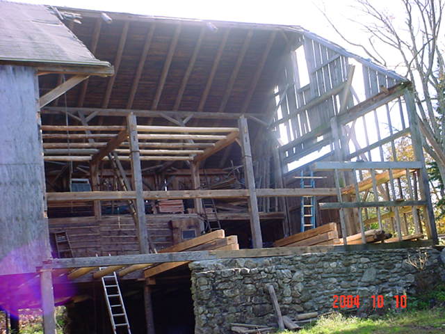

This week we got to put in quite a few new beams using a Lull as a lift. The first floor is done except for the flooring that I am waiting for. Tomorrow the outside beams will be put in place. I can't wait till this project is finished so I can keep my Cub in there. All the new (33 of them) floor joists were made from ash off our property and slabbed with a chain saw and planed by me. The 12 new roof rafters will also be chain sawed and planed by me. I have 6 done and 6 more to go. I only wish they were shorter in length. More picture to follow as we progress with this project.

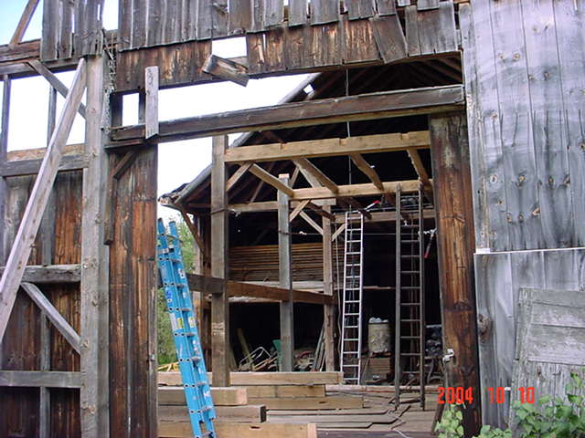

A view from the 3rd floor.

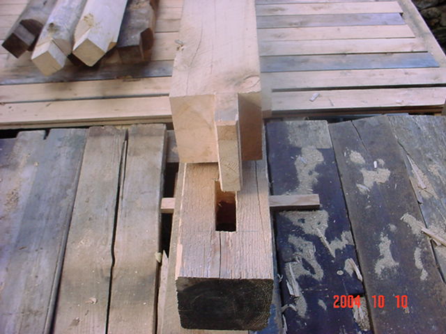

The timbers (8"x8"'s) are from a saw mill. Some are hemlock and some are oak. I would prefer Chestnut as that is what the originals were. The floor joists are cut by me using my Husky chain saw using a ripping chain. I snap a line on the flattest side and free hand cut the log. I have a 3.5" electric Craftsman plane that I use for finishing it off to be flat.
Here is another shot of a mortise and tenon joint. The square ends of the floor joists in the picture were also cut freehand by me using my chainsaw.

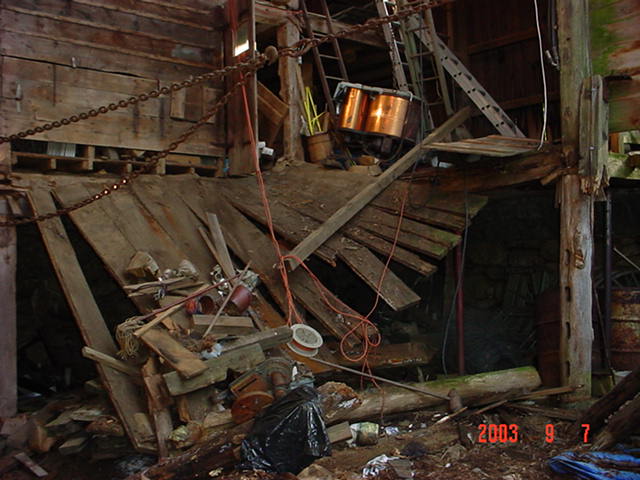

Mike, I cut all the floor joists last fall and stacked them up for this years project. Many of them twisted slightly or stressed cracked causing a slight bow in the flat area and needed to be re-planed. All in all it was worth taking the time to cut, saw and plane these myself. Especially seeing how the trees were free. The ridge beams are 23 foot long pine and had to be bought locally. Here is what I started out with last year.
