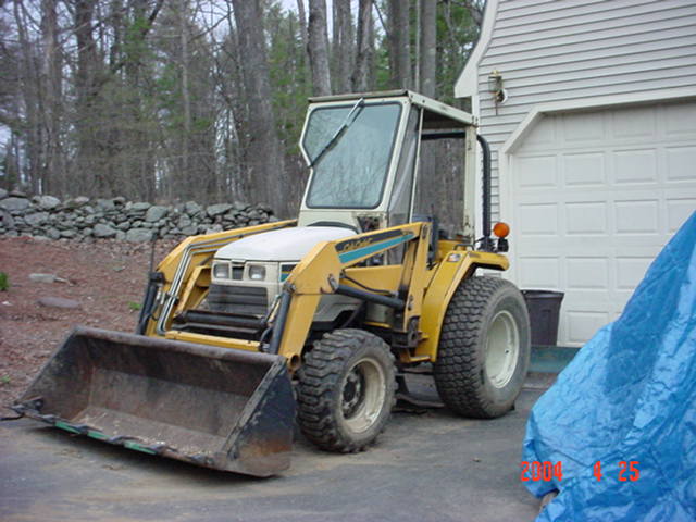

Here's the latest from yestedays labor and a picture of the monster used to lift the beams. It's raining today and I get a day off.

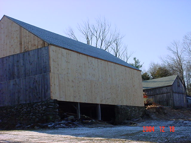

We finally got the roof finished last week. At least the north side is done. I will be doing the south side in the spring. Today we got all the plywood up on the north side and this will keep the barn dry from those nasty northern storms we get. I used slate architectural shingles on the roof. What a difference a new roof makes.

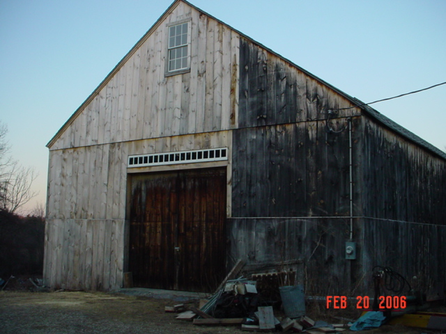

Tuesday was a big day for us. We finished up the north wall siding and put in the 3rd floor new floorbaords. I am presently working on the 12 foot 16 light front window that goes over the barn doors. I was hoping to get it done for the wife for Christmas. But I don't see that happenig right now. If it stays warm I may start on the south side of the barn. Otherwise, it is on to the interior of the house for a complete re-plaster, insulation and re-wire job. Wish me luck. It may be a cold winter outside and I'll be very busy inside. It is a good thing the house will be empty.

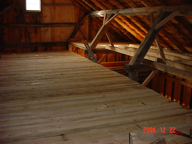

I never did put this photo up. I just got busy and forgot about it. I had this window built for the barn. Then I had to extend it on each end and add a few panes as the guy made it 12" too short. Don't ask, it was easier for me to fix it than to bother with having it done again of fixed. I didn't realize the screwup until I already had the panes in place and caulked. Also included is a picture of the 3rd floor.
