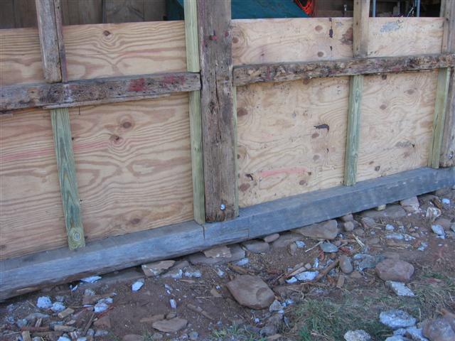

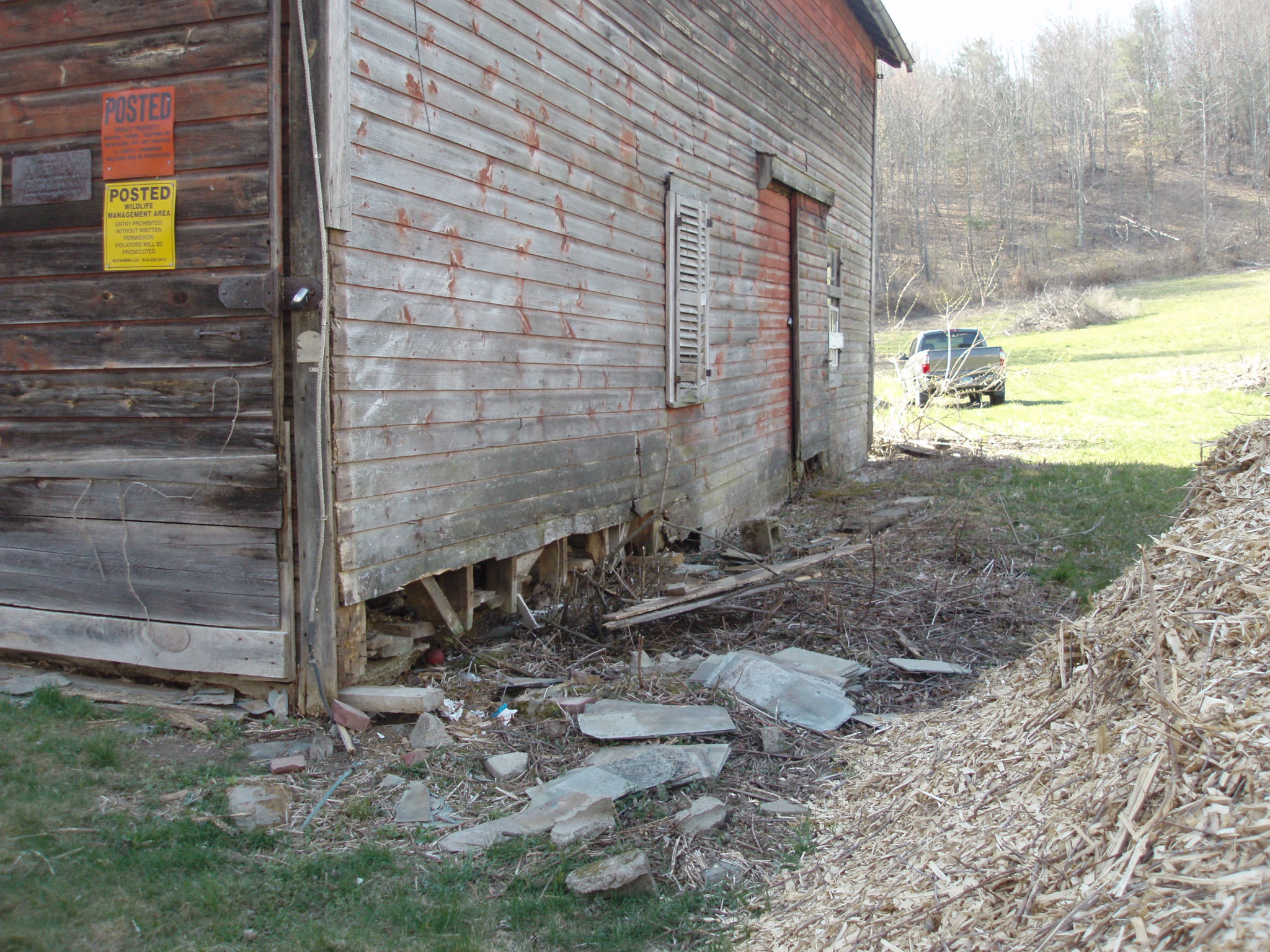

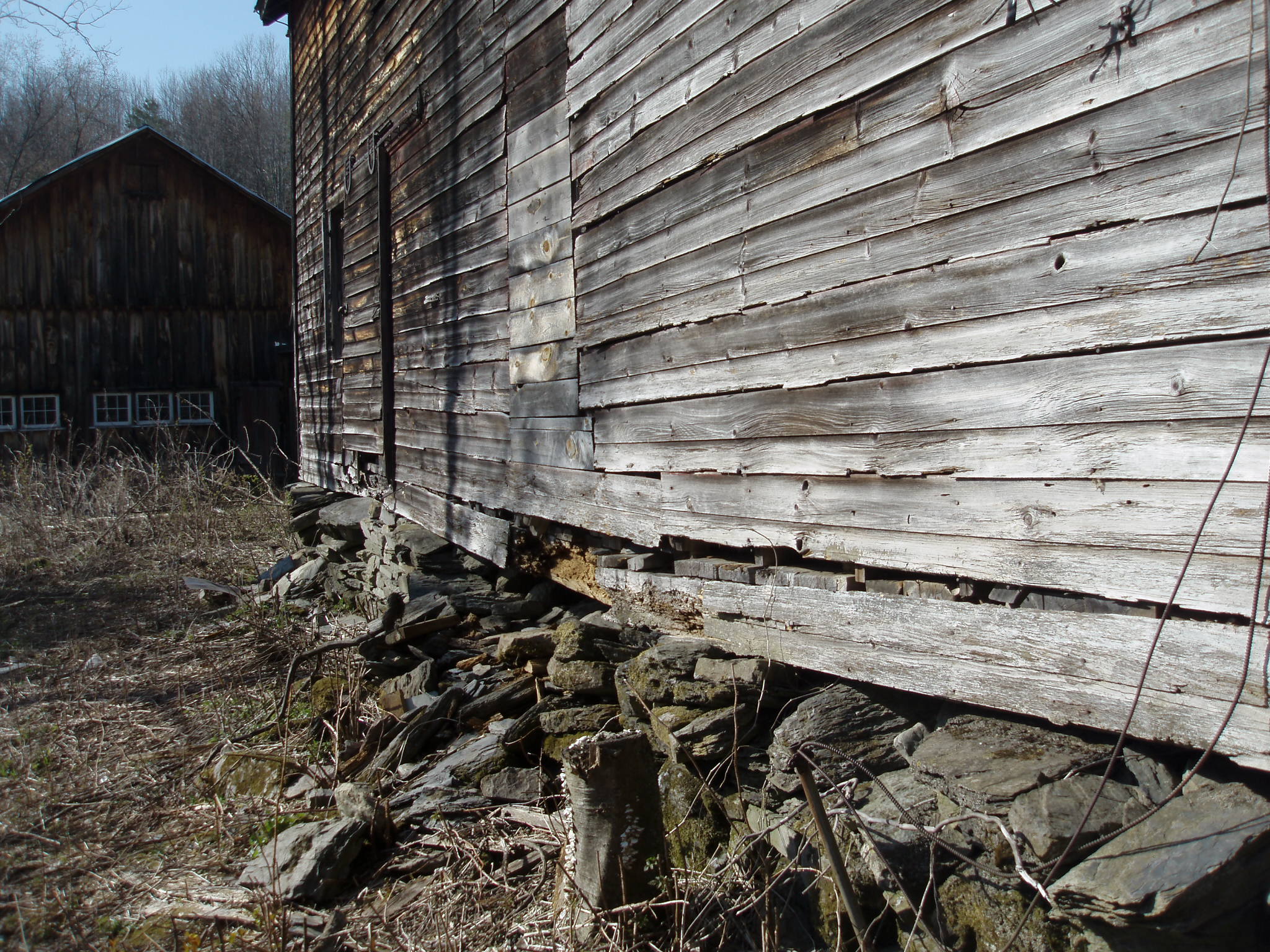

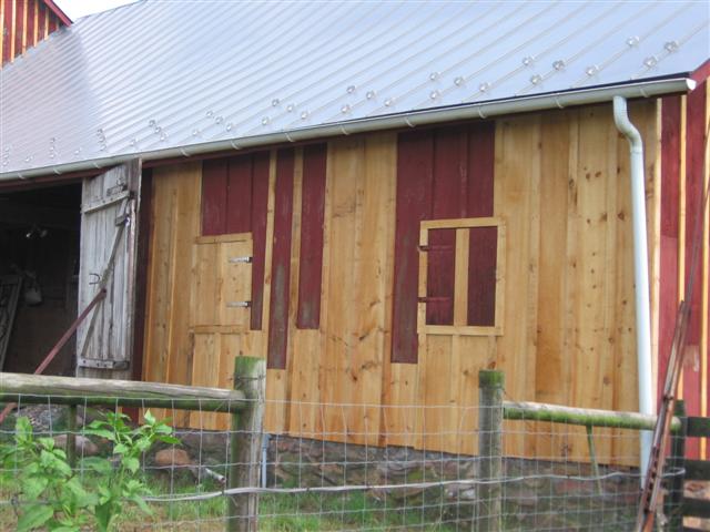

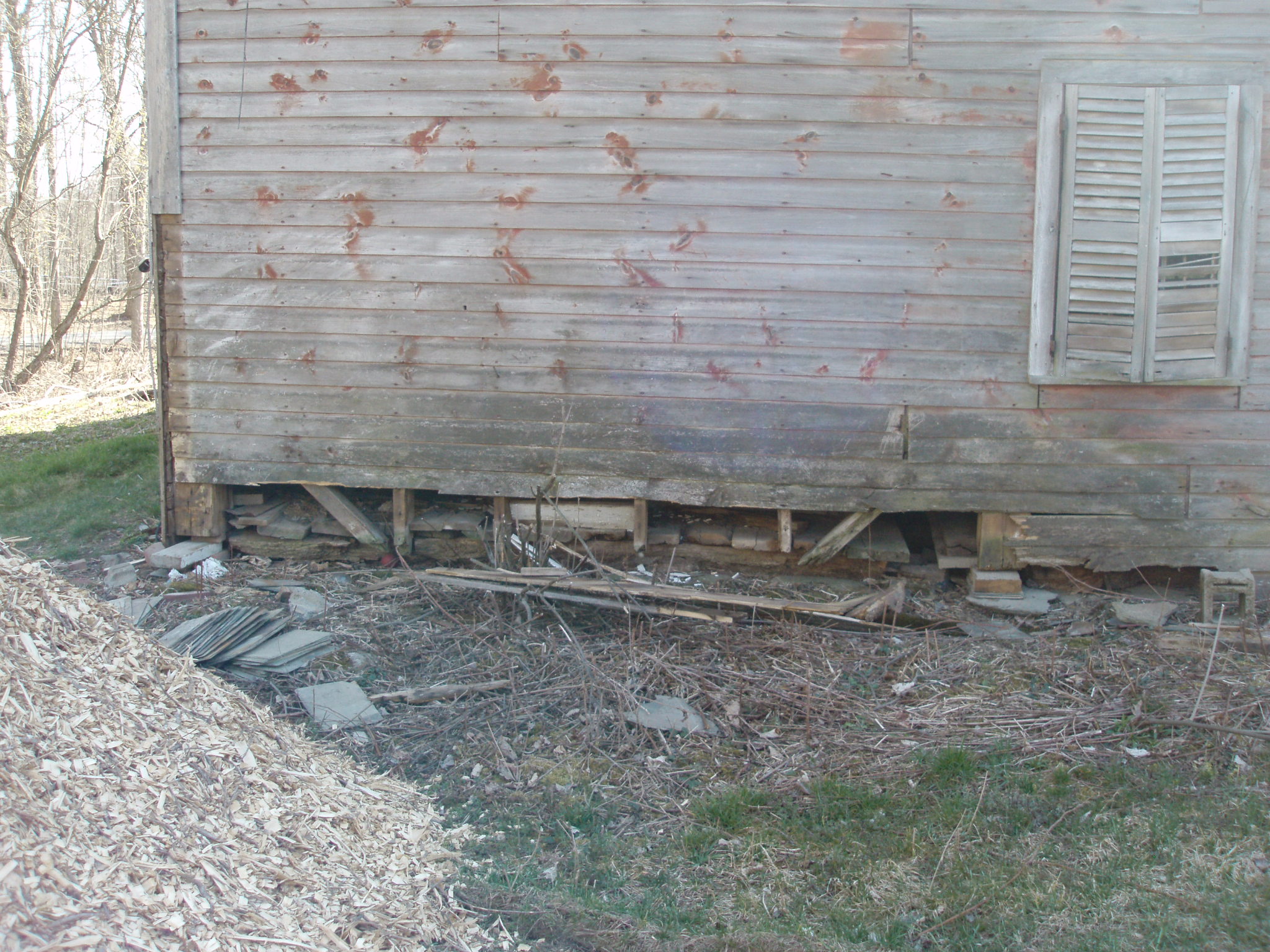

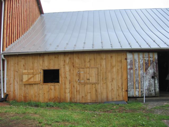

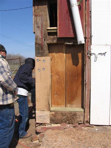

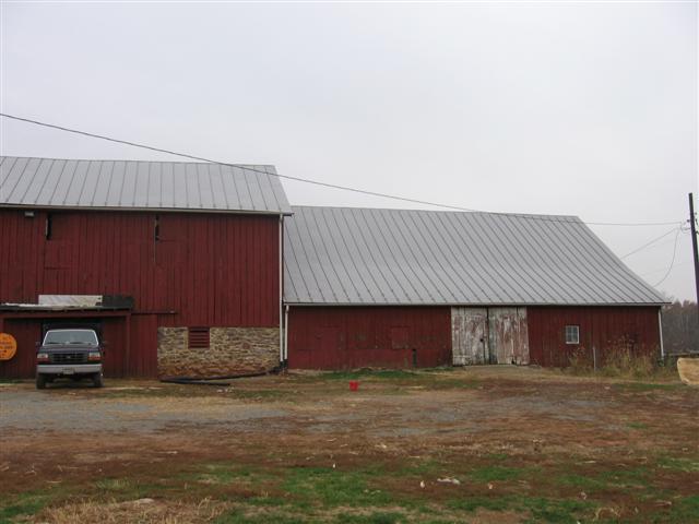

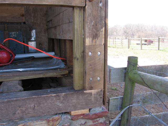

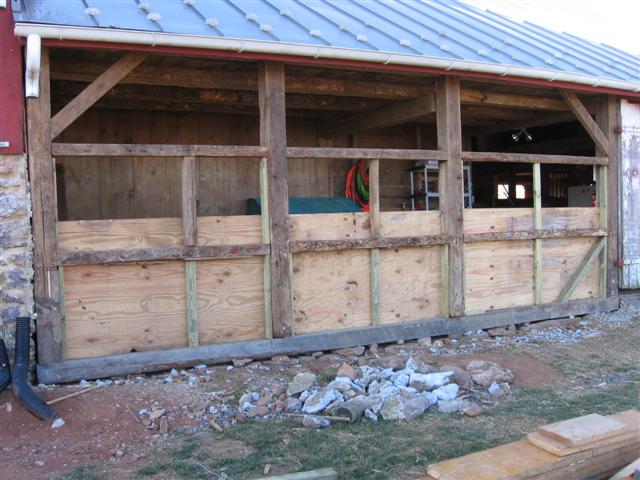

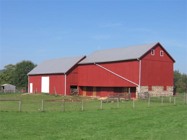

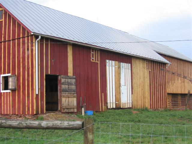

I worked at a farm park that had a big barn built in the 1880's that had rotting sills and a foundation wall that collapsed and posts that were rotting out. We got it all repaired and repainted in 2006 so it should be good for another 100 years.
Sorry I messed up in attaching these in any kind of order. The first picture is the new white oak sill installed. The siding was removed because most of it needed to be replaced also. 2) The barn when everything was completed and painted. 3) New siding put on. 4) Some of the old wide board siding was reused. 5) Battens were replace on much of the barn. 6) another view of the new sill. 7-9) Several of the posts were also rotten at the bottom, these photos show how they spliced in new wood to the old. Long lab screws were used to attached it to the sill.
You have quite a project in front of you. The craftsmanship in these old barn is really worth saving. I marvel at the hand hewn beams in this barn that were perfectly square. The joints they made are amazing. Good luck with your project.

From what I was told White Oak is naturally resistant to rot. I looked it up apparently White Oak has structures in the wood called tyloses in the pores of the wood that prevent moisture from getting into the wood. Since the sill is sitting on the ground or close to it you do not want it to rot away in your lifetime. I have gotten White oak from a local saw mill in our area. They do not have it all of the time and I had to order weeks ahead to get the size cut that I needed.
