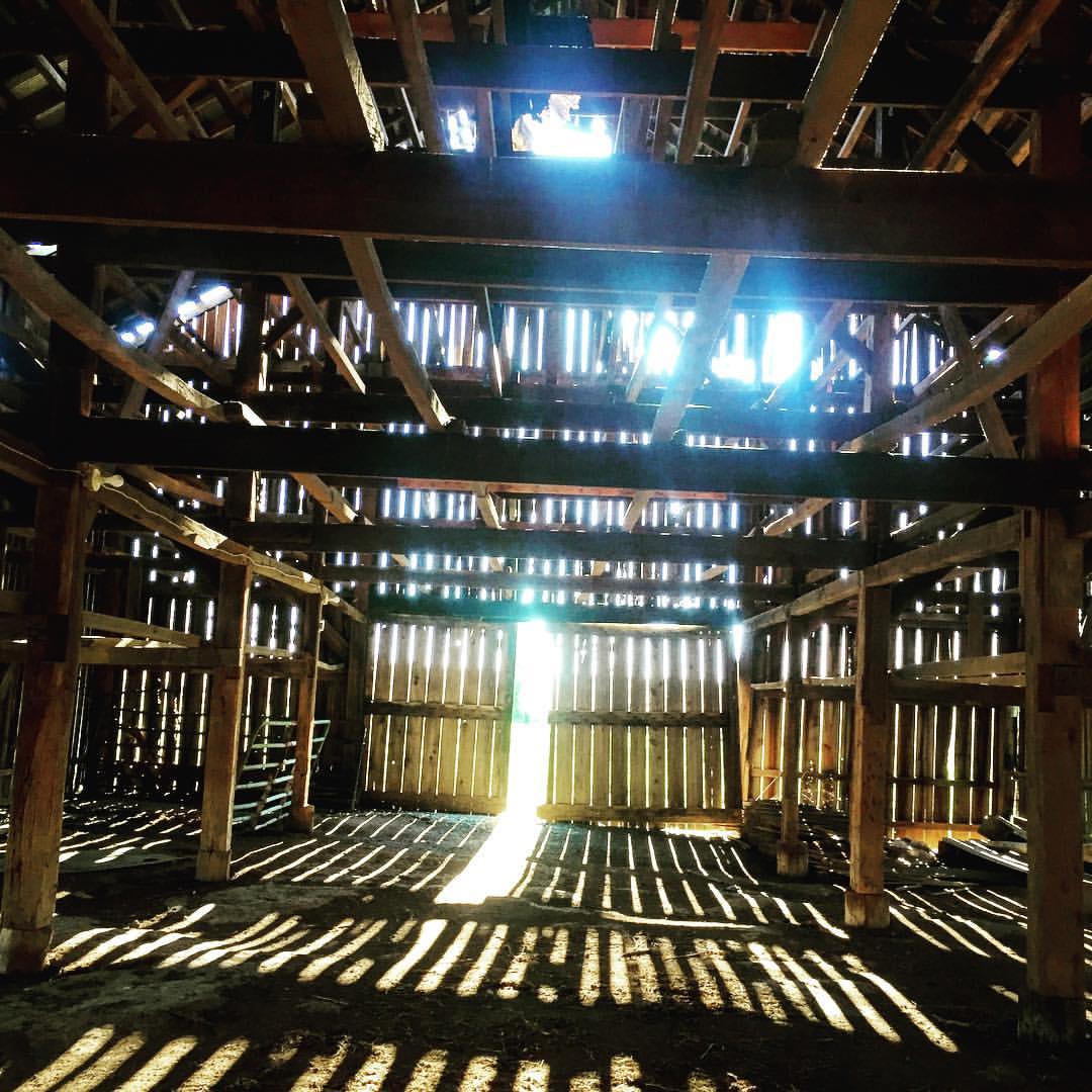

I have the next one for you all lined up. Just let me know when you're ready to start, and I'll be sure to leave the gate open.

Pretty airy that should be fun.

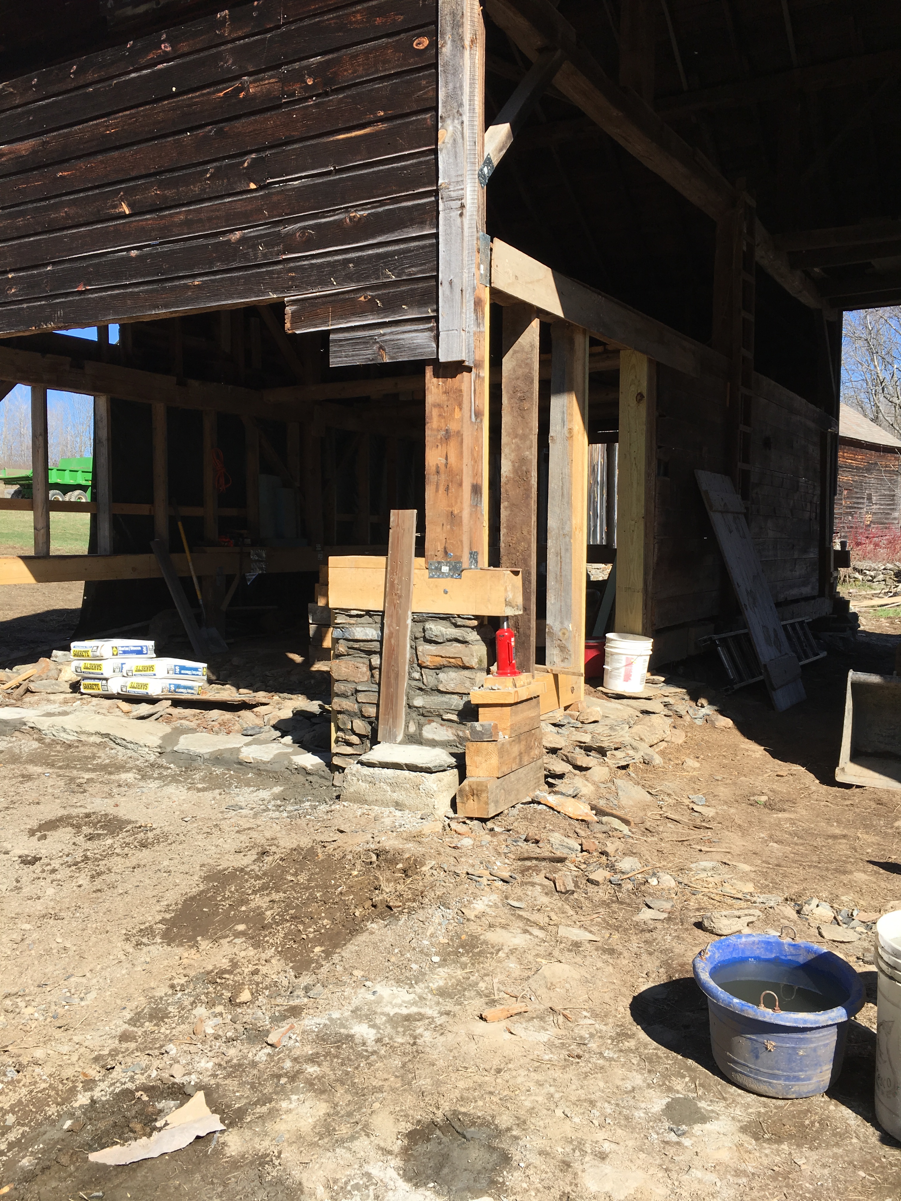

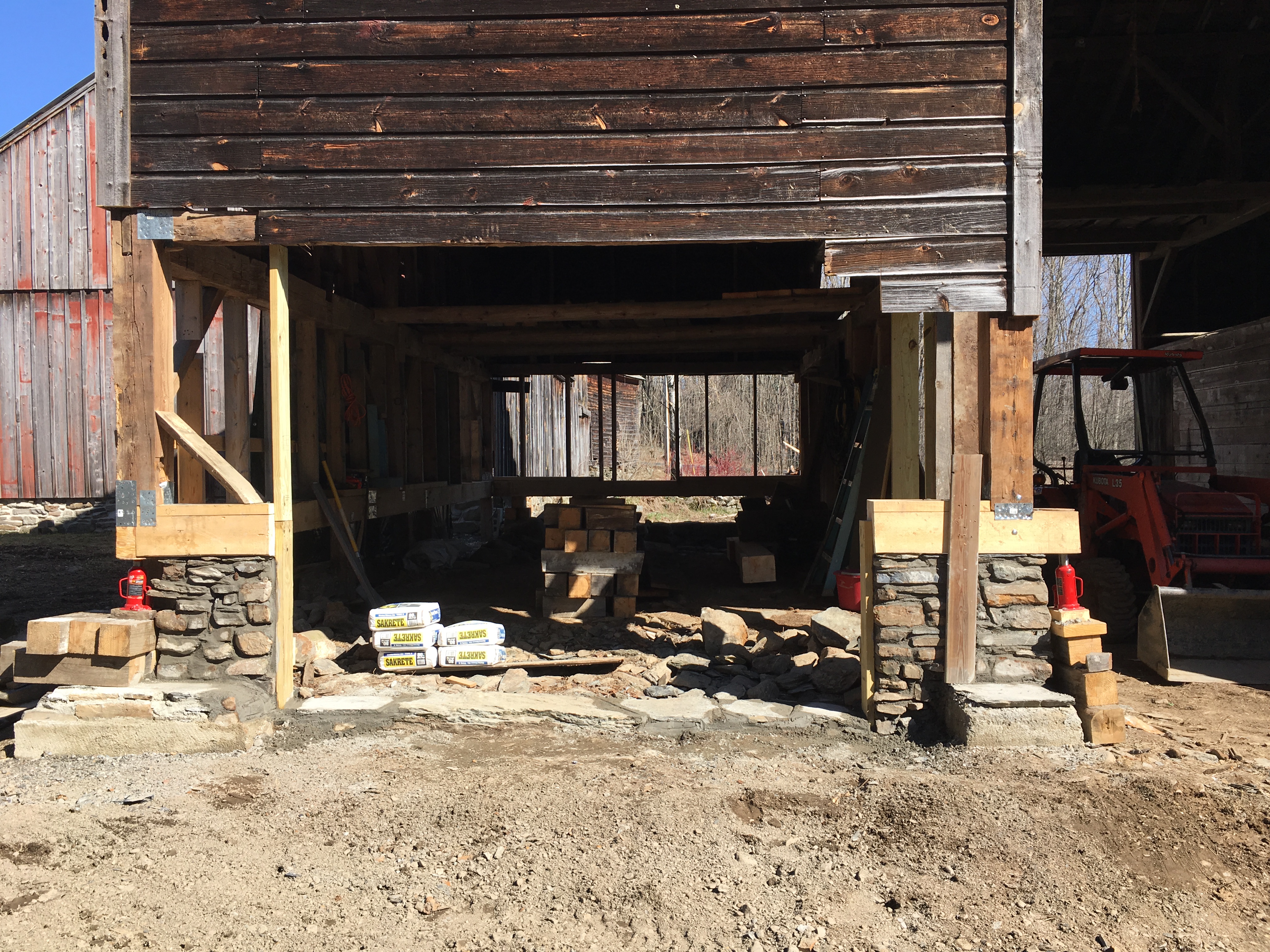

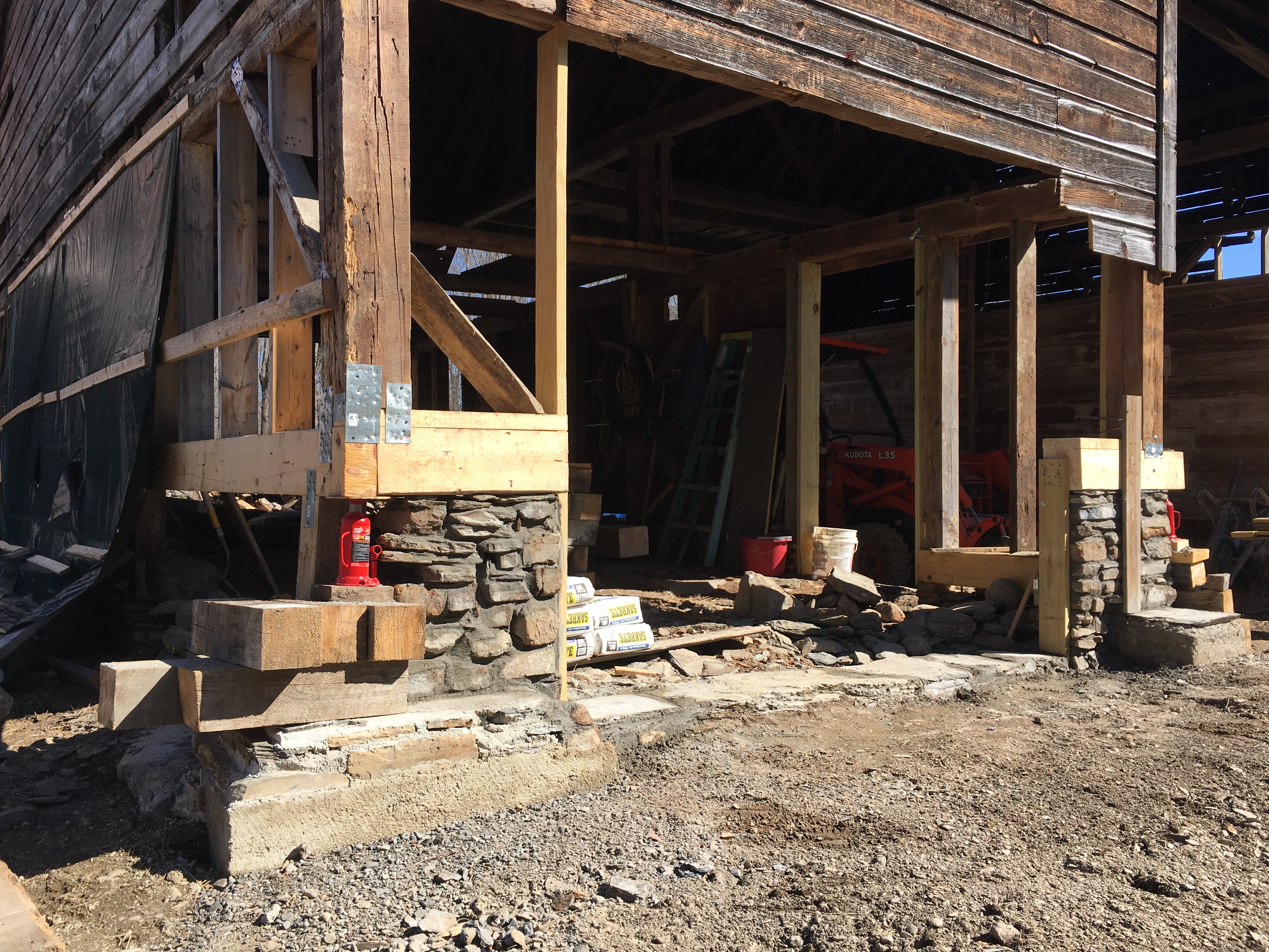

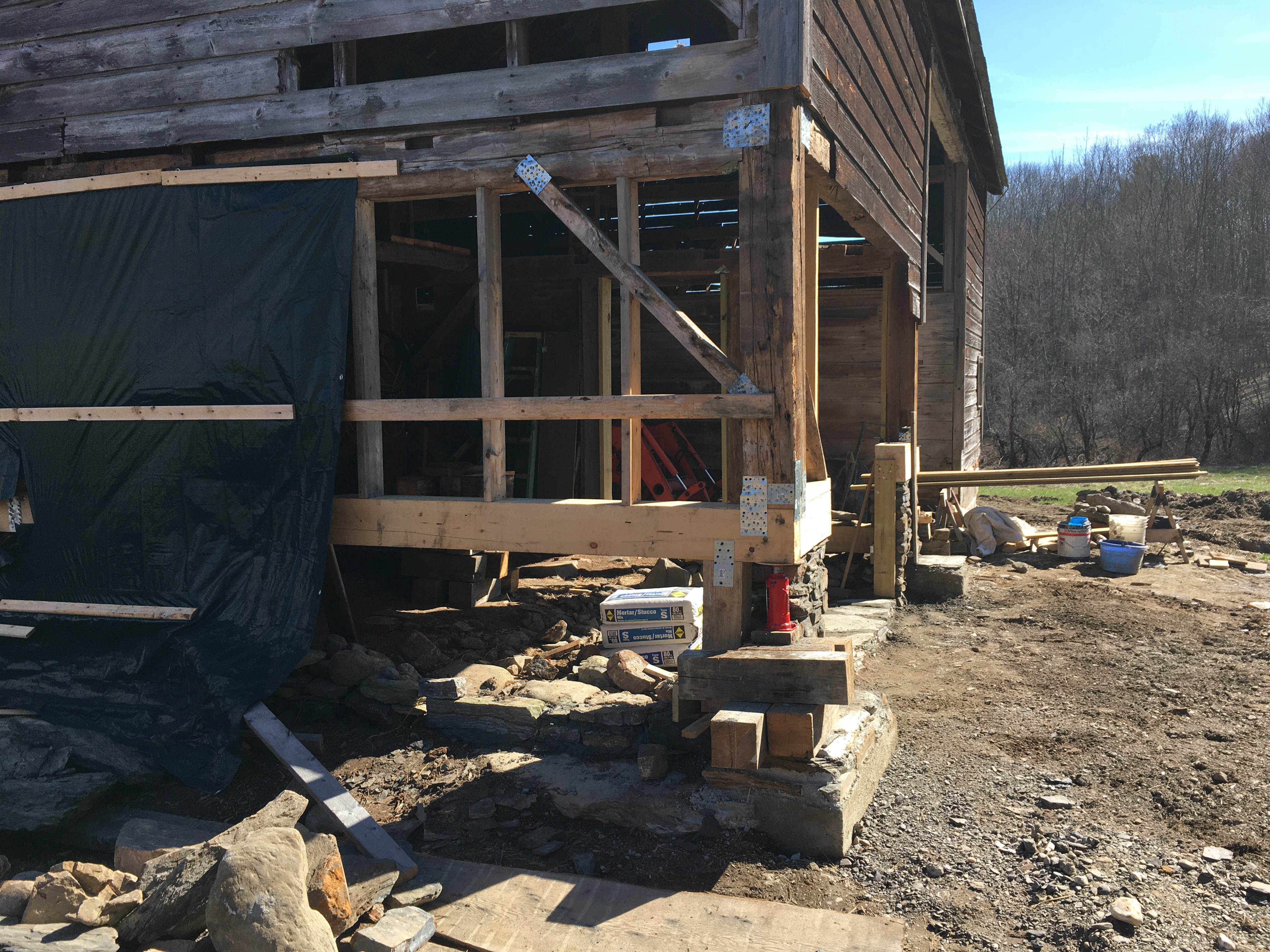

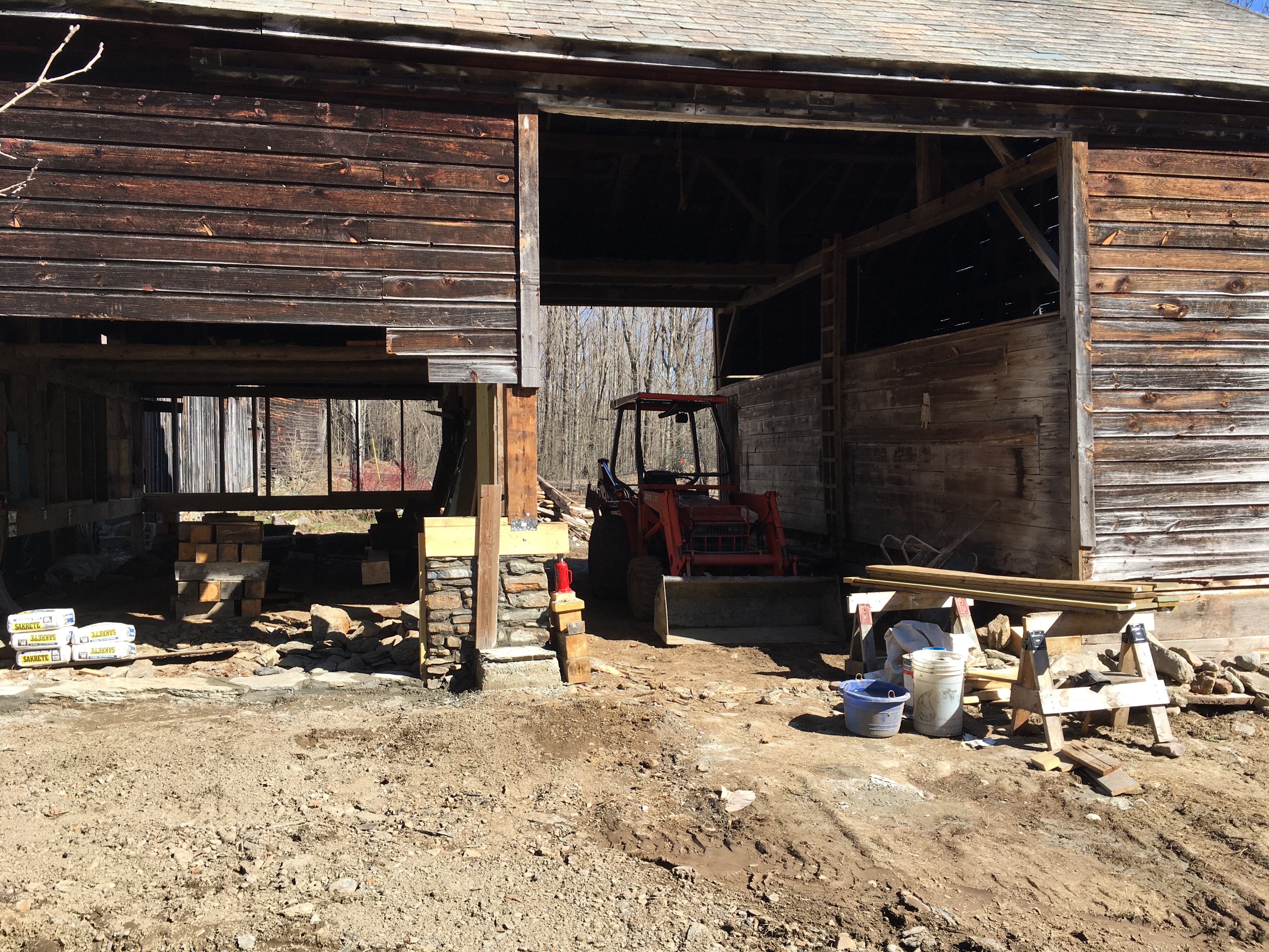

The foundation work has started again. Beam cut out for entrance to this bay. Framing for windows comes next.
