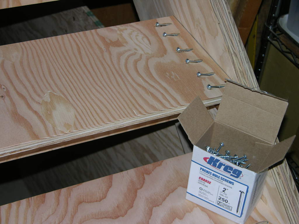

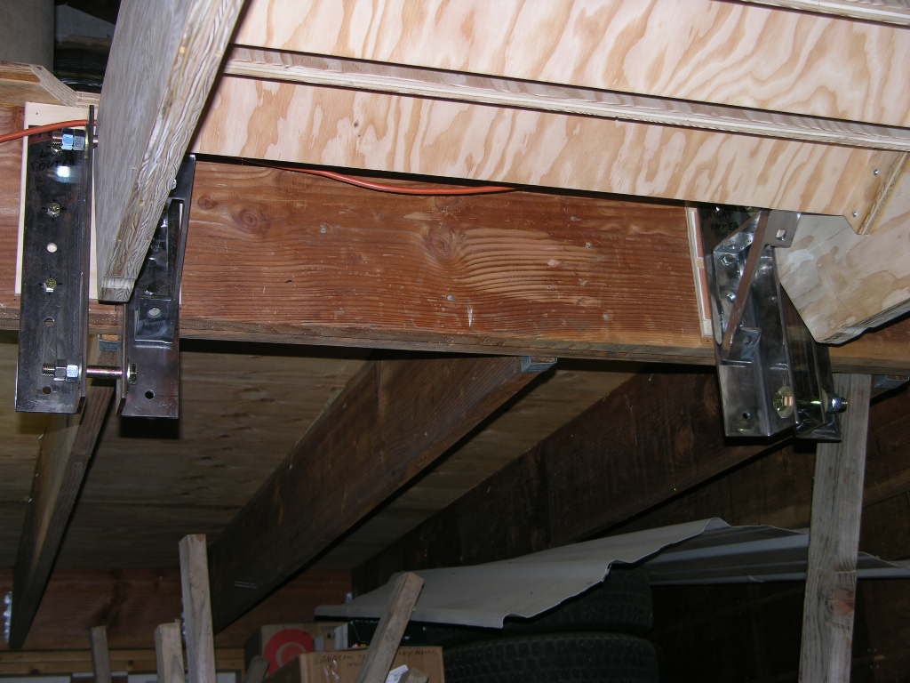

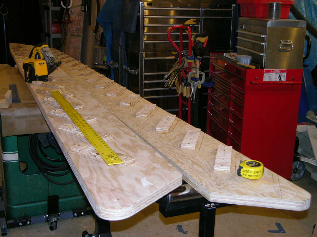

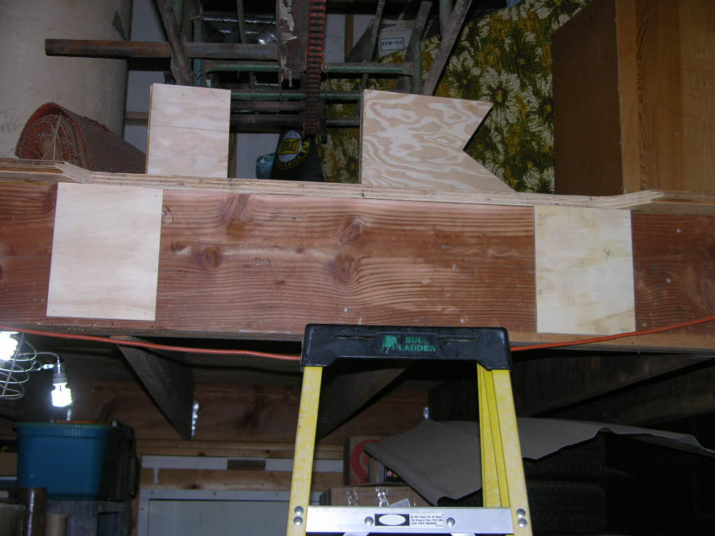

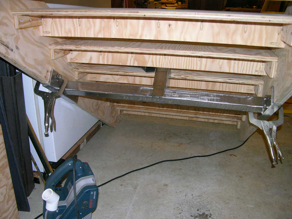

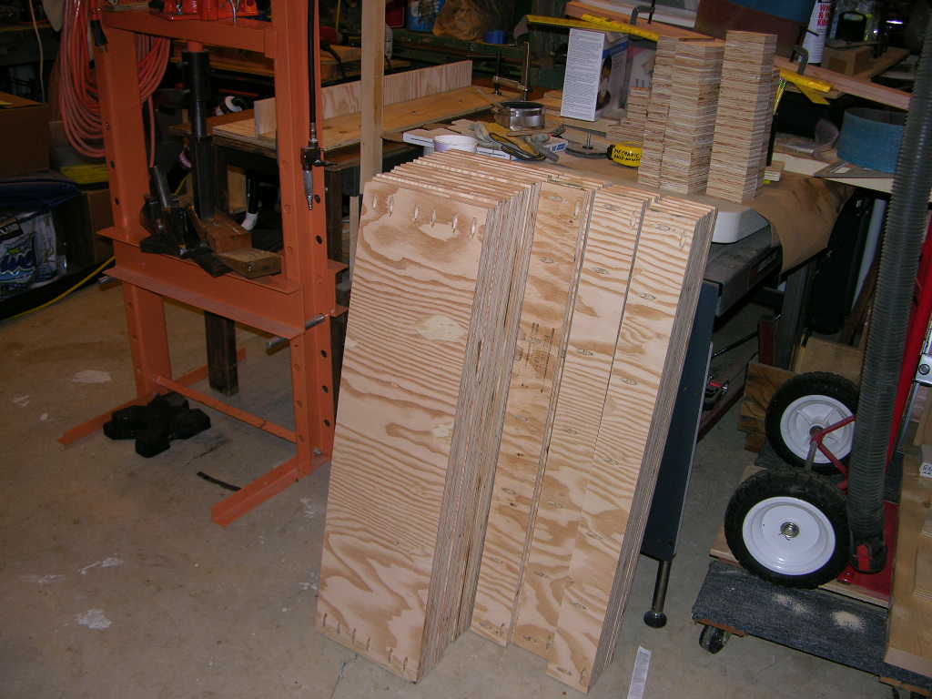

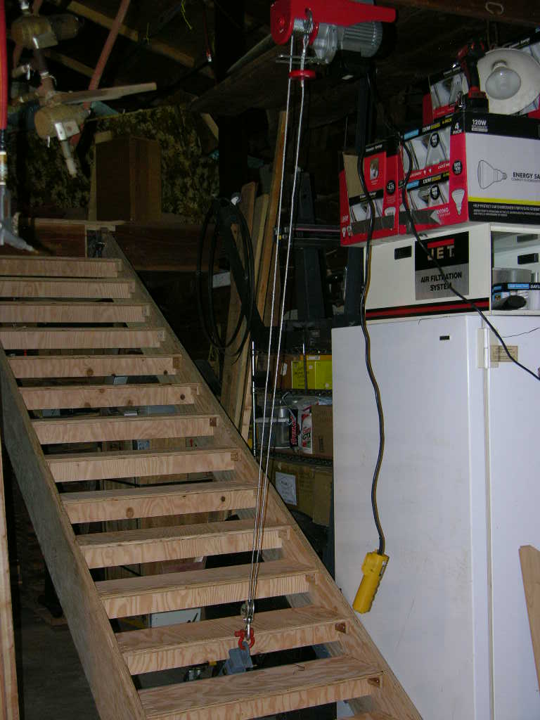

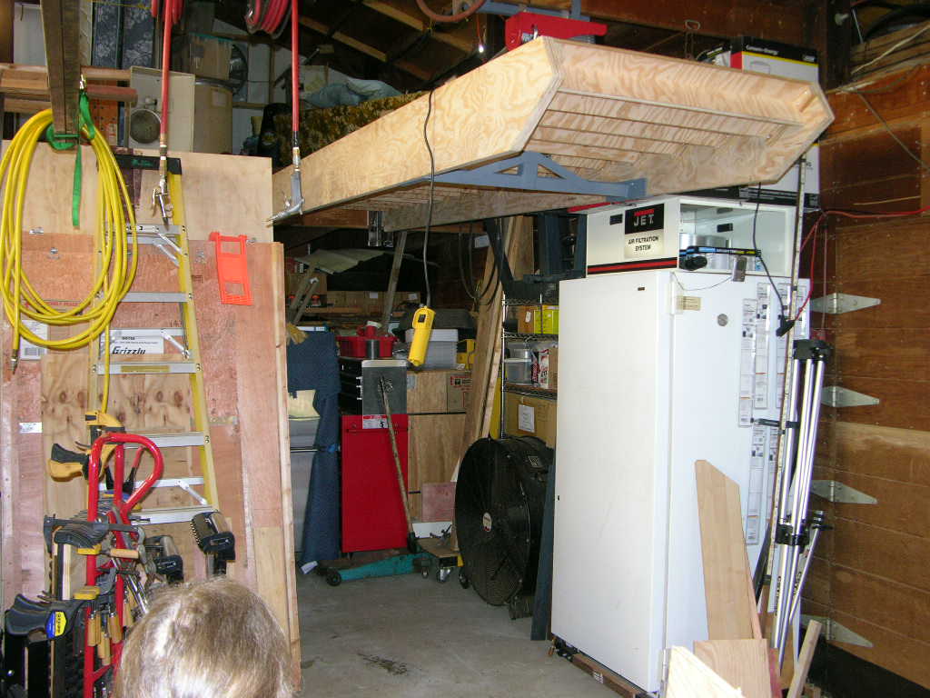

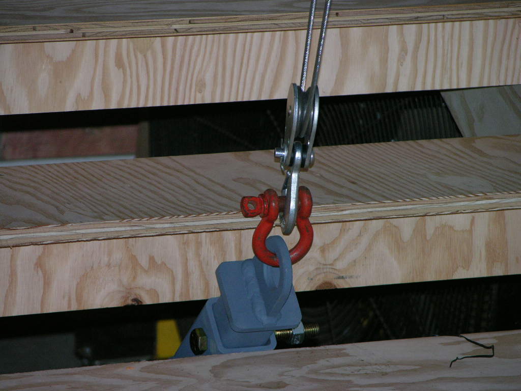

Are you SURE you can't put a staircase in your barn? I did (AFTER I'd converted it to a wood shop), and it's been great - stows completely out of the way, took 5 sheets of 3/4" shop grade plywood and an 1100 lb version of the HF hoist, little bit of welding -
That mezzanine is 1-1/4 T&G ply over 2x12's on 24" centers, stair header is DOUBLE 2x12.
Treads are 3/4 ply 10" x36", with a 4" wide stiffener under each; stringers are DOUBLE 3/4 ply "glue-lams", cleats under every tread, cleats are glued/screwed, all else is just pocket hole screws (lots of 'em). In the next to last pic, those little "divots" on the bottoms of the stringers sit firmly on those lower cross-bolts when the stairs are DOWN, so the upper pivot bolts don't take all the weight.
Staircase is solid with me (190 lbs) and anything I can carry up. Later I added some removable "runners" of plywood up both sides, stairs open in the middle, so I could load a hand truck at the bottom, then pull it up the stairs. A few pics (I have dozens more :=) DSCN1578.JPGDSCN1580.JPGDSCN1603.JPGDSCN1606.JPGDSCN1612.JPGDSCN1618.JPGDSCN1624.JPGDSCN1625.JPGDSCN1627.JPGDSCN1629.JPG
