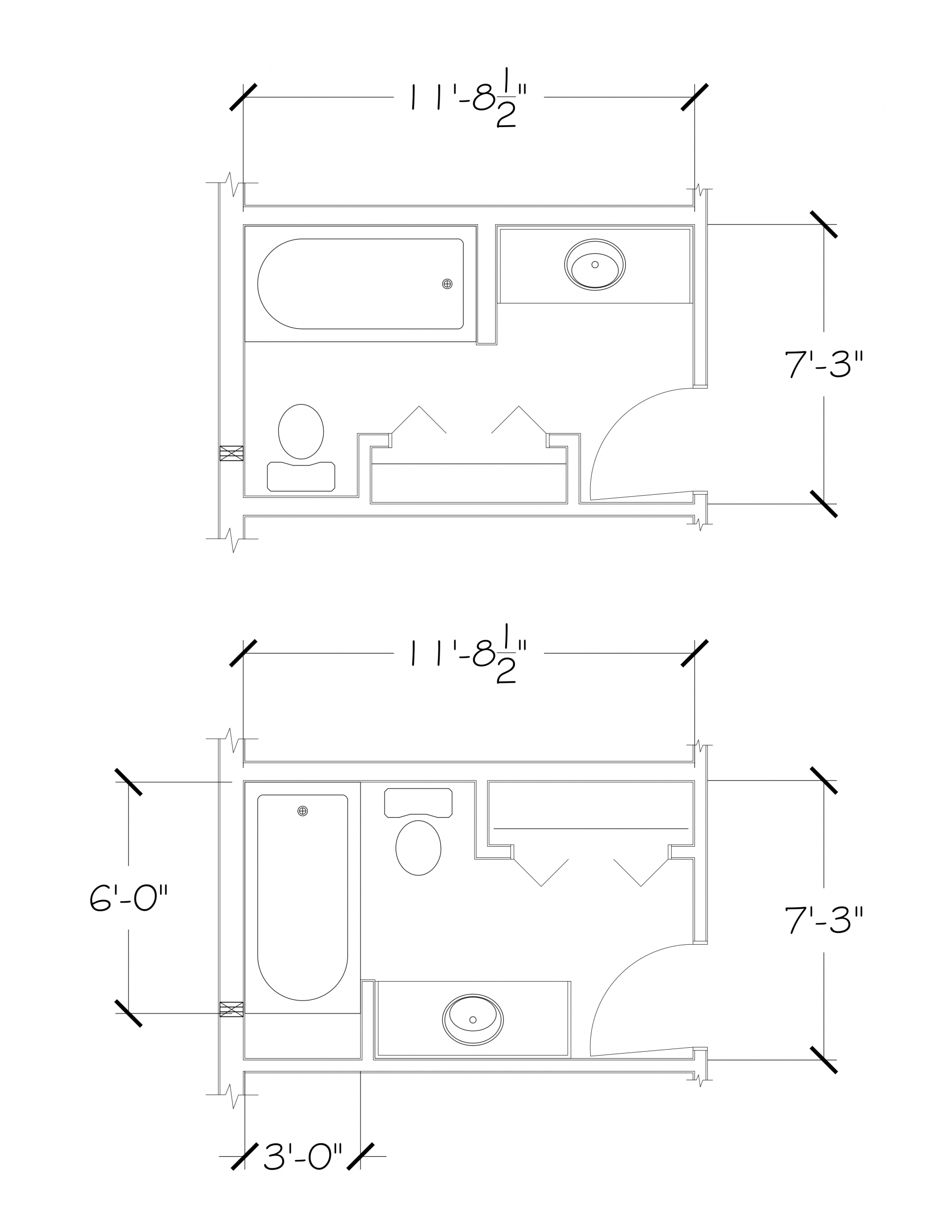

The tub is too wide for a toilet to be placed like it is. Most bathrooms put the tub on the outside wall, going the full five feet width of the bathroom.
   / Barndominium/Shop or "real" House?
#325
The tub I have shown in there is 36" x 72" because the normal size tubs are useless for me. I'm almost considering just putting a shower there with no tub. I never use a tub.
The house I just sold had the tub and toilet arranged like that but they were even closer together than what I have in my current layout.
My kid had a bathroom setup with the toilet across from the tub. The shower curtain hit my knees when I was reading the paper, as they say.
Also, if you put the tub on the outer wall, you can put the toilet next to it, then put a nice shelf(s) above it and have a place to hold your towels that you can reach while in the shower/tub.
#328
I had that on a previous version but then the bathroom got wider than 6ft after I switched to 16" I-Joists, so I rotated the tub.
Yeah, the house I just sold my knees were only a few inches away from the tub.

If I turn the bathtub to the outside wall like I had it before, there is some wasted space.
I've lived in houses with similar bathroom configurations to both above. Can't say I feel strongly one way or another. But would pick the option that is not wasting space...

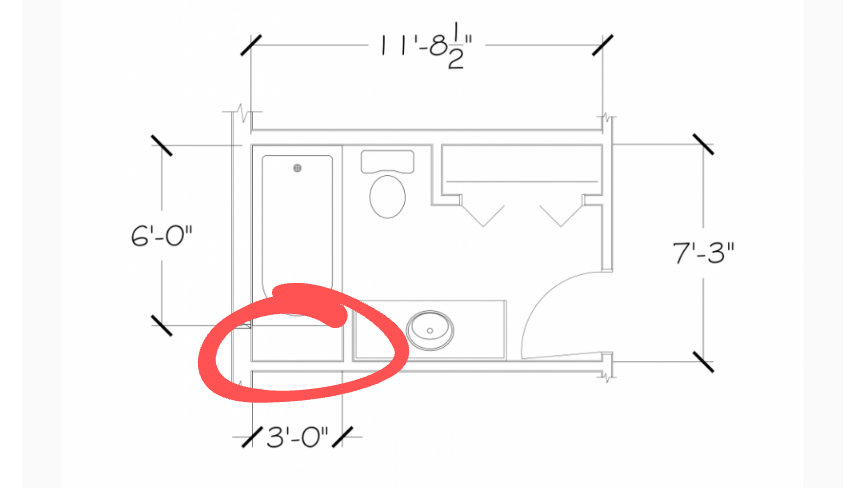

That makes no sense at all 😂
On the attached drawing use the space at the end of the tub for a gun safe with access from the bedroom 😉
