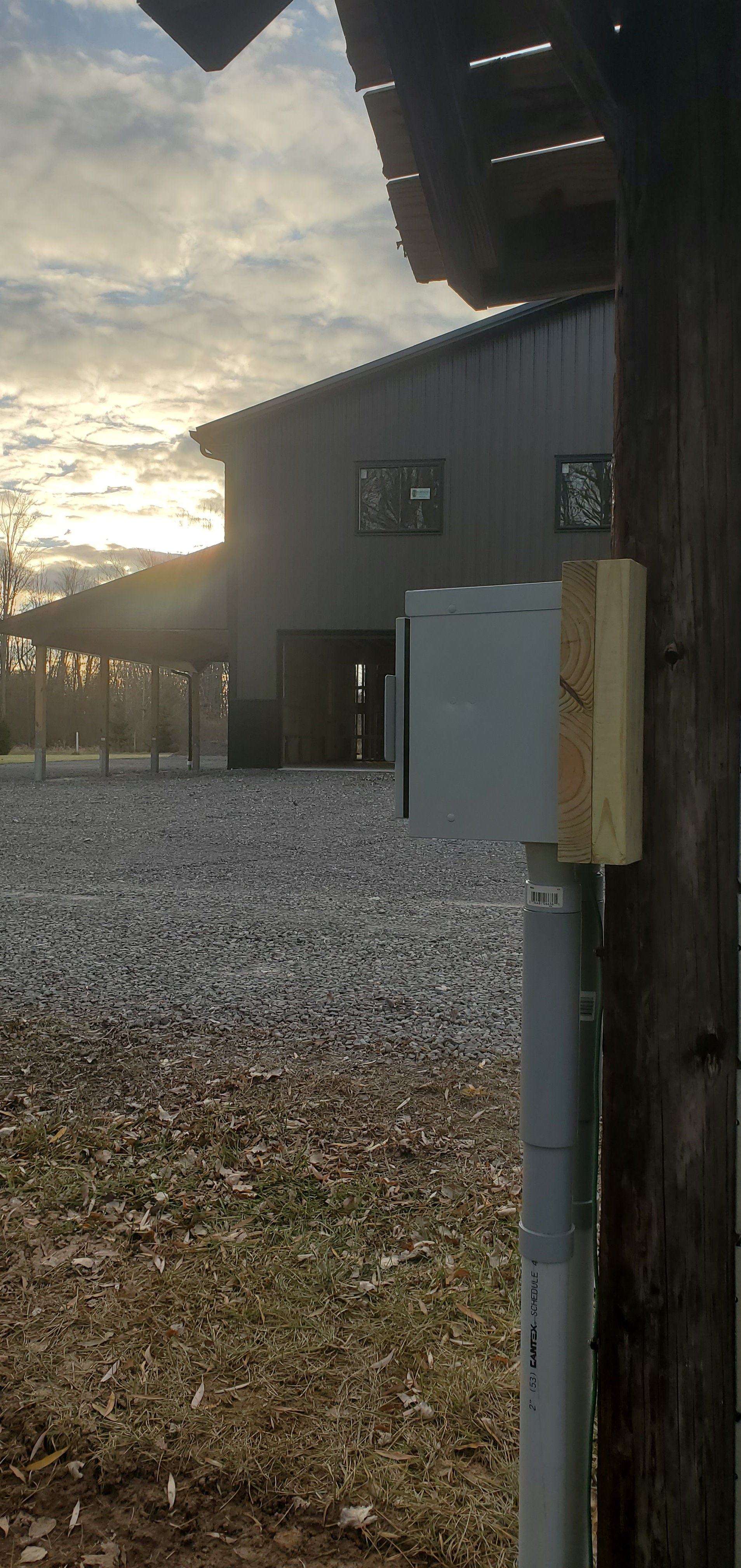

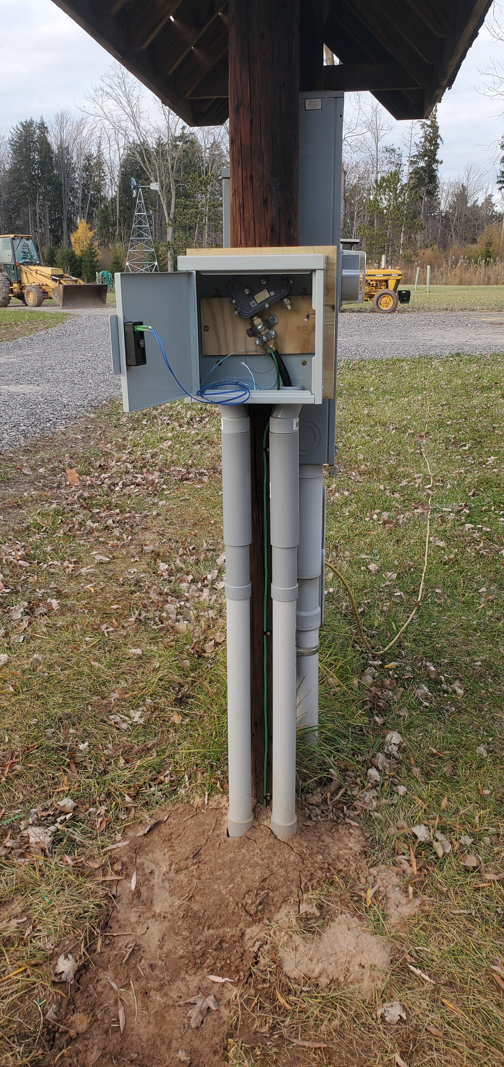

Had to take a break from working on the house and trench for my internet. Spectrum needs to run a plant extension to my meter pedestal. It was going to cost ~$5200 for installation if I had them directional bore the cable to my meter pedestal. If I dug my own trench, $0. Can't argue with $0...

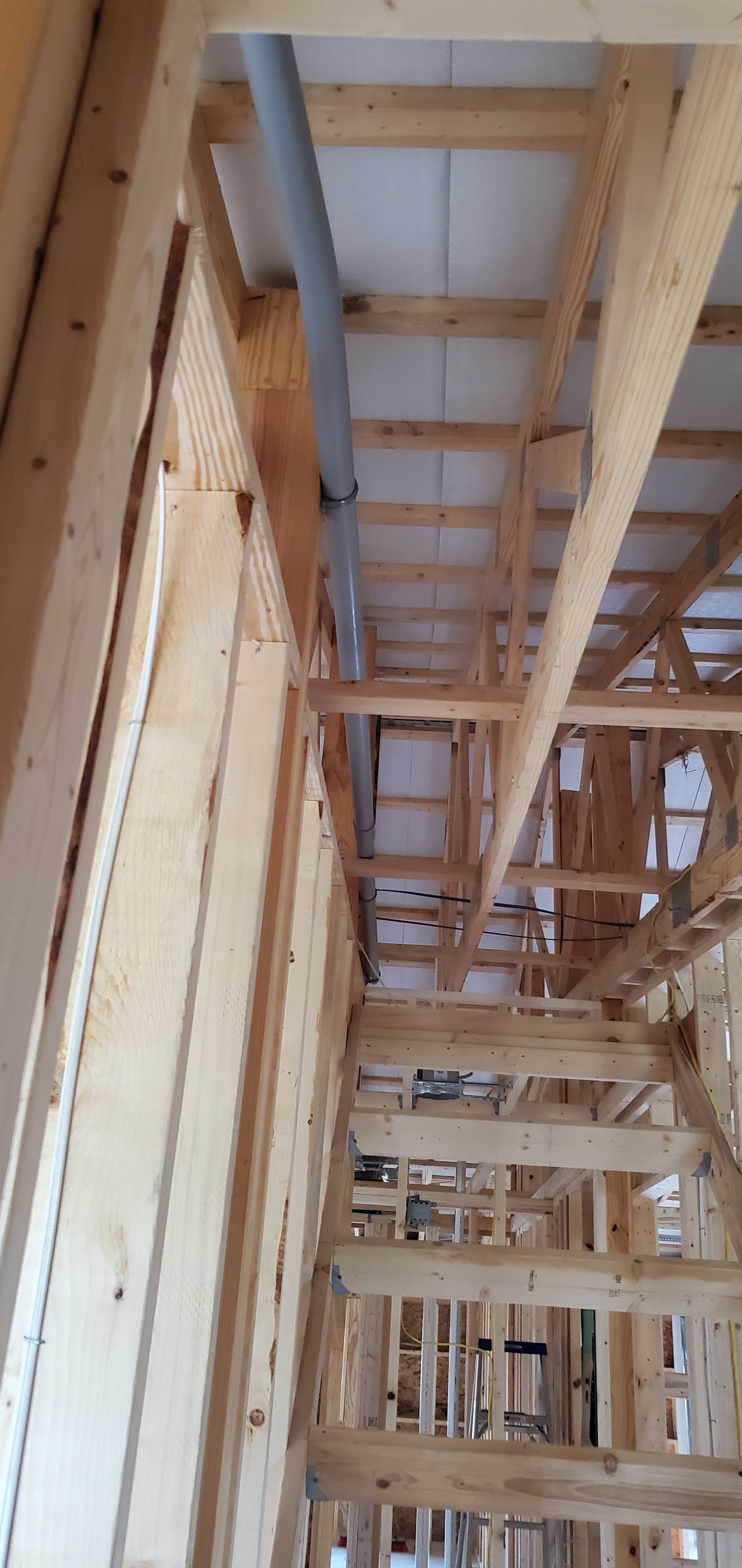

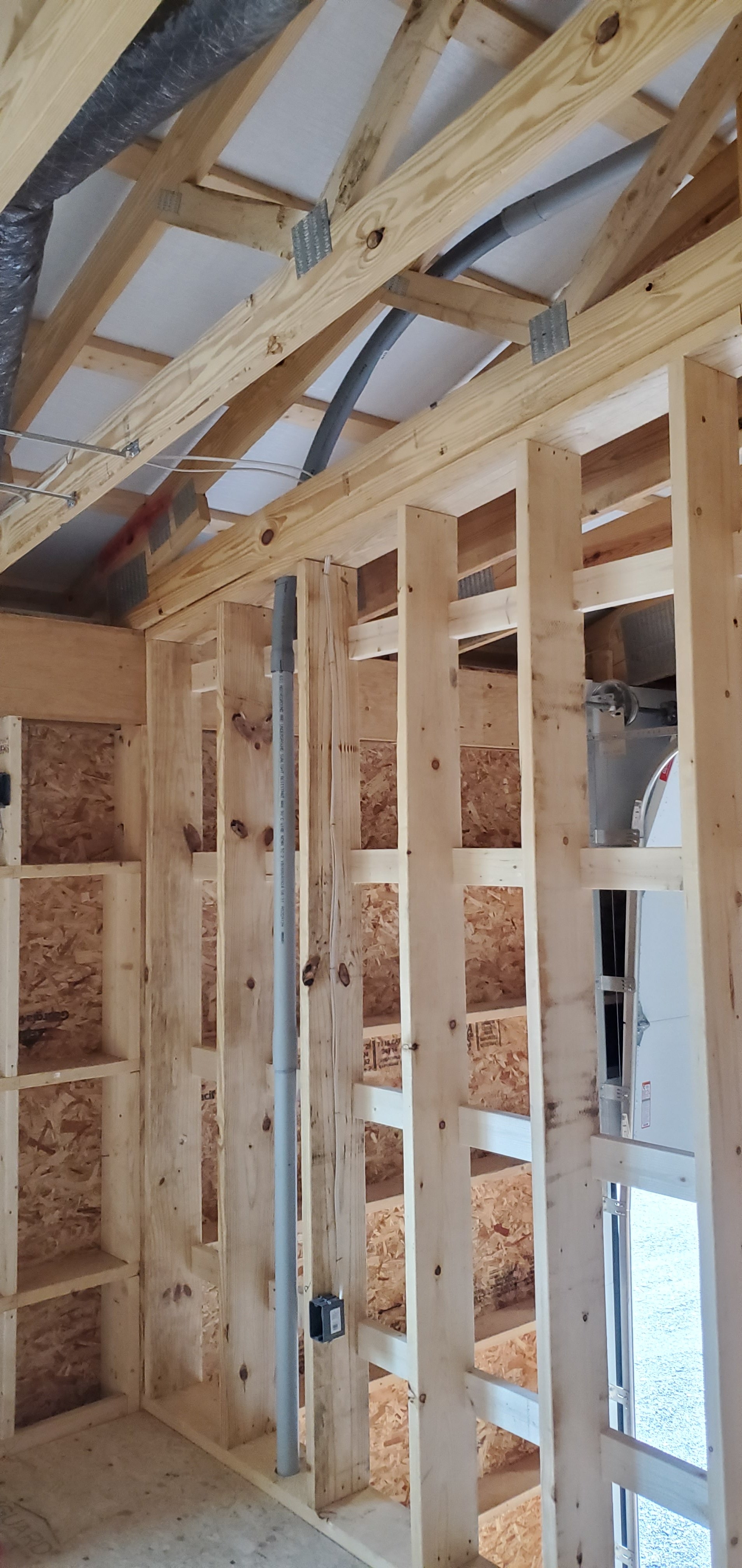

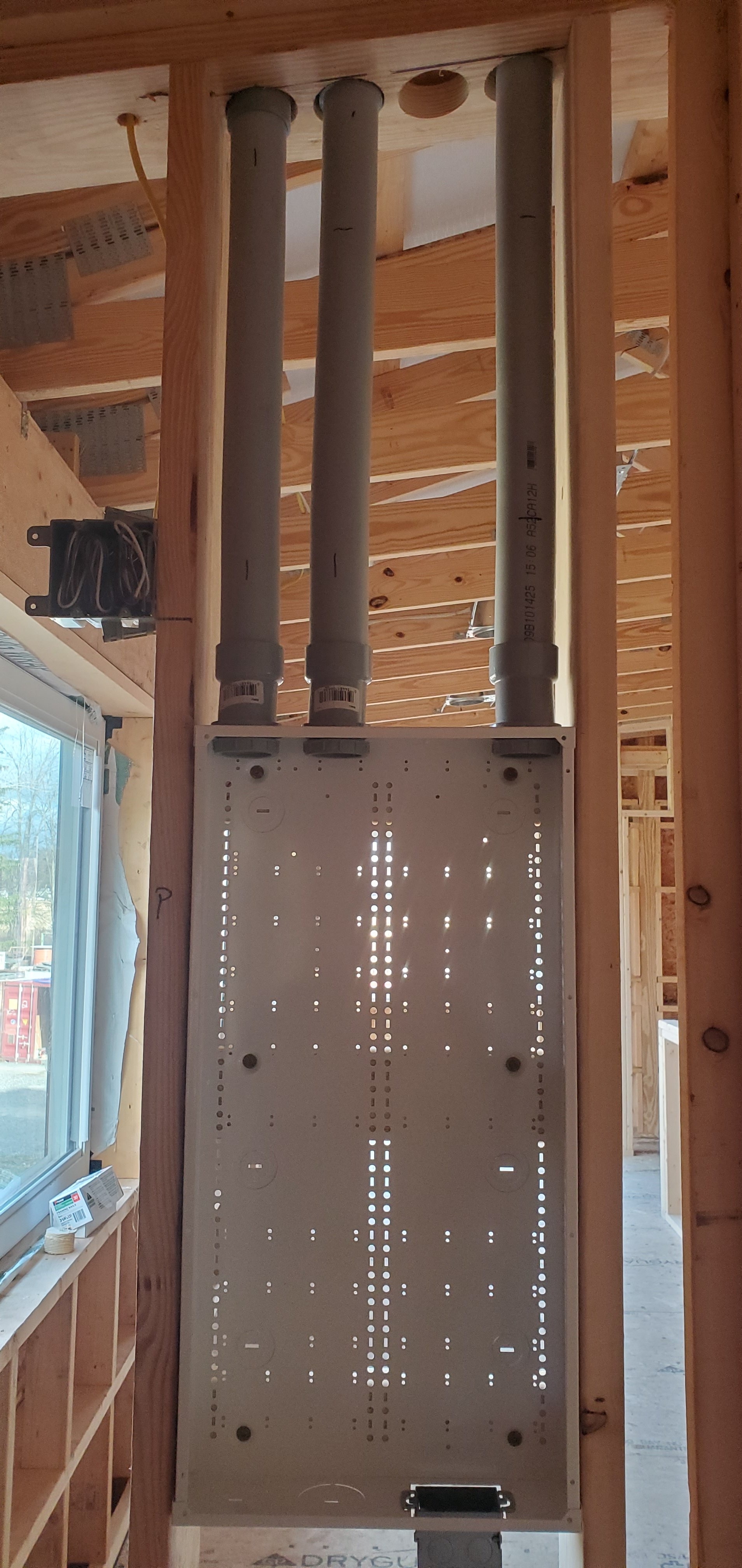

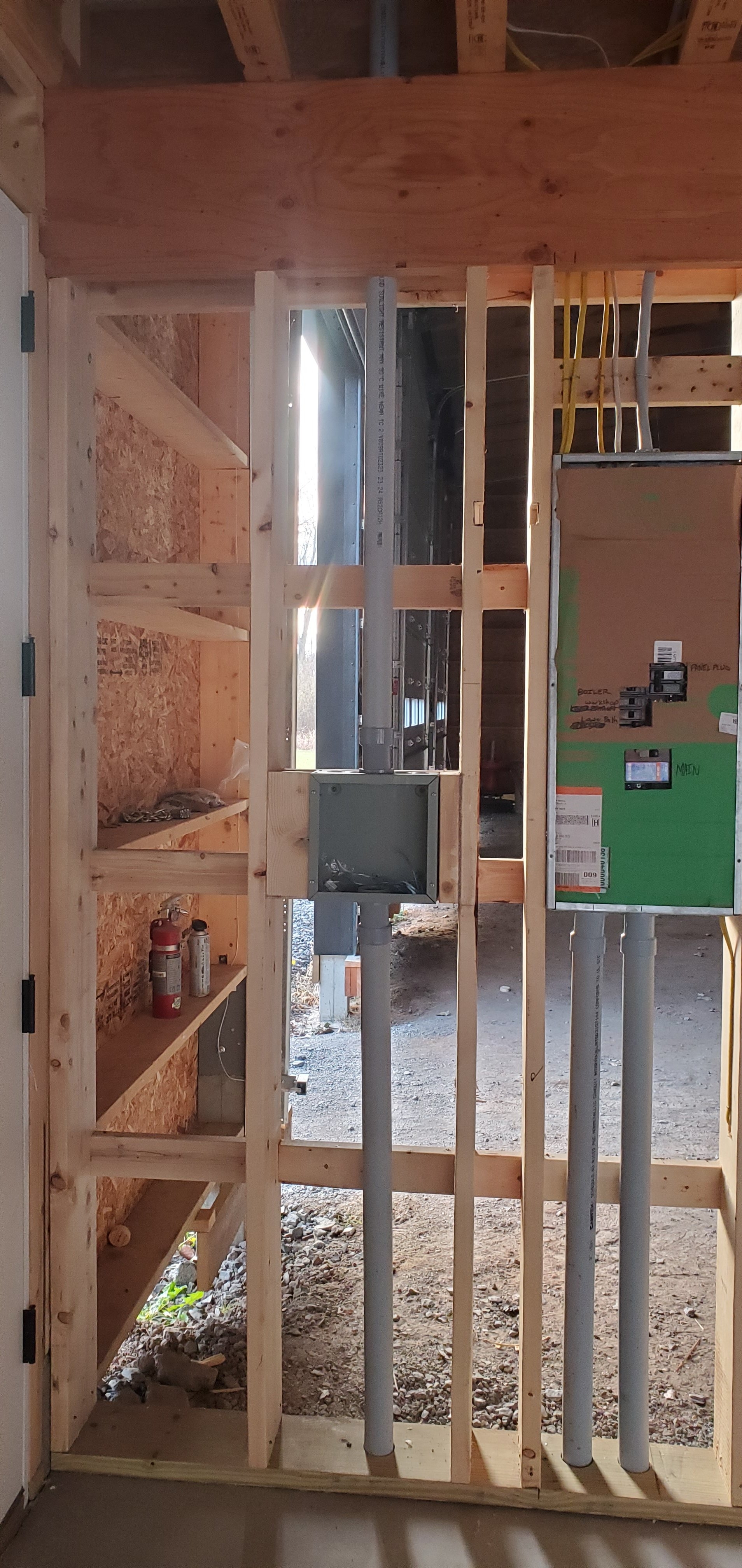

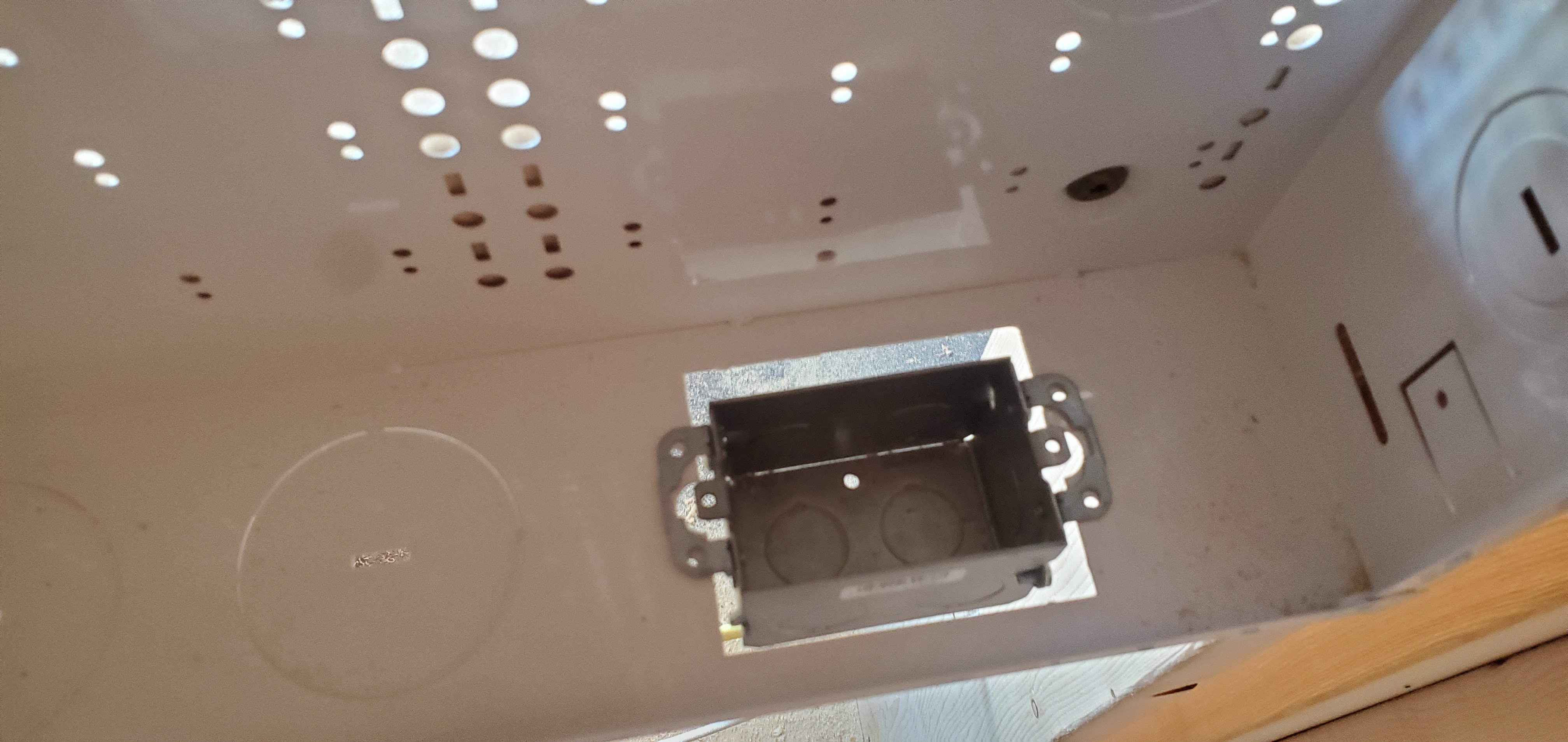

Finalizing all the pull boxes, low voltage panel and conduit for internet/network wiring throughut the structure.
One question I have for the electricians out there. The low voltage enclosure has a knockout for a 1 gang outlet box. However, I can't find a box that fills the space. They are all much more narrow than the knockout...
View attachment 4434224View attachment 4434225View attachment 4434226View attachment 4434227View attachment 4434229View attachment 4434230View attachment 4434232
Are you sure that knockout isn't for a gland plate?
   / Barndominium/Shop or "real" House? #729
What is the advantage of running the conduit without any wire in it? Why not install the wire now, even if it's not connected to anything.
It's a structured wiring panel with a knockout for an outlet, so you can install the cabe modem in the panel and have an outlet for it. I'm probbaly going to try to fit a network switch in there too. The router will have to go outside the box because the wireless antennas will not work inside the steel enclosure. I may try to put the router in the panel and then use extension cables to antennas inside the attic space.
