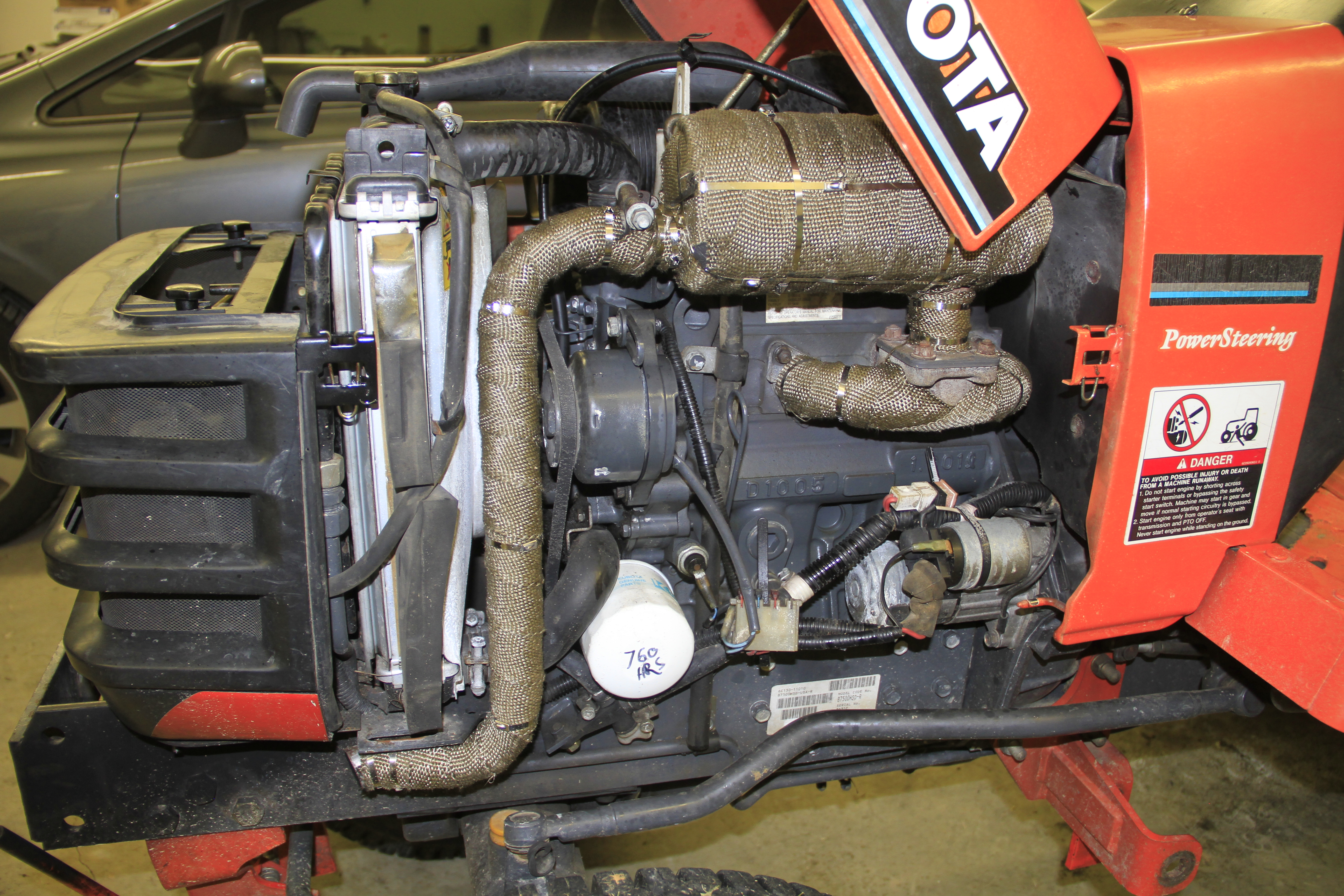

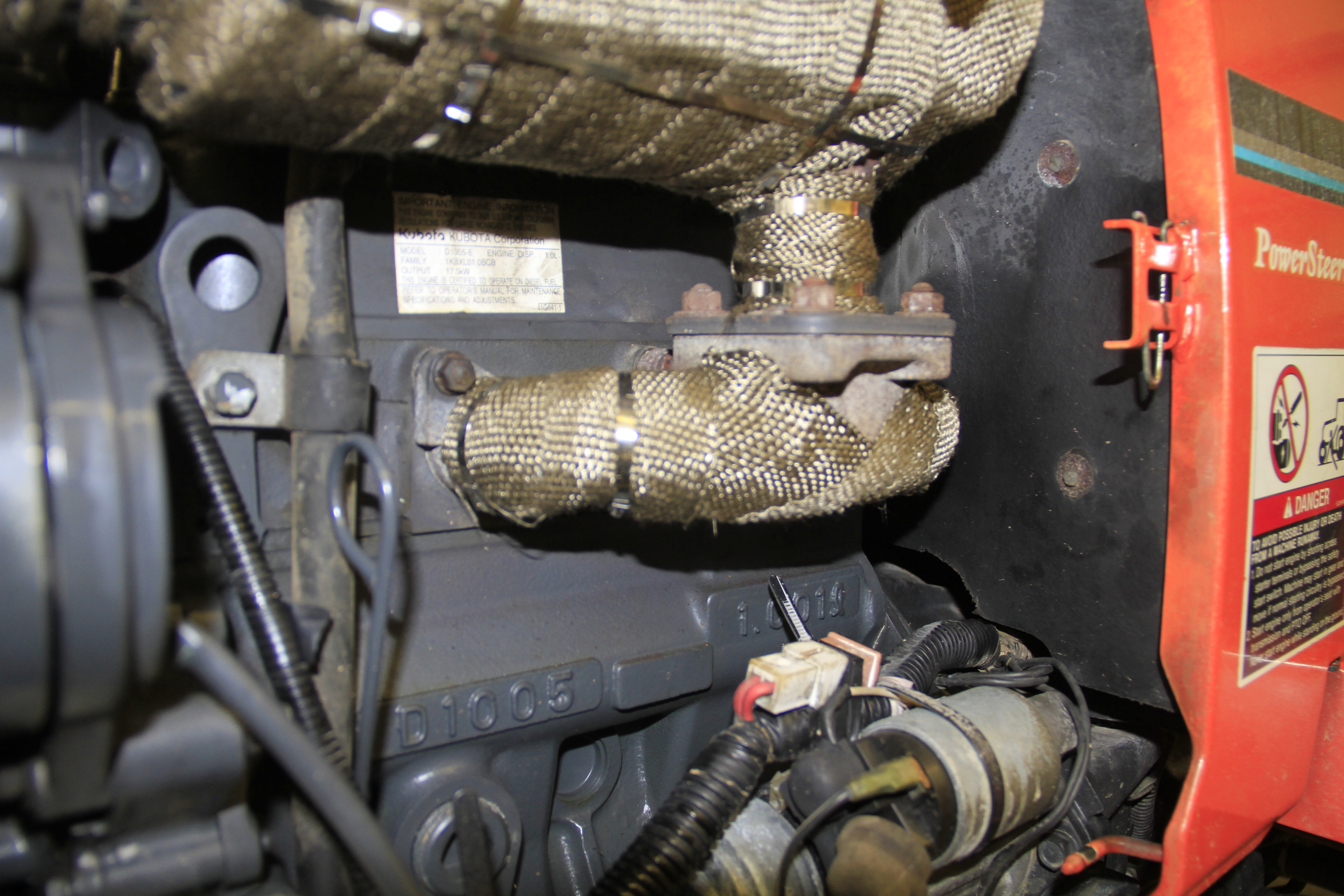

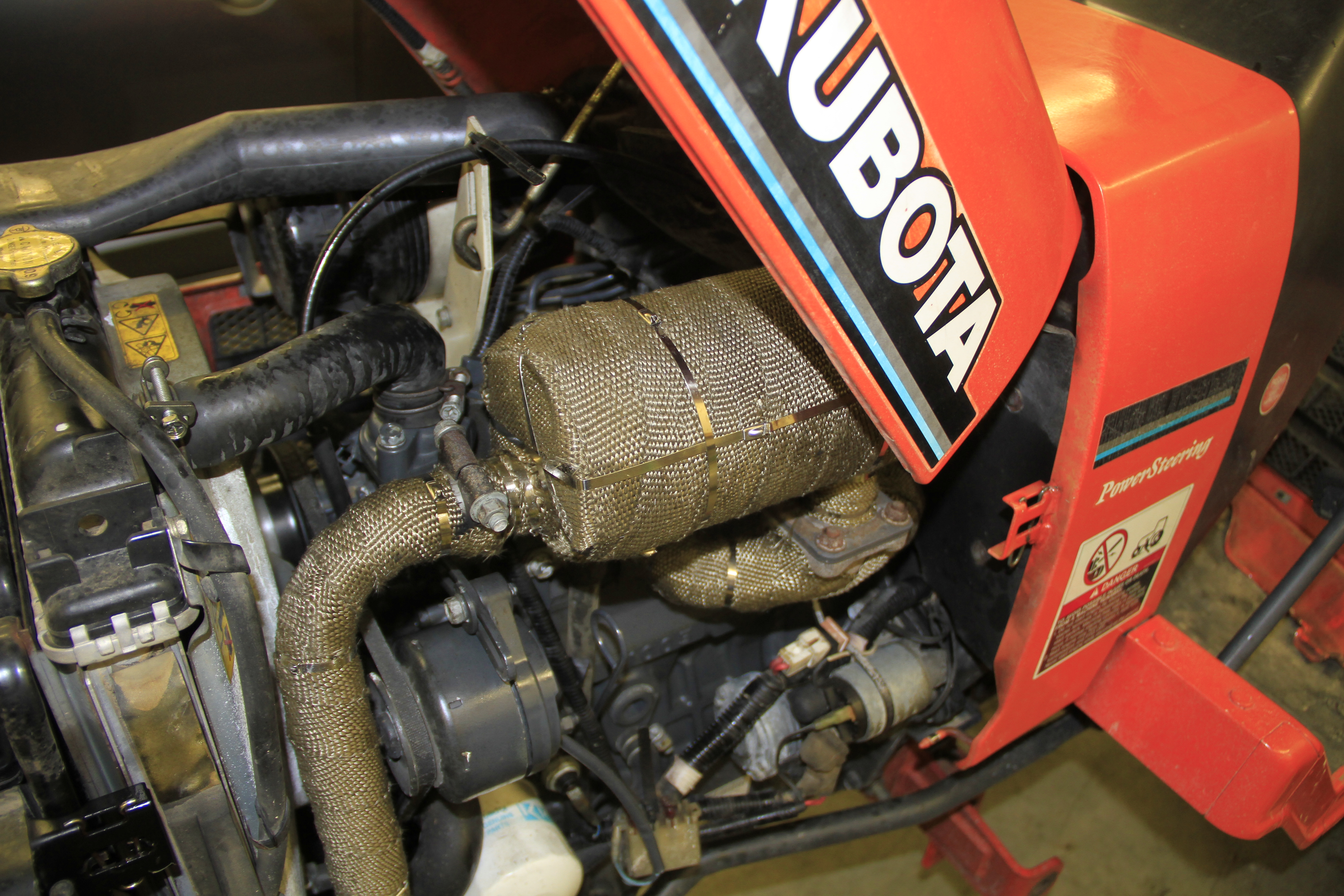

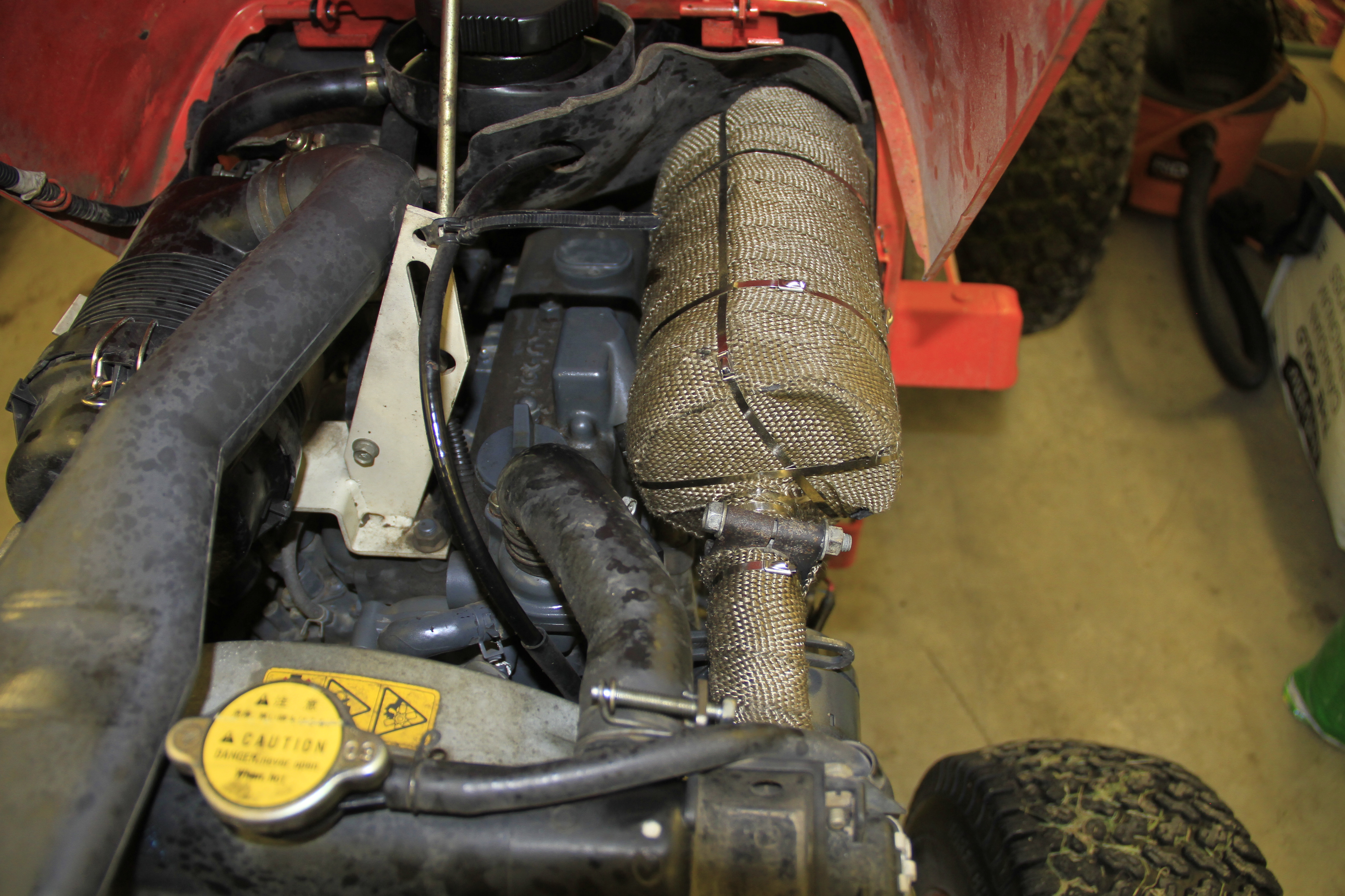

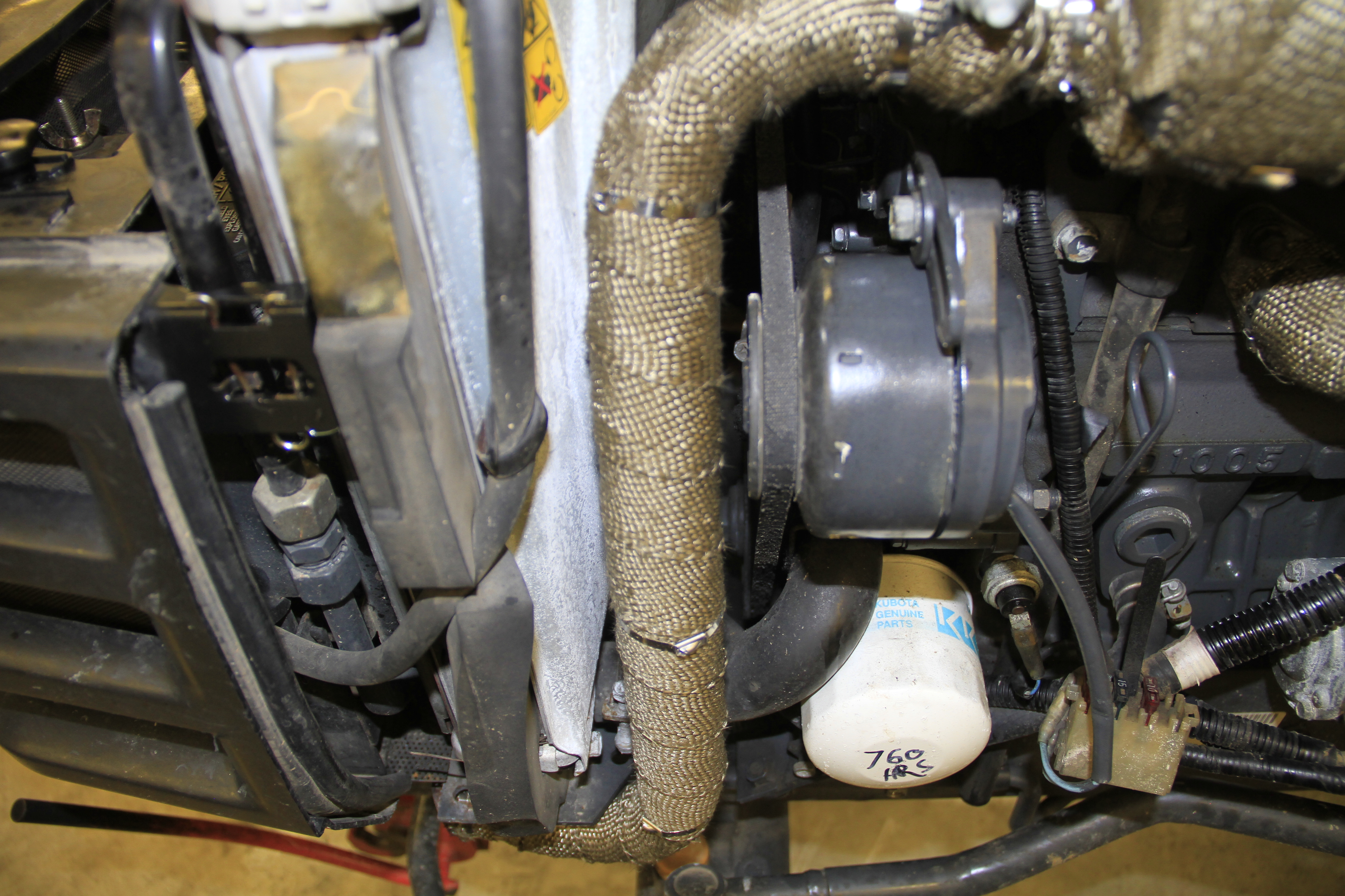

The heat from an under hood muffler, exhaust tube and headers is, well, hot. The heat radiates through everything near it and even cooks the hood to a point where you can't leave your hand on it. Thus I've decided to try that exhaust wrap you see on dragsters and other race cars. It costs $20 for a 2"x25ft roll and $11 for a pack of stainless steel zip-ties so what the heck.
I got to work and took off the header, muffler and exhaust tube. The exhaust tube and muffler are bolted together, so I tightened them up to keep their position and began the wrapping process. This process isn't difficult, but it's certainly time consuming. It took me about 3 hours to wrap everything and put it back together.
WOW was it worth it. The EGT has shot up, but it has made such a difference under the hood. At 2,000RPM with a heavy load, I can literally put my hand on the header/muffler/exhaust tube. Its not comfortable to leave my hand on it too long, but it certainly doesn't sizzle! I didn't wrap the flange, so I can feel what the actual heat coming out is (at the 2kRPM and a load it's untouchable and I'm sure we've all felt that sizzle before). Overall it's a very noticeable difference under the hood and well worth the $33 and 3 hours to do it. I'm now considering the same process with my other vehicles. I will 100% do this with any other tractor I ever have. I will put up pictures tomorrow when I get a chance.
The tractor is a Kubota B7500.

I got the Titanium color because it's the closest to OD I could find.

Get rid of it as you will ruin the exhaust, particularly right at the pipe after the 4 bolt flange.
Mild steel can't take that heat, only 304 stainless (not 409) will take that kind of abuse.
I ruined a new set of headers in 3 weeks by wrapping them like you did. The metal will crystallize then crack.
Regards, Fred

The pipe next to the 4 bolt flange will get the most heat and since it supports the whole muffler you'll first notice it droop as it heat cycles after some hard running. The idea under the hood is that the rad fan pushes out the hot air through the duct work and side grills behind the rad.
Why not use something 304 stainless off a motorcycle and adapt to your tractor and try it. Remove your stock system and store away for when you trade it in down the road.
Your machine doesn't need much flow as it only turns 2600 or so RPM unlike any car or bike that turns much faster and harder.
I straight piped mine.
Price your muffler from Kubota before you run it too long. 6A320-58400 $159.83 Well it's not too much money if you ruin it. Maybe unwrap just the short section above the 4 bolt flange.
Also if you buy the paint from the wrap company it is simply high heat header paint in flat black.
Regards and good luck, Fred

You're pushing a lot of extra heat on to that alternator.. Not to mention the disruption to the airflow a cylinder causes so that what warm air does get to it doesn't cool very well.
