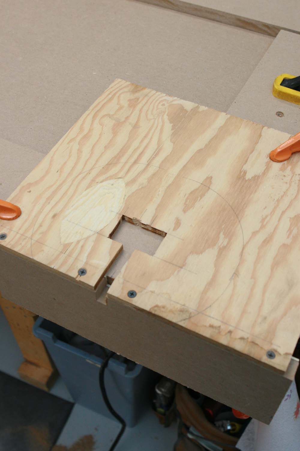

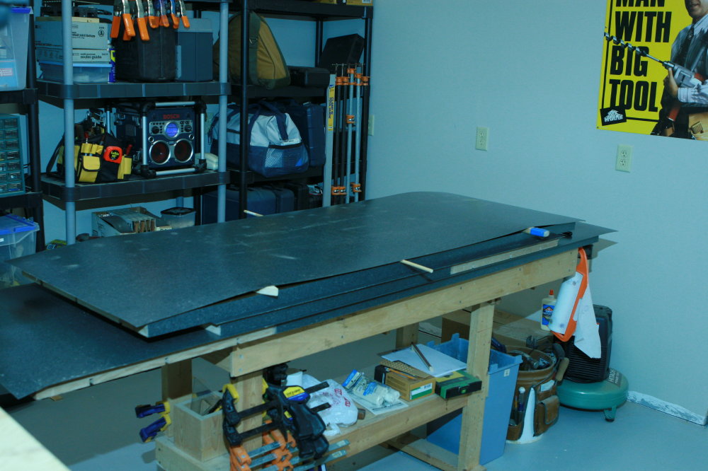

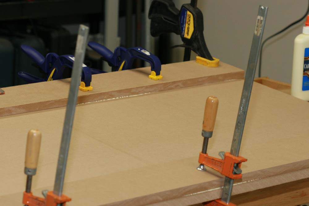

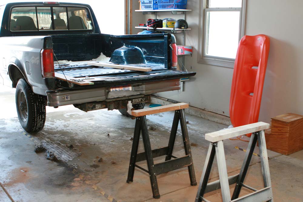

OK, here's my latest installment in the basement project: countertops. I picked up three sheets of 4X8X3/4 MDF and the last three sheets of the laminate I wanted (whew). The MDF is incredibly heavy so I cut it in the garage. Bear in mind, it's 11 degrees F here today, and not much warmer in my garage. Needless to say, no pictures of the cutting, only one of the mess afterwards (photo 1). Then it's the preliminary dry fit (photo 2). I scribed and trimmed to fit (photos 3 & 4). Once I was happy with the fit, I added the build up strips on the bottom. Only the exposed edges need to be fussed (photo 5).

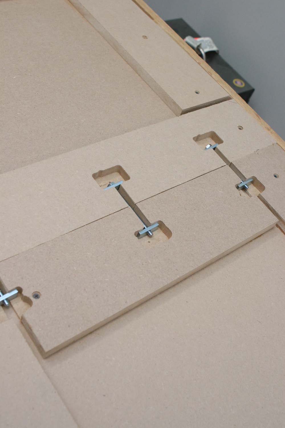

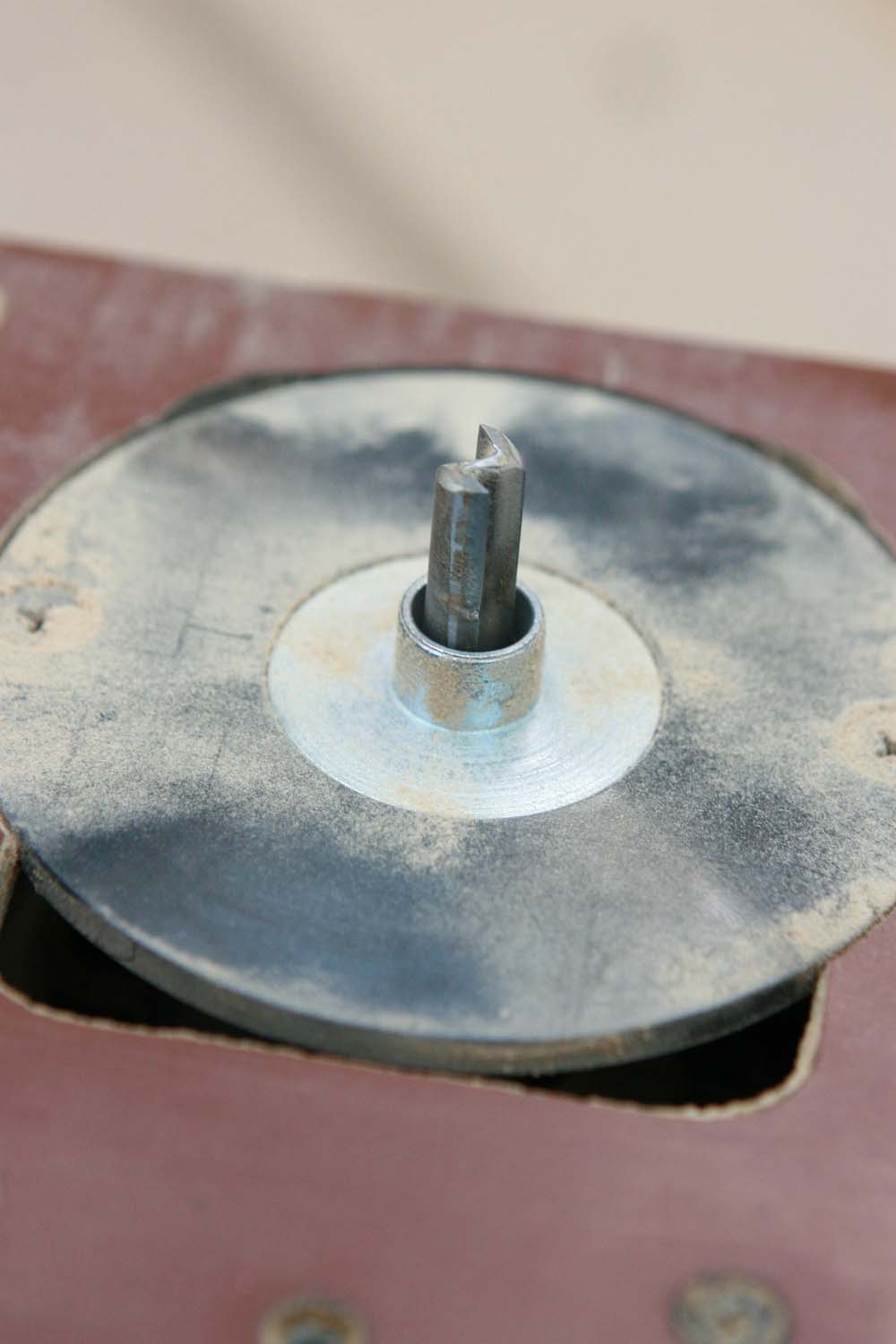

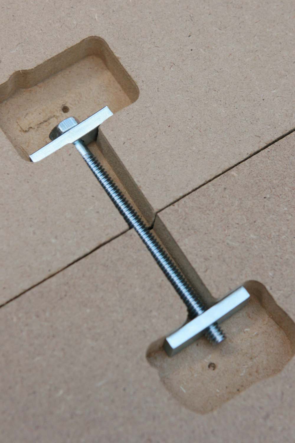

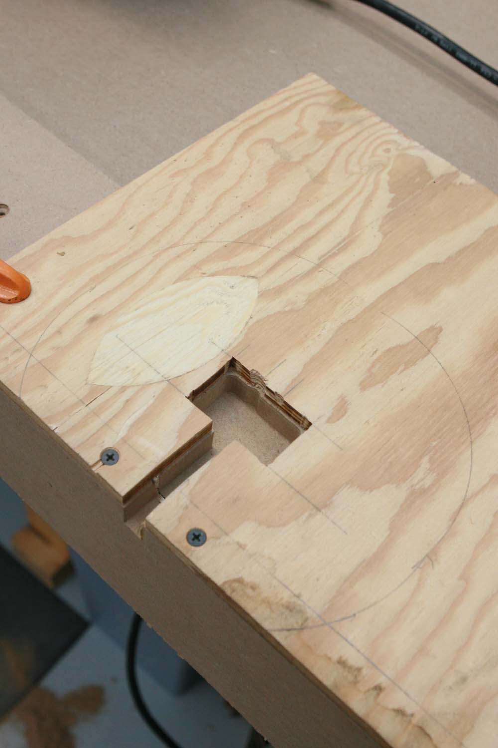

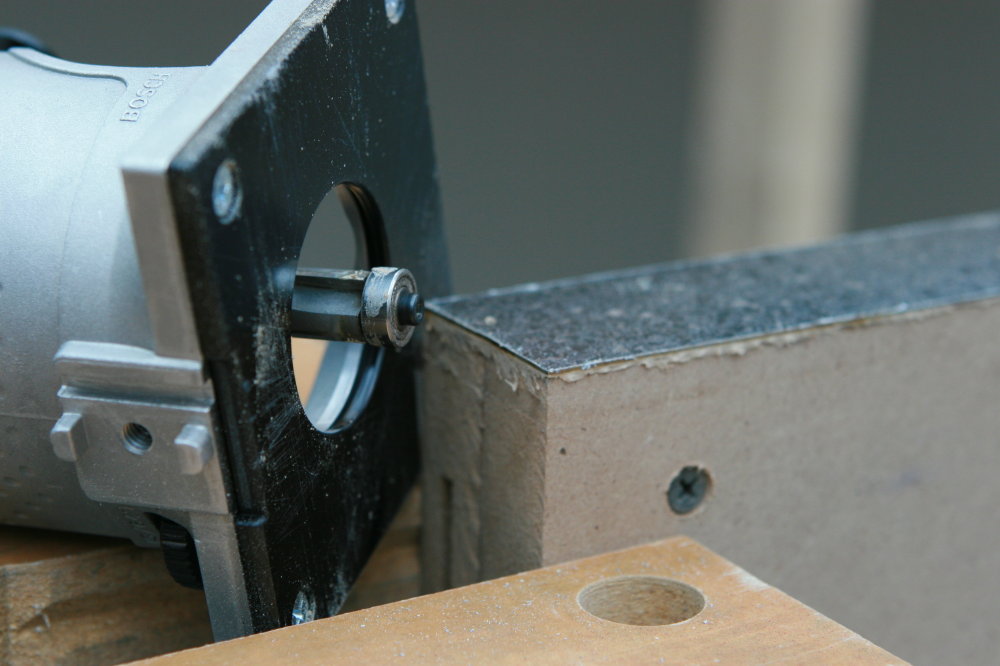

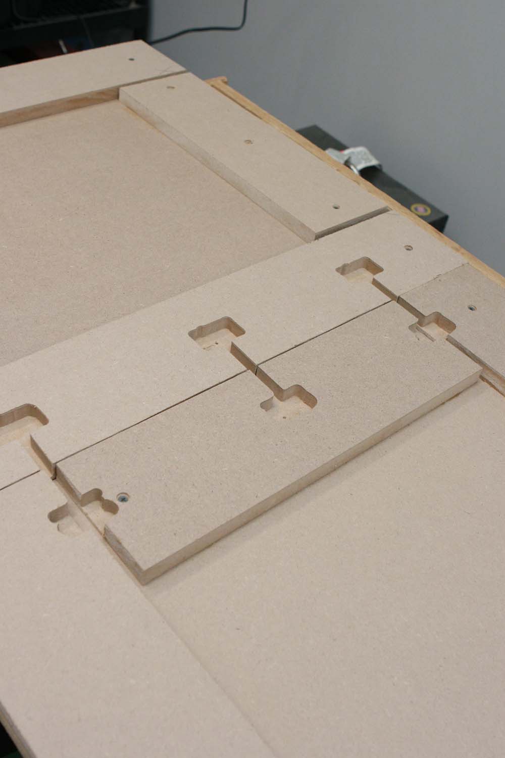

I have to build this in three pieces to get it in place. To join the pieces, I'm using biscuits and connector bolts. Pics 6-11 show the jig I made, the router bit and the connector bolt slots and bolts. There is a slight gap from underneath, but that ensures a nice, tight joint on top. The final picture in this series is the final dry fit.
Tomorrow, it's laminate day!

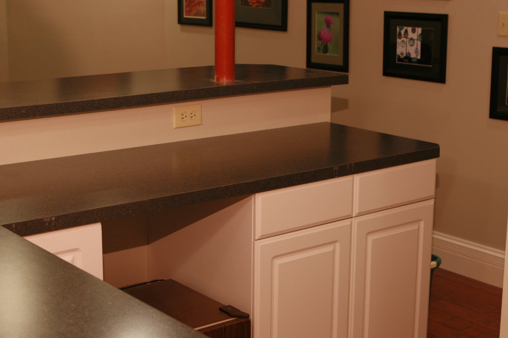

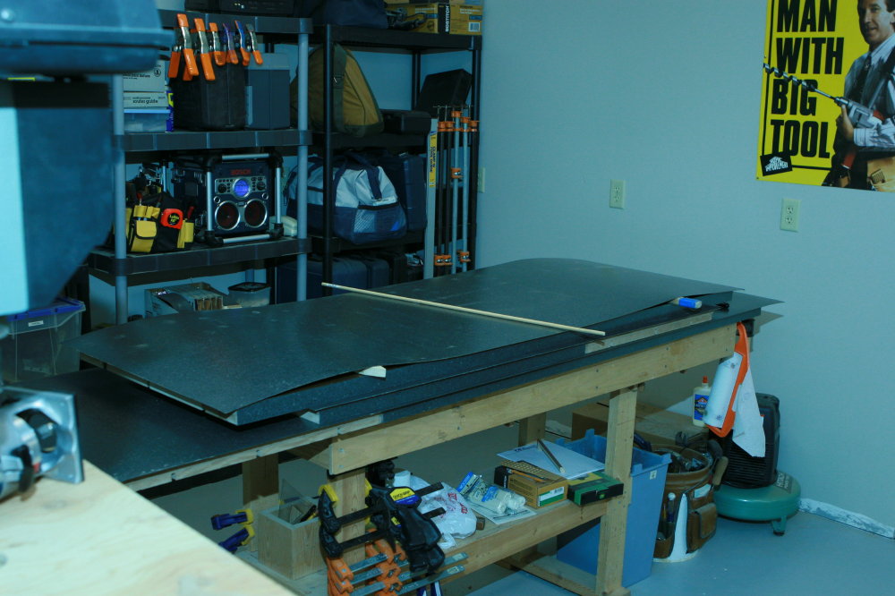

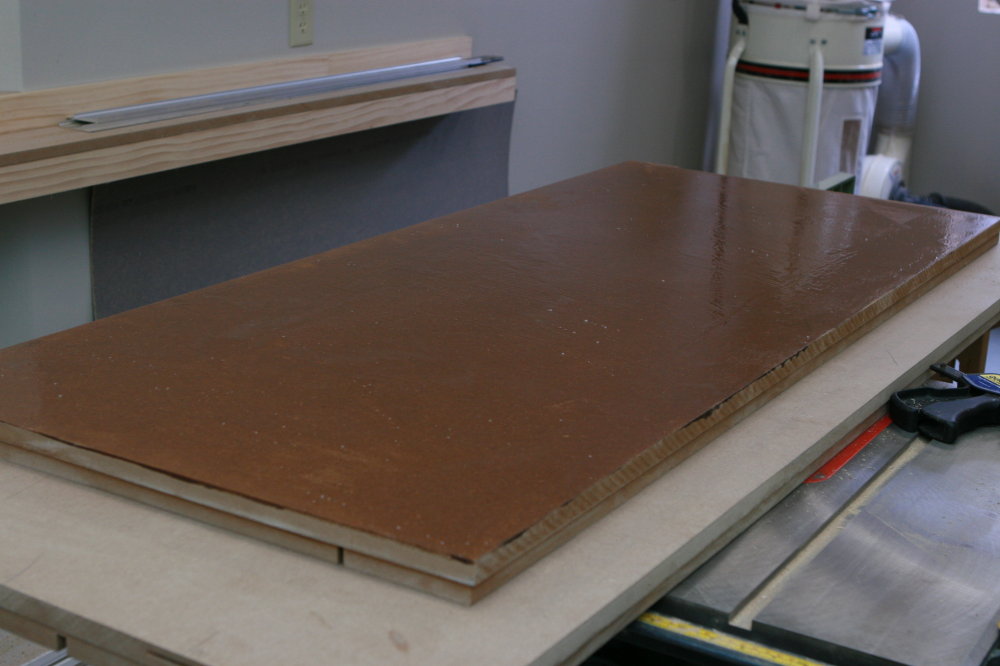

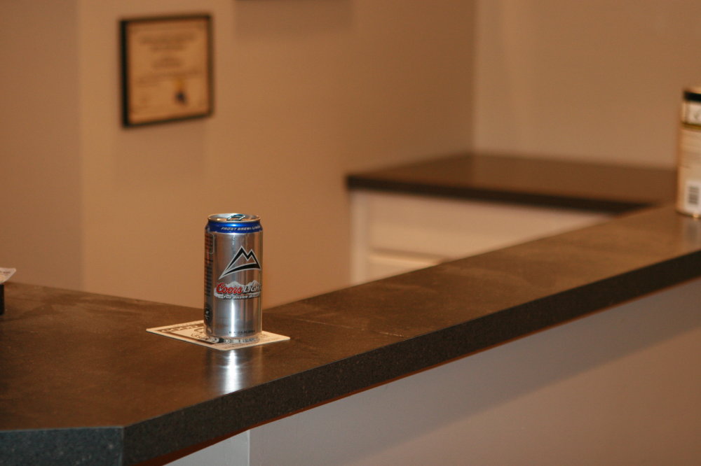

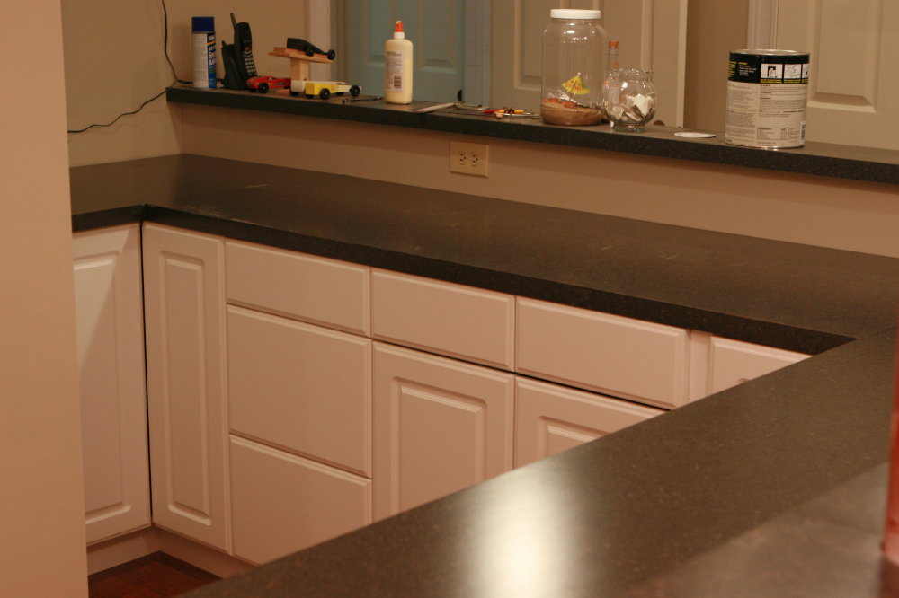

Yesterday was laminating day on the project. I started by cutting the laminate to rough length and a strip off the width for the edge. I have one beveled corner so I started there and got it all trimmed up. From there it's glue, dry, apply and trim. For trimming, I used a laminate trim bit (with bearing) in a router and a hand file for final cleanup and edge dress. I was able to get all three sections glued up at the same time, needless to say my shop was crowded and the smell was somewhat overpowering.
All that's left in this area is a bit of backsplash, knobs, a sink, wrapping the poles with something and paint on the trim.

Gee Rob, all that hard work & the best reward you could do was a coors light?:eek:

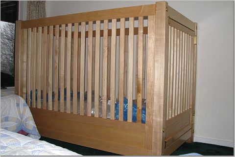

Looks great.:D :D :D My attic media room project has been slowed down while I built a twin size crib for my neice Katie to use in my in-law's condo (see attached). Took me all fall to build. Just put the finishing touches on it last weekend (had to "shim" the mattress so her feet don't get stuck). Not to mention smiley (pic 2). Add to that, I've been skiing (or attempting to) every weekend since Christmas:cool:
EDIT
forgot to mention that the crib took almost 200 board feet of hard maple to complete. I treated myself to a HDTV for the family room last week - It will tide me over untill I can finish the attic.

Very nicely done ! You dont have to look too hard to see an engineers mind at work coming up with ways to put things together :) Nice clean job. Although it looks like you had a couple of zigs with your router on your bolt pockets ;)
BTW, that stuff your using on your laminate is highly flamable ! No sparks or open flame near those fumes :eek:
