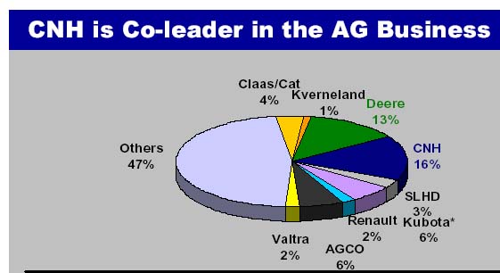

~from Fiat Group/New Holland Corp. Report to Shareholders-May 2001~
Claimed Worldwide Market Share for year 2000
"You are what you eat, drink, think, say and do..."
