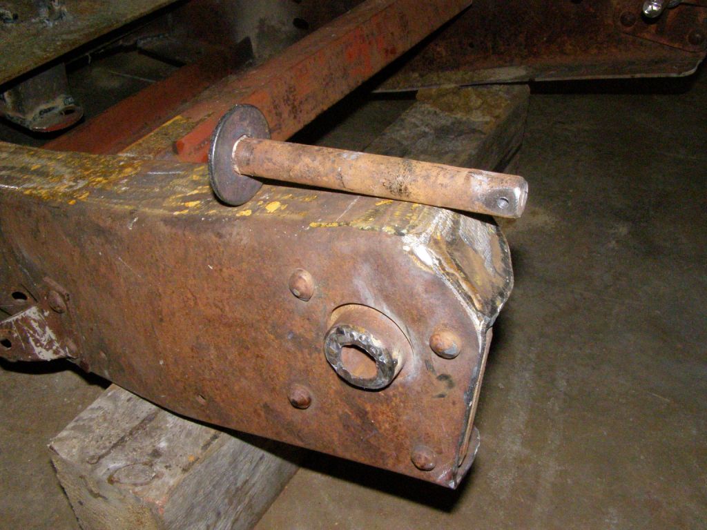

I know very little about cast iron, other than the fact you really cannot weld on it too much, without temperature control on the object (i.e. oven) and some pretty soft mig wire. Is the original front pulley made of cast? Could you center another sheave on it and weld it together?
The photo is the truck spring shackle bushing (cast) with 1 inch conduit welded into it. This worked better than the thermostat housing I tried to repair last year (also cast) by welding the fracture with my MIG. When it cools, little cracks and fissures start to happen as it cools too fast and thus ends up being more damaged. The bushing pictured never did any of that type of cracking at all. Hmmmm....
Yes, the original pulley is cast, and quite thin. There isn't much room in there either. Here's a drawing that I made of the original pulley.
There is basically zero clearance behind the pulley as it actually is inserted into the front of the engine. An oil seal rides on that portion. I just noticed that I left off a bevel that makes it easier to insert the pulley into those oil seals. Overall, I think the drawing is pretty accurate, though reverse-engineering was pretty hard. I did a lot of head-scratching to get the measurements, and I can't really say how accurate they are for sure. Take note of how thin that pulley is though. I've tried to show that with the dashed line on the lower view of the pulley. Those curves are all cast, too. There aren't very many good machined references until you get way to the outside of the pulley.
I couldn't weld it. I'm not a particularly good welder, though either. I find welding to be a very humbling experience, LOL! Though, I am quite persistant and eventually get what I want--it just takes a lot of grinding and "second" tries sometimes. . . .
