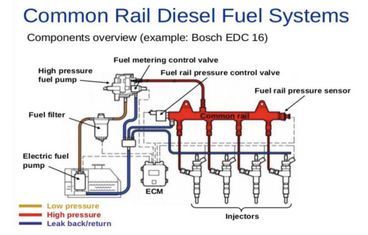

The later 7.3 liter Navistar Diesels don’t have a return line, nor do engines with common rail fuel systems.
To the best of my knowledge most diesel common rail fuel injection systems do have an excess fuel return;
an example is a around 6:33 in this video.
Also all the common rail systems I have had anything to do with also had a return from the lift pump back to the tank.
When the filters are replaced part of the bleeding procedure is to cycle the key on a few times for the lift pump to pressurize the fuel feed system and purge the air out of the loop and back into the fuel tank.
