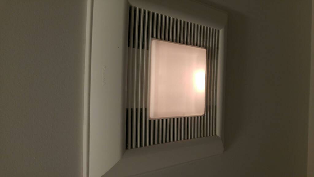

   / Bathroom fan exhaust vent #28
I posted installation pics on TBN a few yrs ago when i installed this fan.
