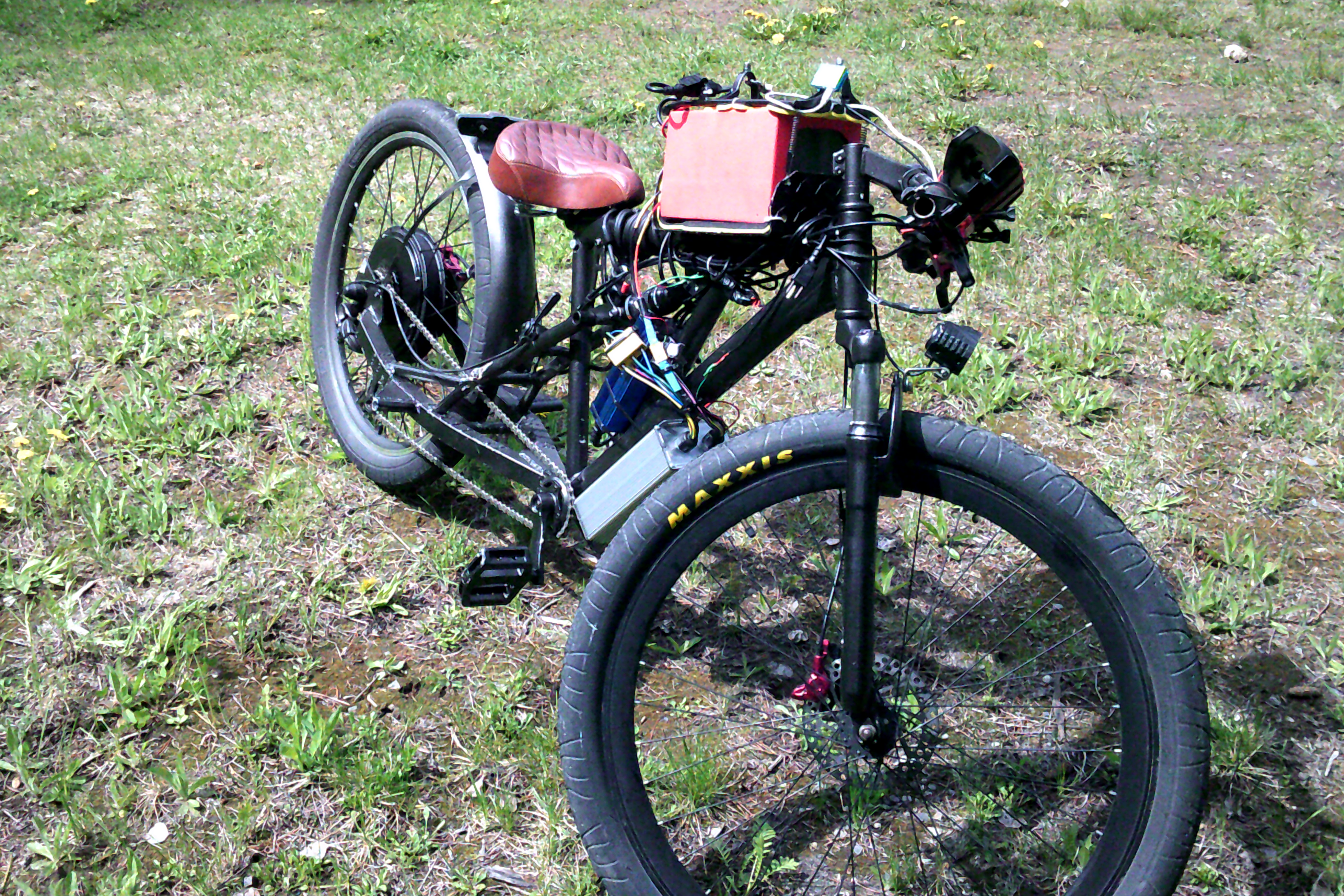

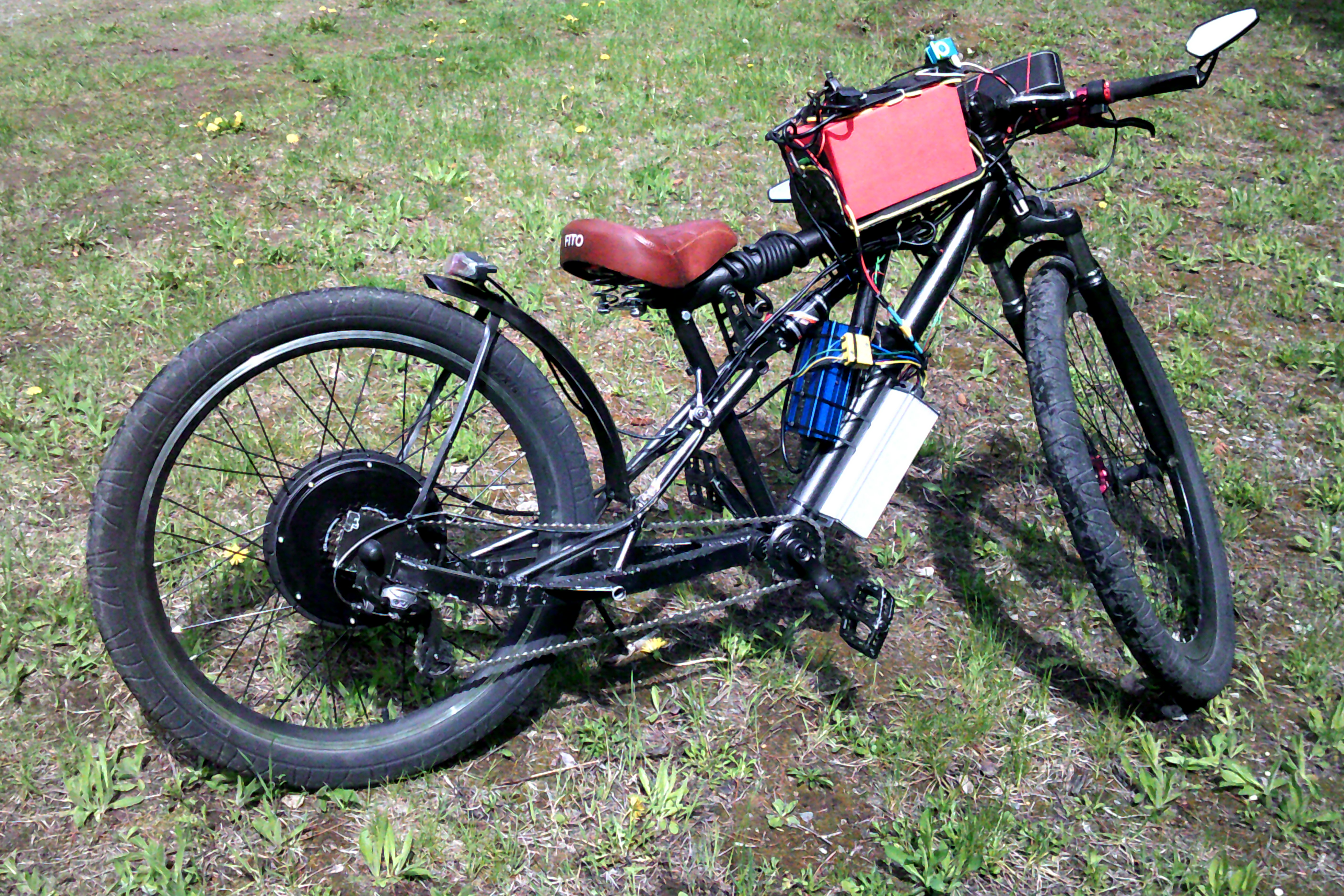

A few shots of a project my son masterminded...
electric bike built from several donors
stretched custom made swing arm from square tubing
front and rear suspension
35 AH Samsung 18650 battery pack
2000 watt Hub drive motor
2000 watt driver inverter
on board charging, lights, turn signals, stereo
30+ mile range

Your quote about batteries really becomes apparent with the aftermarket Li batteries when building things like the bikes.
There was a pretty steep learning curve and some real let downs on some of the battery packs that we started out with and built,
especially the 1 st couple sets.
I talked him into the 18650's after reading so much about how Tesla chose that as their starting point.
What was not as obvious was just how much over rating of amp hour and re-chargeability was going on on some of the off brand china batteries available on ebay. The 1st set lost about 1/2 of the amp hour availability after just a very few charges, this was using a decent quality LI charger.
I did get a real kick out of riding the bike, at 1 point it was set up to do almost 50 mph.
