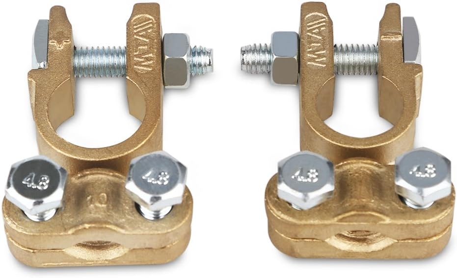

I have a 2011 LS R3039 tractor. I purchased used and it appears to have steal cable ends and they are always getting rusty. I would like to replace with new ends, any recommendations? Have seen copper, lead-antimony alloy and others? Thanks!!
My steel ones fell apart. Had to cut the cable back to get to good copper. .I use these ends from Amazon. Have bought them twice now. Corrosion resistant, universal fit, reasonable price. The ones I got were WaterWich Marine Battery Terminals.
But the real cure for battery post corrosion is an AGM type sealed battery.
