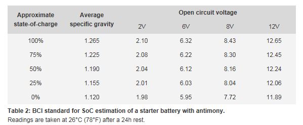

How do you check a sealed top battery with a hydrometer? Load test after a full charge cycle is the only way to verify the condition of a battery.
OP has load tested battery, it was "not bad".
I went through same thing last winter. First a weak start, then needed to be pre-charged to start, sometimes, depending on how long it sat. Load test was ok. Then I'd complicate the analysis by topping off battery acid.
A new battery was the answer.
/ Battery Condition
#22
Just an update. went out this morning to check on the beast. Disconnected the charger and metered the battery and go figure, magnificent charge. Checked condition of frame ground and all was tight and clean, no corrosion, etc. Jumped in, let the glow plugs come up and gave her a crank. No where near her best performance, even struggled slightly.
After all of the great discussions here, I decided I am going for a replacement battery. I think Coby's experience above is a perfect summary of my own experience recently. 34' here today with wind chill, winter is coming and all indications a battery is needed sooner than later.
Will be a few days but I will update this posting once I get the battery and install it.
Thanks again for all of the feedback, appreciate same.
