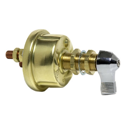

One like this would be plenty for a tractor, we have these on just about every truck we have and never any issues with them. Easy to mount and don’t take up a bunch of room.
M-284 Series - Battery Disconnect Switches from Switches - Littelfuse IMG_0111.JPG
