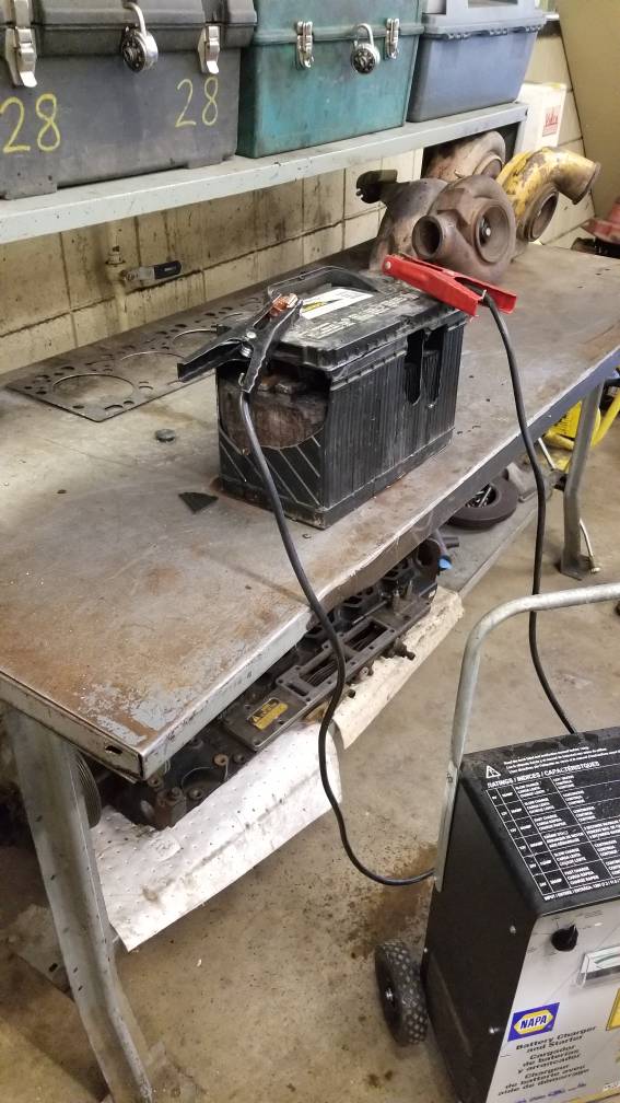

Yesterday, two of my friends at tech school plugged in a battery to charge it. It exploded. We dont know how but the terminals are on correct and we followed all safety procedures. Luckily, everyone who was close to the battery had safety glasses on and got to the eyewash station immediately. One kid got a deep cut on his ear. Sounded like a 30 06 went off in a echoing shop 20181025_132528.jpeg

Almost everyone,(me included)plugs in the charger then connects the clamps to the battery. This is really wrong. You should connect the clamps from the charger to the battery first, then with the power cord fully extended so you are maximum distance from the battery, plug in the charger. OR even better, plug the charger into an extension cord then go plug in the cord, that way you will be far enough away to be completely safe should the batteries hydrogen gas explode.
I have never seen a battery explode while using a charger, but I have seen them explode when using jumper cables.

Same thing happened to my BIL Shaneard minus the wrench across the terminals. I can think of 2 possible causes...a buildup of hydrogen gas ABOVE the battery ignited by a spark at the jumper cables or battery charger clamps when applied. #2 a buildup of hydrogen gas INSIDE a cell of the battery ignited by a flake of crud between the plates that may be exposed by a low electrolyte level in the cell.

Welcome to TBN and the forum. From looking at your picture - its very lucky that somebody didn't get acid burns.

OP - might post this in the safety forum - good picture.

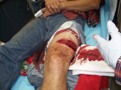

Pictures like that and this
stick in my memory.

You can also do that by welding on equipment with the battery connected. I'd guess there was good mixture of oxygen and hydrogen in the battery, the charger was plugged in and energize so when clamping it on, caused a spark and bang.

An old time battery rebuilder told me if the electrolyte is full to the top... a battery has no room for hydrogen to accumulate and it can only explode of the gas is inside.
