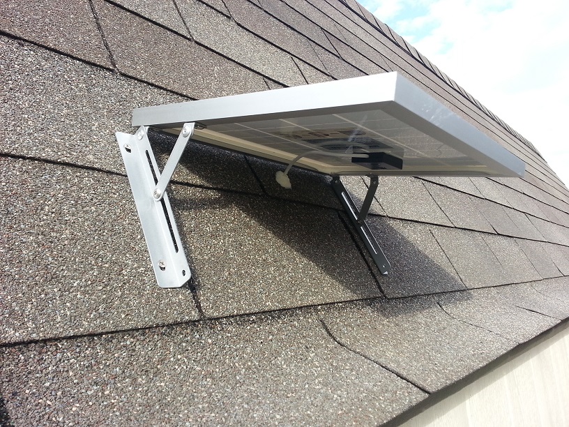

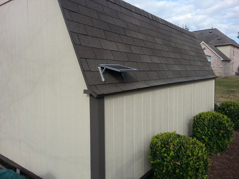

Alright - I settled on a very well reviewed 10W solar unit from and outfit called Micro Solar. Picked it up on Amazon and delivered in two days. It appears to be well built and sealed nicely. Installation was very easy with only four screws and a hole for the cable to run into the shed. (It's a nice 16.4' long which is handy...) My unit has adjustable mounts unlike the picture in the listing. I like the ones I received better.
I have included a couple pics of the install and the spec sheets below. It comes with everything you need out of the box including a controller built into the lighter plug. You can use the supplied alligator clips, but I picked up a Delton kit to permanently mount a pigtail plug to the battery, and also a Delton adapter to use that plug and then mate with the supplied controller's male lighter receptacle. 15 minutes to install and all the lights flashed the right sequences when connecting controller to battery first, and then to the panel. I'll update if anything goes sideways with the product.
Here are the items I picked up:
Main Solar panel and standard kit: https://amazon.com/gp/product/B00EB3OC9W/ref=oh_aui_detailpage_o04_s01?ie=UTF8&psc=1
Permanent battery mount: https://amazon.com/gp/product/B000NCOKZQ/ref=oh_aui_detailpage_o04_s01?ie=UTF8&psc=1
Quick connect adapter: https://amazon.com/gp/product/B0041CDPQO/ref=oh_aui_detailpage_o04_s00?ie=UTF8&psc=1
South facing - will need to adjust down for winter angle.
Goes from zero degrees, (horizontal), down to angle of shed roof which is about 65 degrees. Houston winter angle of 45 degrees should be fine...
Small hole to fit cable with connector through into shed. That cable there is over 16' long. Only four screws, a hole, some clear drying silicone sealant, and it was done...
(Also connection of quick adapter to battery.)
All the flashing lights checked out and it started taking a charge even with sun setting and cloudy skies.
