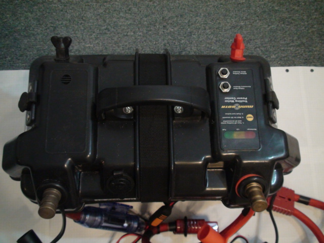

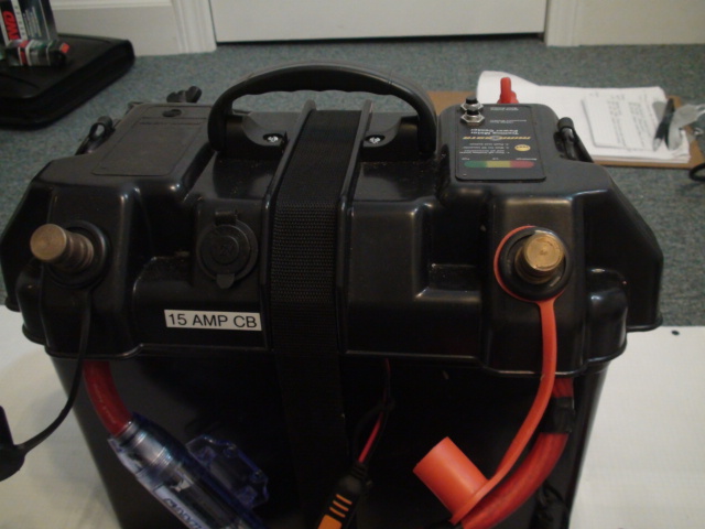

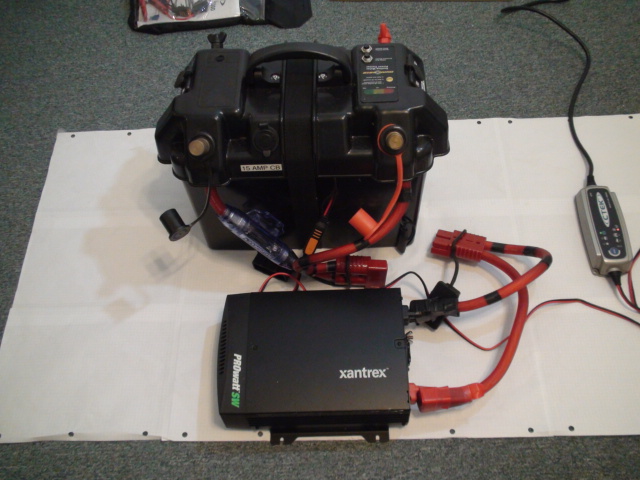

I had a couple bad experiences with those portable power units, so designed my own using a Minn Kota trolling motor battery box as the base unit and separate AGM in each of my vehicles, setup with in-vehicle charging, NOCO charging posts, 12 VDC outlets with fuses and circuit breakers, etc., along with a sine wave inverter connected through fused, external terminals. Also have 20' long, 2 gauge jumper cables in each vehicle. And yes I have had to use them for myself :)
I just pulled the unit out of the Jeep for pictures and decided to charge it since it has been sitting unused for months, since being decommissioned from the solar battery charging configuration. Using a CTEK 3.3 amp charger, the battery was topped up within 10 minutes from its long storage. It is a Sears Platinum I am testing as it has 10% higher energy density than the equivalent Optima. So far it is working out well but has yet to see the extremely deep discharge cycles my Optimas have been through.
Power pack photos in case anyone is interested in building a really high performance emergency power/jump starter unit:
View attachment 348501View attachment 348502View attachment 348503View attachment 348504
