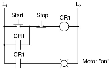

As others say, you're probably good to have charge running when genny is running.
However you could always run power to charger through a relay that drops out when the power goes off and has to be manually reset.
Remember, the charger is off when the genny starts during a power outage.
Something like this:
Where the charger is wired like the "motor on light" (circle with "rays") shown at the bottom right of the drawing.
The "start" button has to be pressed after a power outage in order to turn charger back on. Stop button isn't really required, unless you want to turn charger off when manually exercising the genny.
If your genny automatically exercises?.....uhm...don't know.....maybe there's a normally closed contact at the genny that opens and can be wired in place of the stop switch?
