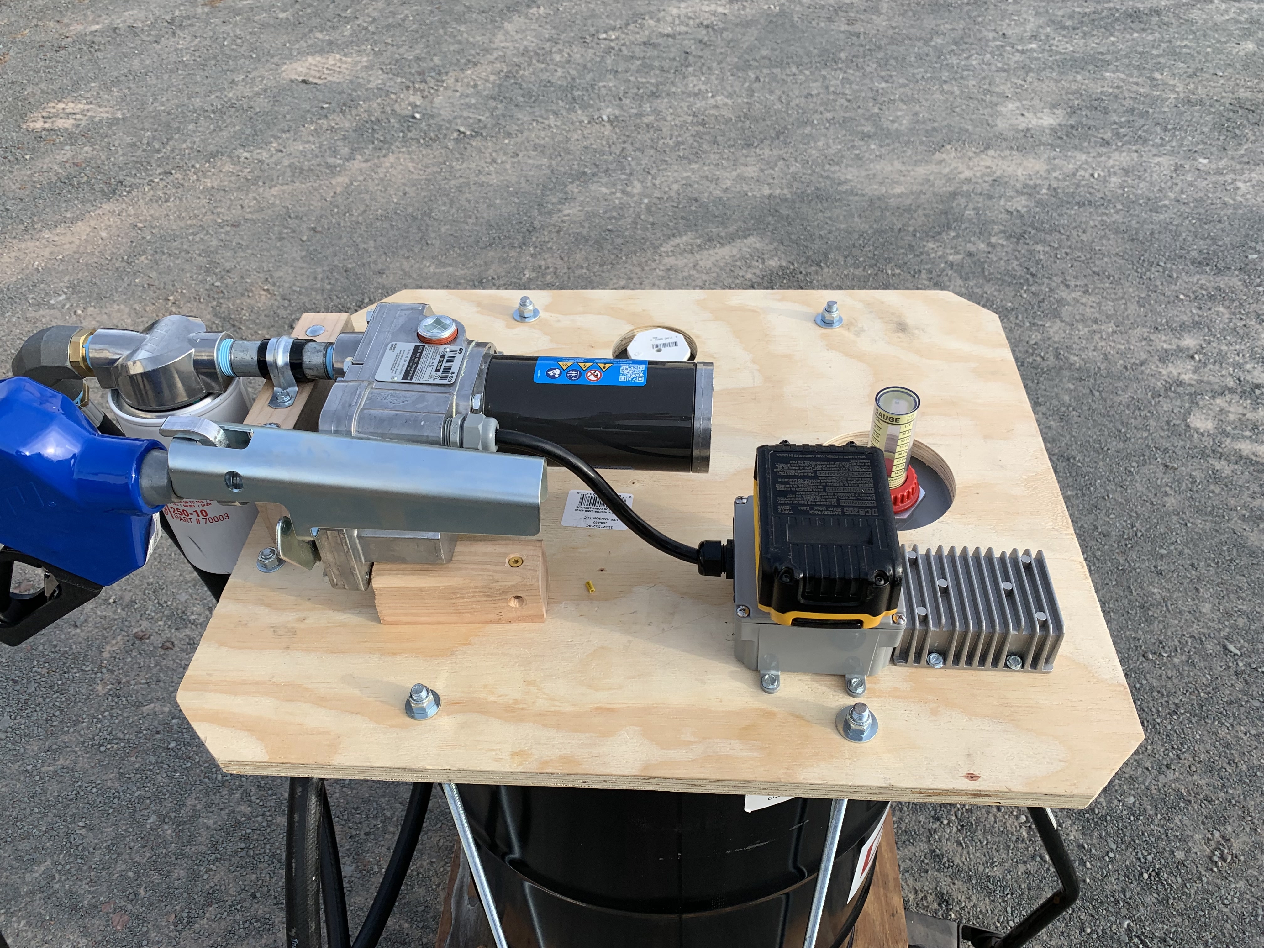

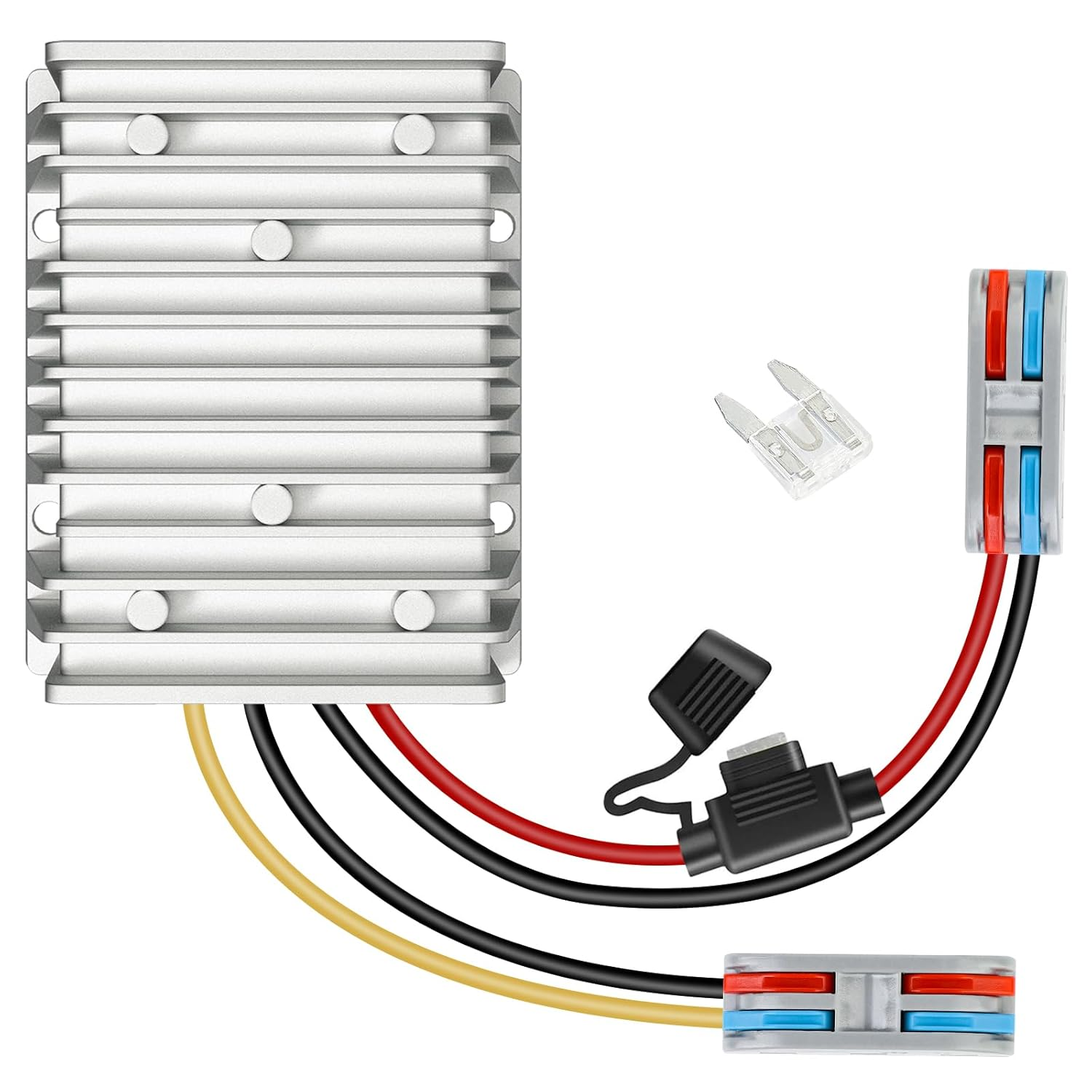

What's your Dewalt battery voltage? I love the idea, but don't want to put 18 volts to a 12 volt pump.

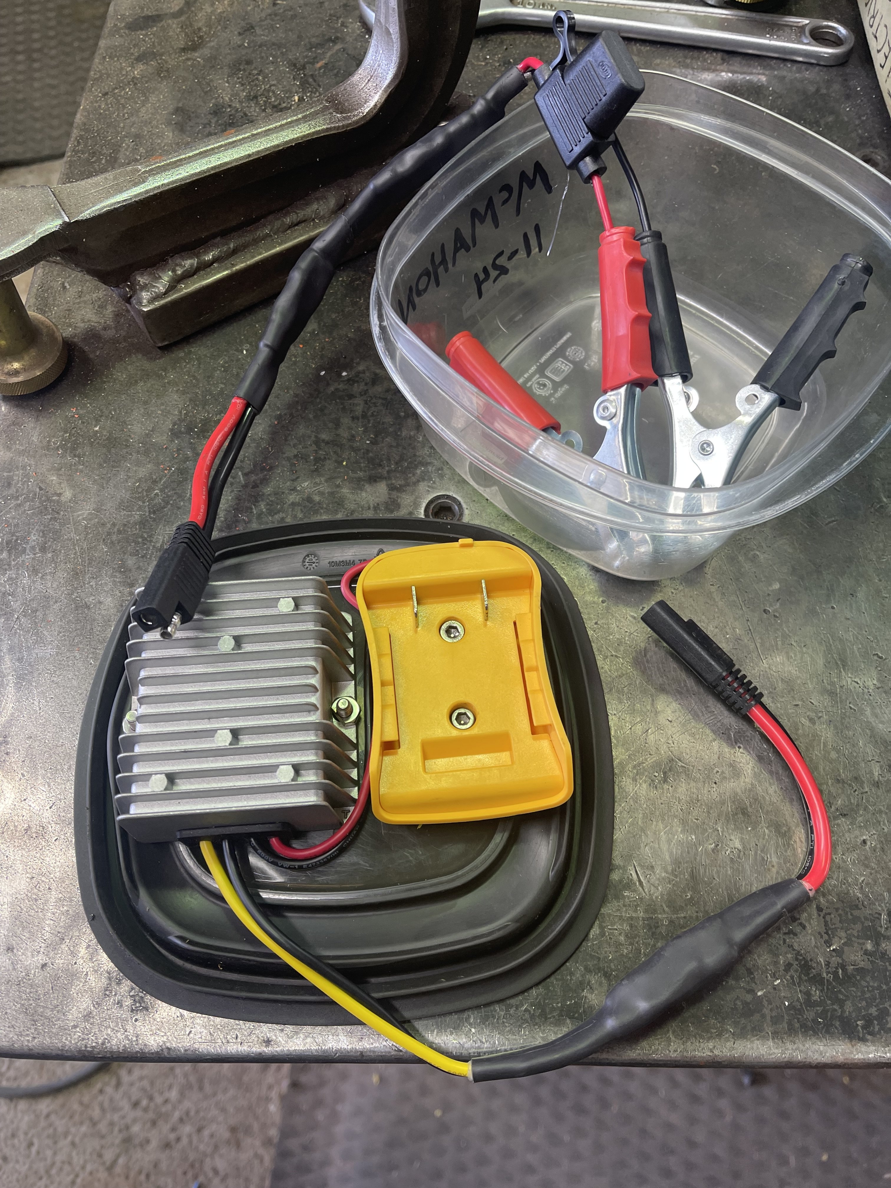

I used this regulator:
It will convert any DC voltage between 18 and 60 volts to 12 VDC up to30 amps.
I like it because it lets me use either my 60V or 20V DeWalt tool batteries.

@bdhs Thanks! That would have saved me a bunch of effort on my fuel pump. I put a 120V to 12V power supply into a sealed enclosure with sealed switches. Way too complicated. I think that is I will repurpose that power supply for another use and use your solution.

I have the same tank, but John Dow. I used a 12 volt battery, but am kinda screwed when the battery fails. I like this idea, plenty of cordless tool batteries around. And, I won't need the battery tender. Thanks for the design, I just ordered the regulator, now just need to order the battery adapter.

I like your battery setup, but I think I go through too much fuel in the spring and summer to power my pump with tool batteries. What I have been doing lately is leaving the 30a charger on the large lead acid battery while fueling. The pump runs faster than normal, and the charger goes to float voltage immediately after the pump shuts off. Do you think I am risking damage to the pump motor doing this?
   / PTO Generators - Any Favorites? #31
Don’t think you are hurting your pump motor. Low voltage more of a concern than charging voltage.

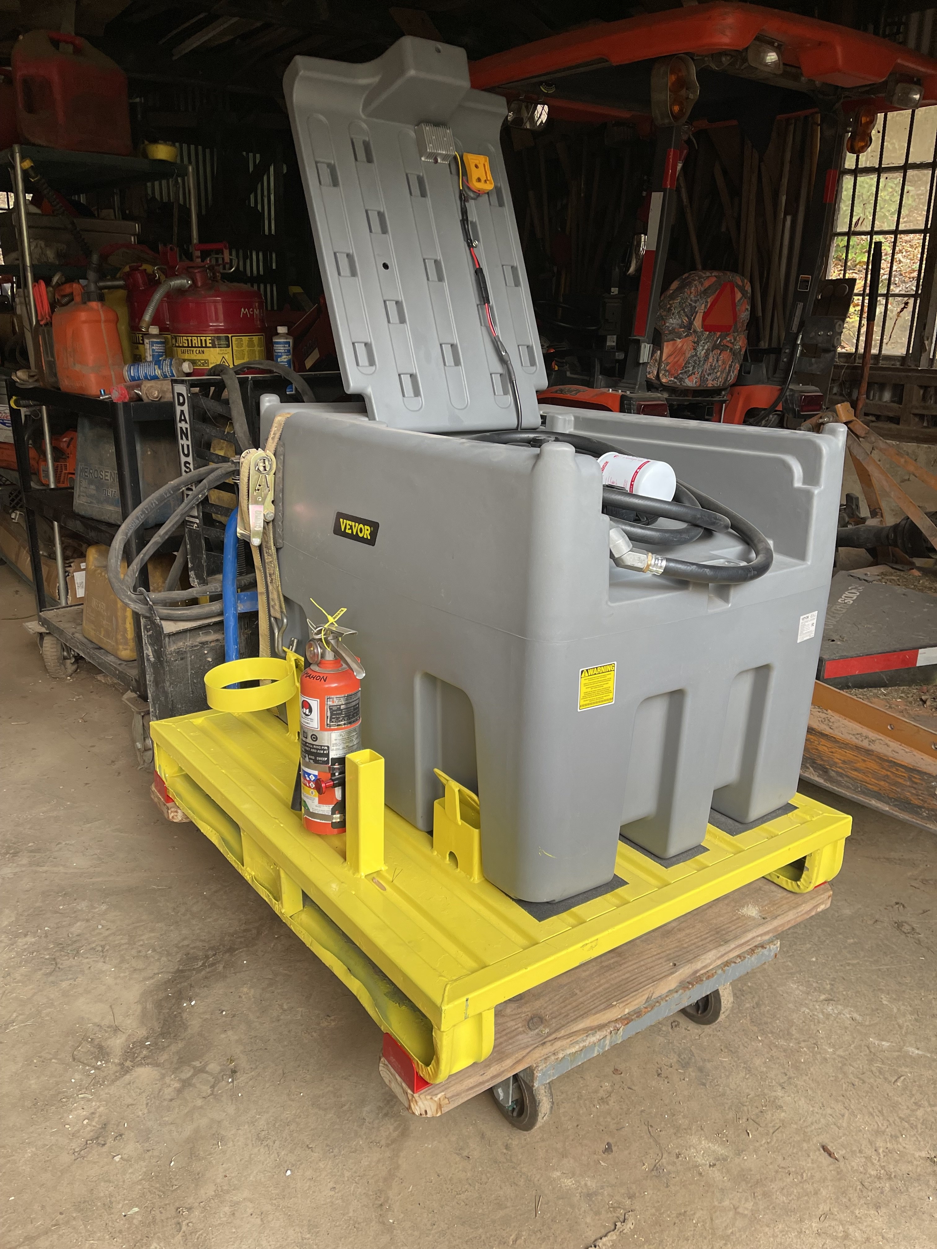

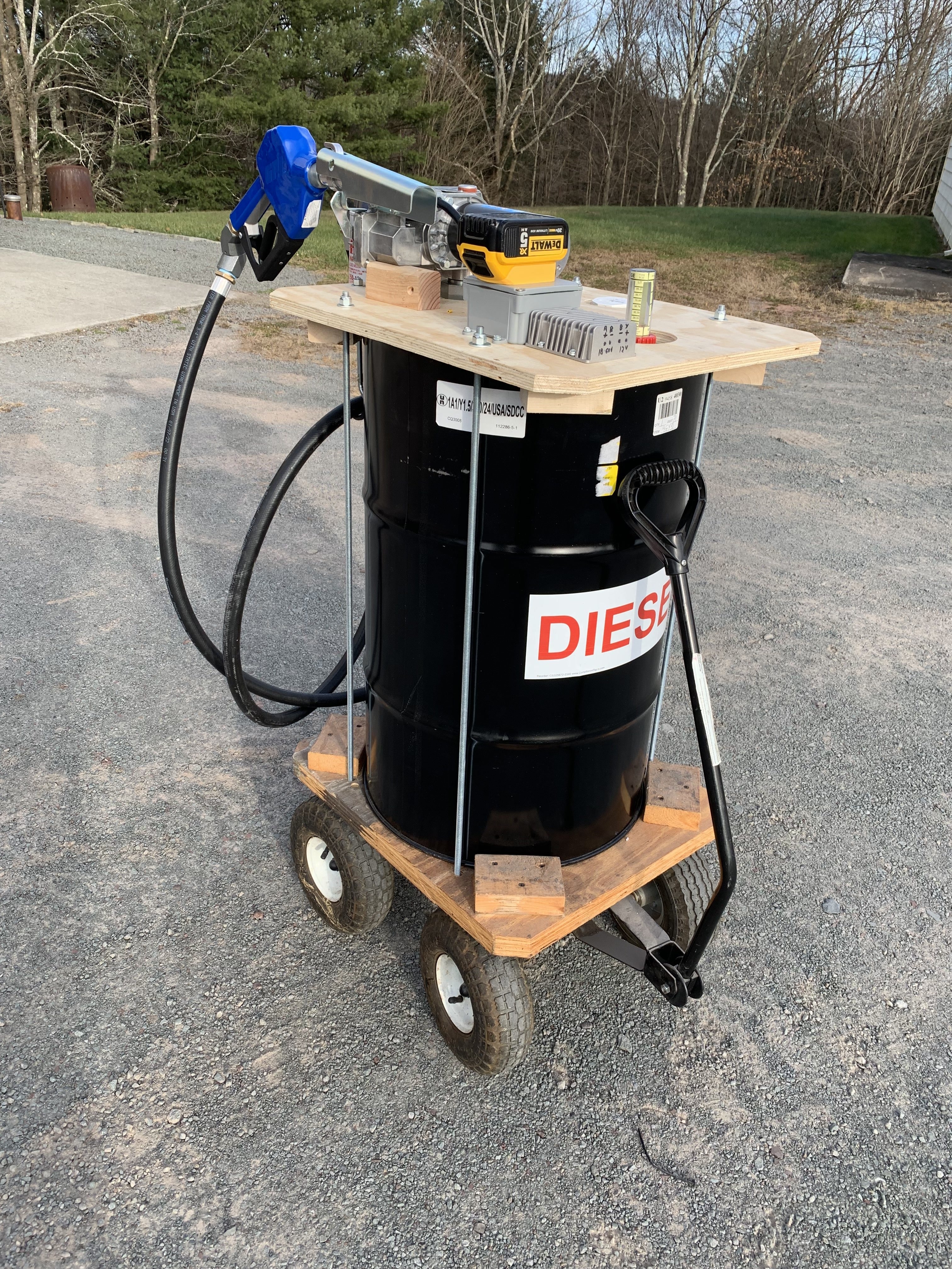

Pumps usually have a duty cycle. The Vevor pump is 10 minutes. That’s 110gallons. I tested for 5 minutes and drained less than half of a 5ah dewalt battery recirculating back to tank. In theory could dispense the whole 107 gallons on one battery pack. Don’t have power in tractor shed so the rechargeable battery trick works well. Can easily switch to battery clips and use tractor batteries if needed.
From an engineering perspective would like to see data of actual under load voltage and amps these battery converters deliver with this application. An incorporated digital voltage gauge would be a nice feature.

I doubt you'll damage the pump for the short period of run time it takes to fill a tractor tank.
I was doubtful about the capacity of these 5AH tool batteries at first. I was surprised to find I could empty that 30 gal. barrel and still have half a charge left. I have a couple of 12AH batteries I use in my mower, and was prepared to use one of those but the 5AH work just fine.
I don't usually leave the battery on the pump in the unheated garage. I take one off the charger in the shop and put it in my pocket if I need to pump fuel. I treat the pump just like any other cordless tool.

There are versions available with battery gauges/voltage meters, but as they aren't built in to the battery, I would not place much trust in the capacity. Bottom line is that I am not sure it buys you much extra information.
