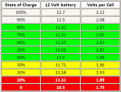

Here is a battery charge chart. If it reads 12 volts, it is not even at 50%

Got in my tractor moments ago, and it cranked once then nada. Turned the key, and a rattatatat sound emitted, now no sound at all. The key was NOT left on. There are barely 500 hours. Can I try to jump it with my diesel truck? Should lights on dash appear when hooked on with jumper cables? I don't get it? I've searched this forum..... Any help is appreciated.
You really need a voltmeter and good probes and clip leads. Otherwise youre in flail mode. You can get a cheap digital one for under $10 @ Harbor Freight. With it you can tell what V you have in key conditions. That will quickly lead you to the problem area.

Sounds like a bad battery to me. The ratatatat was most probably the last gasp of the battery which just had enough juice left to activate the starter solenoid....but not enough to turn the starter.
Yes, you can jump it from any 12 volt car or truck just like you would jump any other car or truck. Absolutely no problem with doing that and no difference from jumping anything else. It makes a good test, because if the battery went flat for some other reason than just being too old...like if you left the key on.....then letting it run for half an hour at a medium fast idle ought to charge it back up and you are good to go. Alternately, if the battery really is on it's last legs then chances are good that after you run the tractor for that half an hour the battery will hold enough charge for ten minutes or so to start a warm engine. If it does that you will know for sure that the starter is OK and it is new battery time.
Yes, the dash lights should light up normally when it is jumped. Once it is jumped and it starts, disconnect the jumpers just like you always do and it should continue to run normally with all the dash lights and intstruments working normally. If that is the case then you know that the alternator is good......and since the starter worked fine when when you jumped it you are back to it being new battery time just like above.
As easy as those tests are, if the battery is 5 years old or older there's no real downside to just skipping all the tests and simply replacing the battery. I say that because number one I always suspect the battery first, and second....if you are dealing with a battery - particularly an OEM battery - that old then it's a pretty good bet that you will need a new one within two or three years anyway. So it's a pretty good decision to just go get a good battery and expect it will last you twice as long. For batteries, I like the AGM types. My personal favorite is the Optima Red Top.
