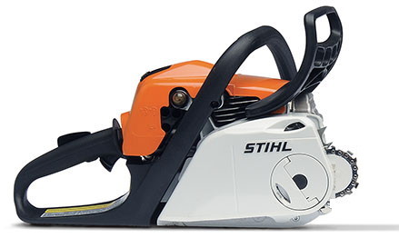

The small Stihl Chainsaws (3) is what they use... I was thinking for each 20 second cut the saw runs x 1600 trees there must be a better solution...
I bought a Stihl plug in and it is a fine saw but there were concerns using it in the rain and mud...
I can see a battery chainsaw could be idea and quiet!
