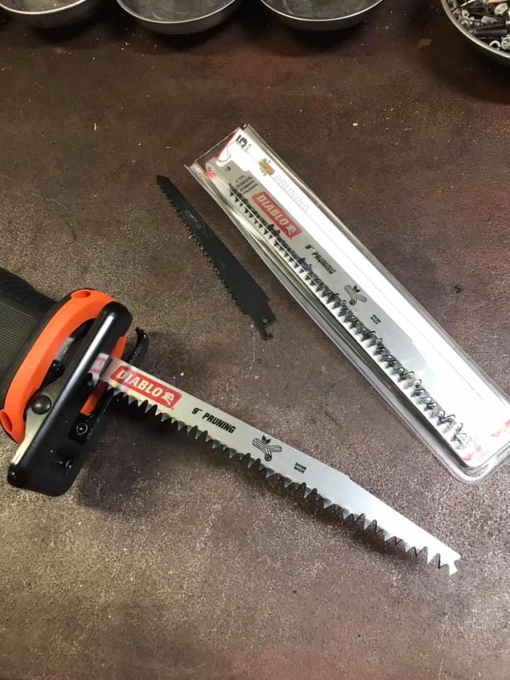

So many debbie downers. :ROFLMAO:
Why even be in the battery thread if you just going to talk down.
Every tool has it's place and man can not own enough of the right tools for the job at hand.
Wife saved me alot of work with that right there battery cutting the limbs up for smoker wood. I tried it with gas saw. Was just easier her way.
I hired a guy to help cut up a black walnut storm damaged tree. He had a sawzall with your pictured Diablo 9" pruning blade.
That setup cut up a storm. I was so impressed I bought a few of the blades and use them when I have just a few cuts to make. It's easier to clean up than a chain saw after just a few cuts.
