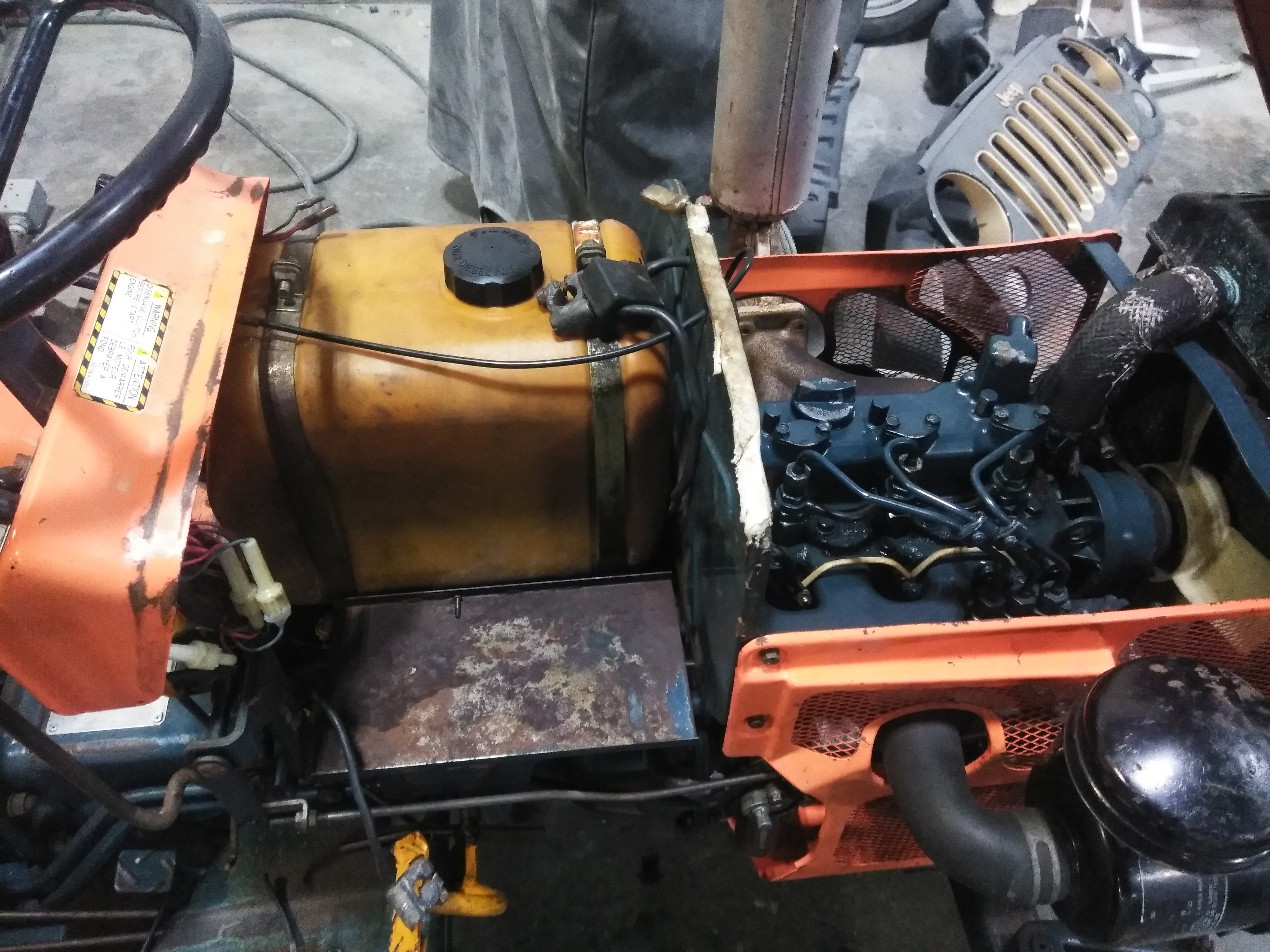

I don't have a battery hold down and I didn't know that one was supposed to be there I don't see any provisions for it?
The space for the battery is no wider than 5 in by 10 in Long by maybe 10 inches high there isn't a whole lot of room

Measure the size/height of the space you have, and get the best quality battery (highest CCA) that your Wally Mart sells.
That will be your best battery bang for the buck.
If possible, stay away from the little lawn tractor batteries, They are generally cheap junk.
You should rig up some sort of battery hold down. It must have originally had one.

On the battery... Car batteries are heavier and a bit larger than the small tractor batteries that your tractor had originally. The weight is actually an advantage as the front of these small tractors tends to be bouncy. But you have to strap the battery down tightly so it doesn't get loose from the bouncing and hit the radiator. The battery should ultimately be strapped to the rigid frame of the tractor. That's another advantage to the AGM type sealed batteries. Since they don't spew acid and fumes even when bouncing, you can use your choice of straps and battery box modification of wood, metal, or plastic without worrying about acid degrading things.
It's crazy that they didn't make that battery area just half an inch larger so that a car battery would fit properly, but they often didn't. If you just can't fit a car battery, get the best AGM type that you can find and it will last a few years. Again, it is most important that it be strapped down well so it doesn't bounce or slide around and endanger the radiator. BTW, these diesels don't require the battery power to run the motor - just to start it. Once running, the battery only runs the instruments and lights. Just about any battery will do that. More CCA (Cold Cranking Amps) is always better for cold weather starting - always a problem for diesels. Especially older ones. But if the battery will start the tractor in cold weather then it is sufficient. Car batteries are better, if you can fit one.

I like to have a battery secured, mostly in case the machine upsets and the battery shorts out. That could make an already bad situation, really bad!
