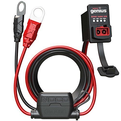

I know this is not a plugin for the Battery Tender, but I needed a new charger anyway .
I went with a NOCO Genius G3500 charger and a GC016 12V Dashmount Battery charger Plug & Power Indicator
I haven't had time to install it, when I do I will post some photos
