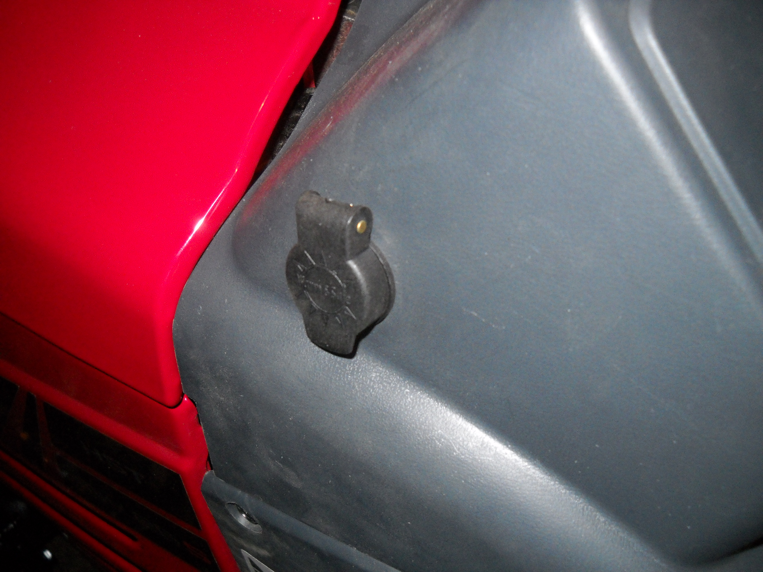

Just finished the install. Used the round style socket and mounted it on the left side of the instrument cluster. Worked out well.
Thanks to all for the info.

I thought about placing the connector in a rear facing position so that it would automatically un-couple if I drove off but that would have made the socket unusable for other functions. Instead I opted to place it where it was very obvious and the wire would be on the left side forcing me to climb over it if I neglected to unplug it first.
