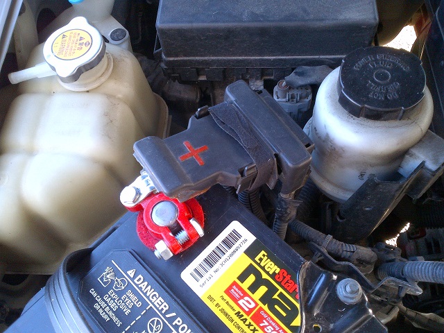

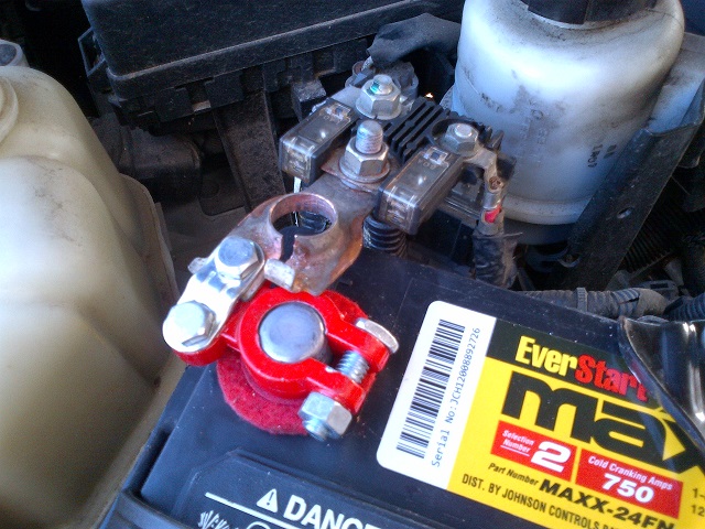

@$#&%*! battery terminal on 5035
   / @$#&%*! battery terminal on 5035 #11
Replace the entire clamps and be done with it. I have done this with a good many of my family's vehicles and we never looked back. Some of the new battery clamps are nothing but cheese and I usually dump them on the first battery replacement.
   / @$#&%*! battery terminal on 5035 #12
^What he said.^
I'd hack saw the facotry lugs off and install something like these. 76806_3.jpg
Then crimp and solder some proper terminal lugs to the cables like these.
Slip some heat shrink over the joints then button it up.
   / @$#&%*! battery terminal on 5035 #13
At least it isn't a tin foil like thing that Toyota puts on its batteries. That seems to be the main downfall of Toyotas.
On them, you cut the end off the cable and replace the end or replace the whole cable.
Ralph
Agreed - those stamped terminals are pretty turdy. I'm sure they're cheap to make though. The worst is vehicles that have one of those with some kind of integrated fuse doo-dad on the positive terminal. Had to rig this up on my Frontier when its clamping mechanism self-desctructed. Flattened out part of the stamped terminal so I could attach it to a real cast terminal. :D
