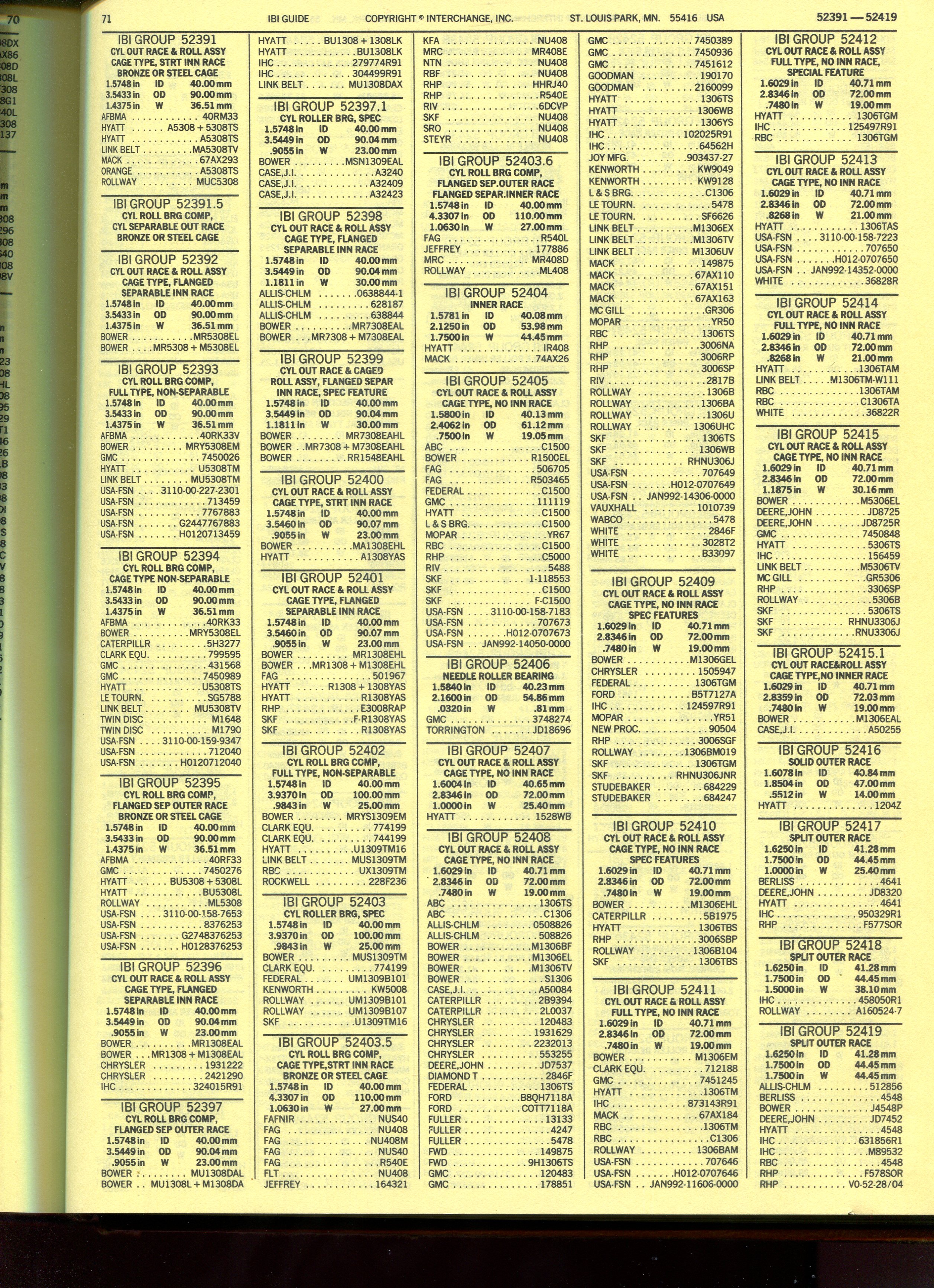

A quick look in my big bearing cheat book indicates that 13133 is a Fuller number, and corresponds to group 52408.

Thanks guys, and the 52408 helps
