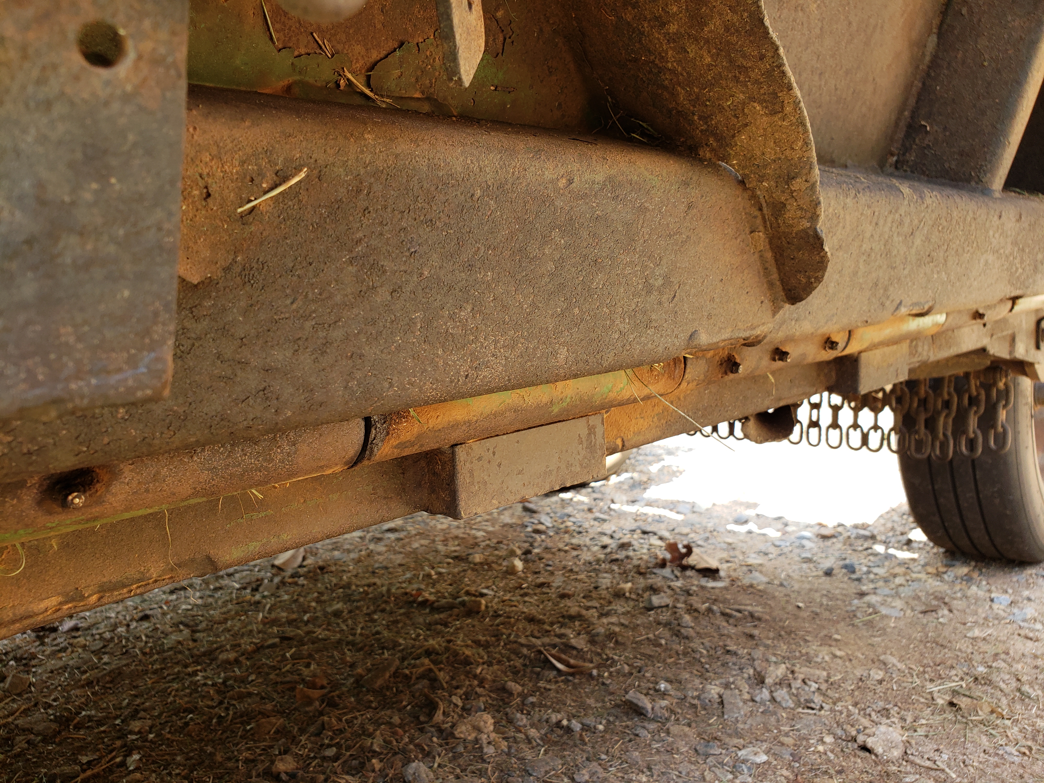

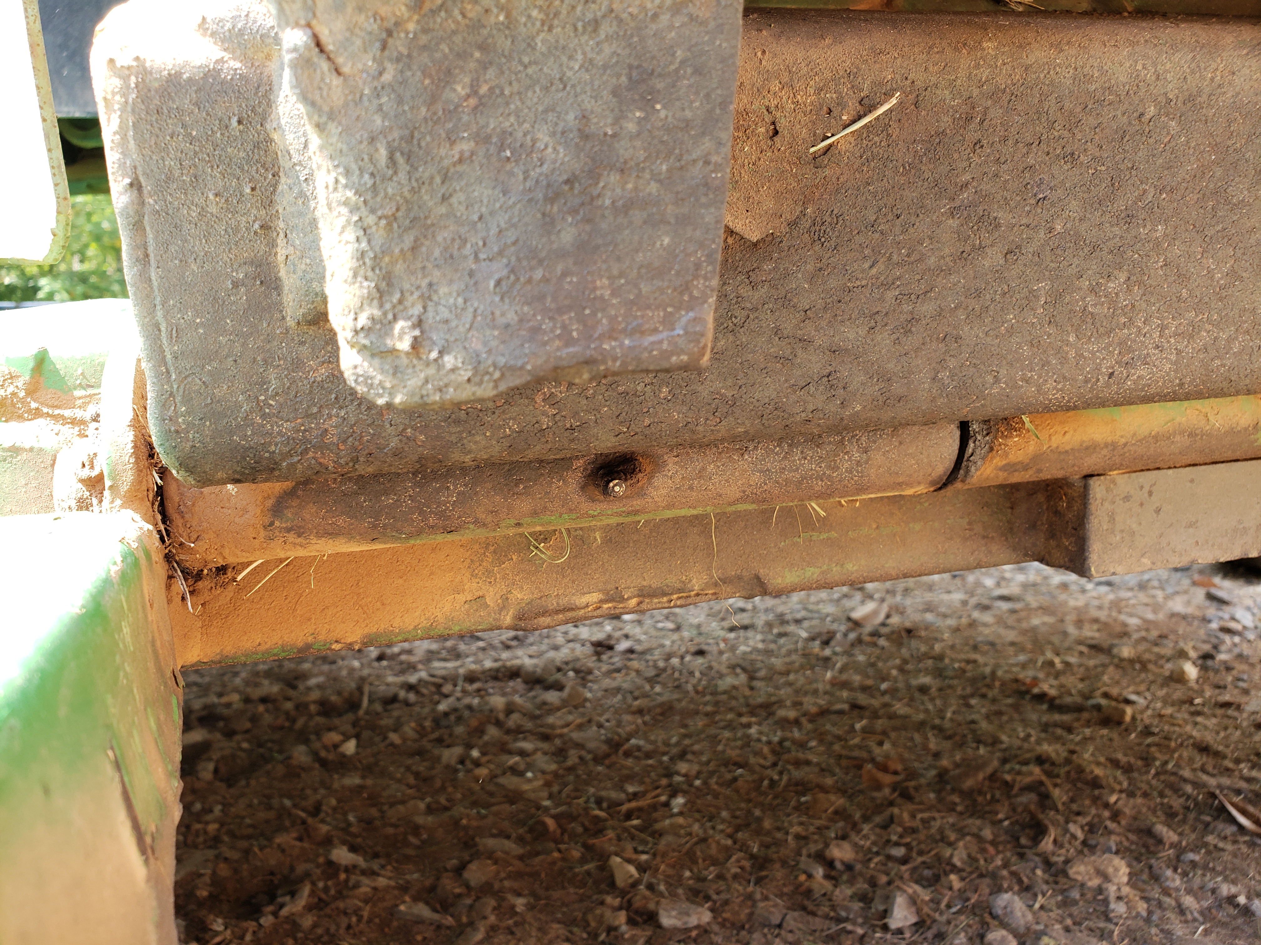

Just thought I'd update, I drilled and tapped all the hinge sections on the "wing" side of the mower tonight. IIRC, it was 4 sections per side, so 8 total holes/zerks that had had to make. It actually wasn't that bad, I got a really high end tap and a 10 pack of cobalt bits (used 2). Went pretty darn well, no real drama. Well, except for one hinge. I simple could NOT get it to take grease. I have a joint breaker/zerk cleaner, filled that with MMO and beat the heck out of it into the joint. It just would not go. So I tapped it two more times, one on either side. And I was finally able to get it to take grease. Yes, I even had an oxy/propane torch on it to see if I could loosen it up a bit, I've never seen something like this before. The joint would move, it just would not take an ounce of anything. I'll take pictures of the finished product when I get a chance, all the zerks are on the "down" side, you have the lift the wing to see them. Not ideal, of course, because they are somewhat in the line of fire down there, but there's no way to put them on the top because that area gets totally closed off when the wings are closed. I didn't really have any time to play with it to see if it's improved. I kind of doubt it yet, there's so much grease/pressure in there right now, it still felt pretty sticky when I pulled the wings down to move it around. But I do think that this will be the real fix for it, just take some time to get the grease in and distributed well, and, of course, for all the rust to wear down and get everything moving easy.
Overall, if I didn't have that one nightmare hinge, this wasn't a bad job. Maybe 2 hours start to finish, probably could do it in 1 if you had a good bit/tap sitting there and were ready to roll on it. Get a good tap! I have cheap ones and this metal would have eaten them, no doubt about it.
Oh, also, just for completeness, I only did one set of the hinges. There's only one "moving side" on each wing, it's only the hinge section that's on the wing that actually moves. I might do the other side too at some point, but it's not entirely necessary, it won't make the wings lower easier. It would help, of course, if I need to drive that pin out for some reason. But, honestly, I suspect the other side (the one that doesn't move) is so seized in there by now that if I need to drive the pin out it's a lost cause anyway. Thermal lance time!

Just got a case of it heading this way, seems like that would be useful on a few different things that I need to grease/keep protected. I use a lot of silicone spray on things that I don't want to rust, but also don't have a fitting to grease, so I'm sure I'll find a use for it. But, of course, first use will be shooting it into the hinge on the BW to see if that'll loosen things up further. The joints are greased well now, but I'd like things to move a little easier still. The grease in there is a high moly/high temp grease, it's pretty tacky, so, hopefully putting something with less tack in will make everything move even better.
I'm gonna get some pictures of what I did for others who might have this problem, it really wasn't that bad an operation if you have all the right tools (good taps and some cobalt drill bits in the right size). Much easier than I expected, if I didn't have that one awful joint (where I had to put 3 zerks to get it to take grease!) I would have been in/out in maybe an hour or 2.

Just wanted to update this thread with some pictures of the "repair". Here's how and where I installed the grease zerks.
