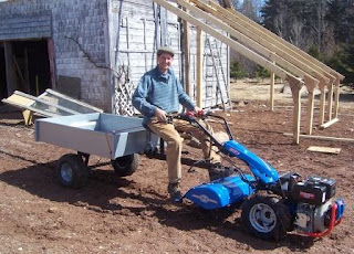

EDIT - I googled "BCS trailer" and found a few pics of one attached -

BTW, my trailer looks a tad meaner than that little guy.....though I just realized that it's actually 1,250lb and not 1,500. Still very cool and it dumps and swivels and can accept side rails to heap a load higher.
Now that I look at the difference between the BCS cart and mine, the problem might be that my trailer tongue is lower....below pic is similar, but mine has a curved axle for a ton more ground clearance.

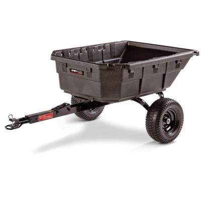

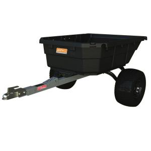

How is that cart working for you? I was wondering if you got the one with the extra wide tires or not (see attached images from the HD site). Also, how does your 853 handle this cart with an average load and you riding on it? I have an 850 with the 5x10 wheels, but I'm concerned about it losing traction easily. Thanks for your input.
