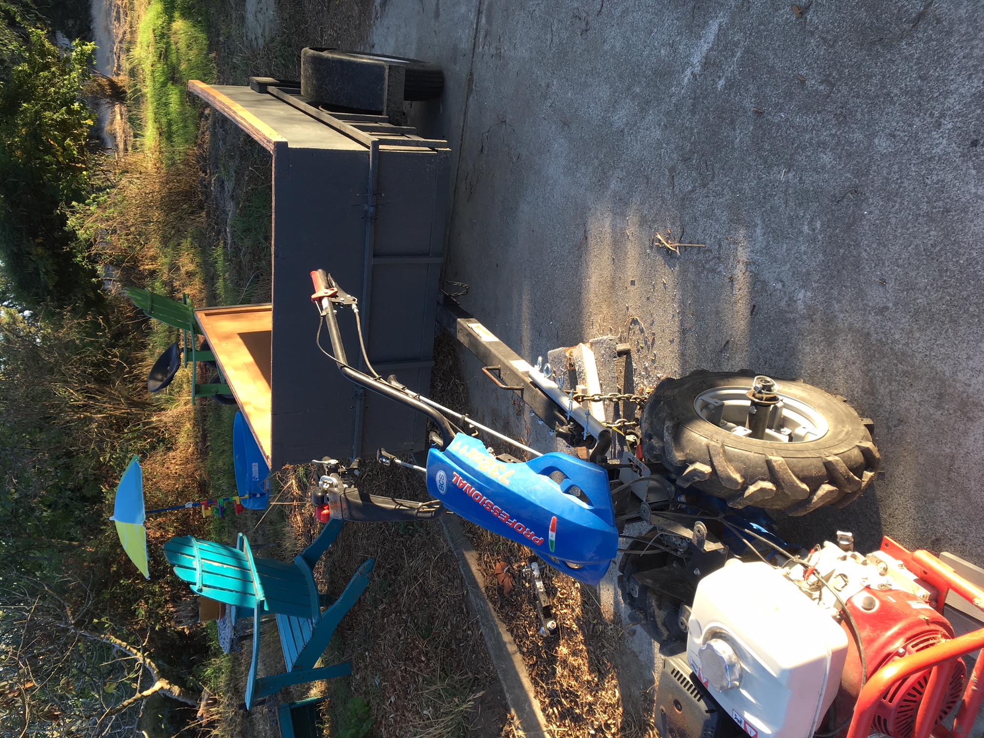

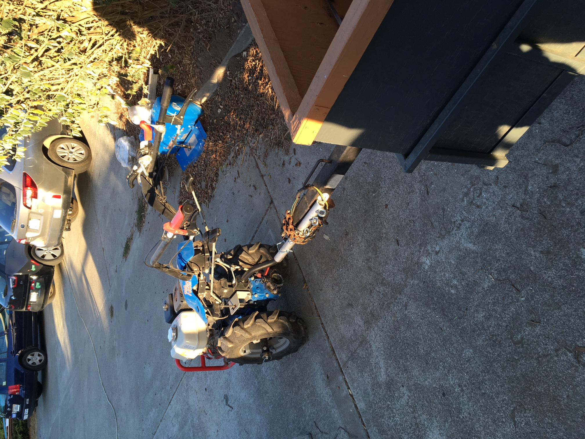

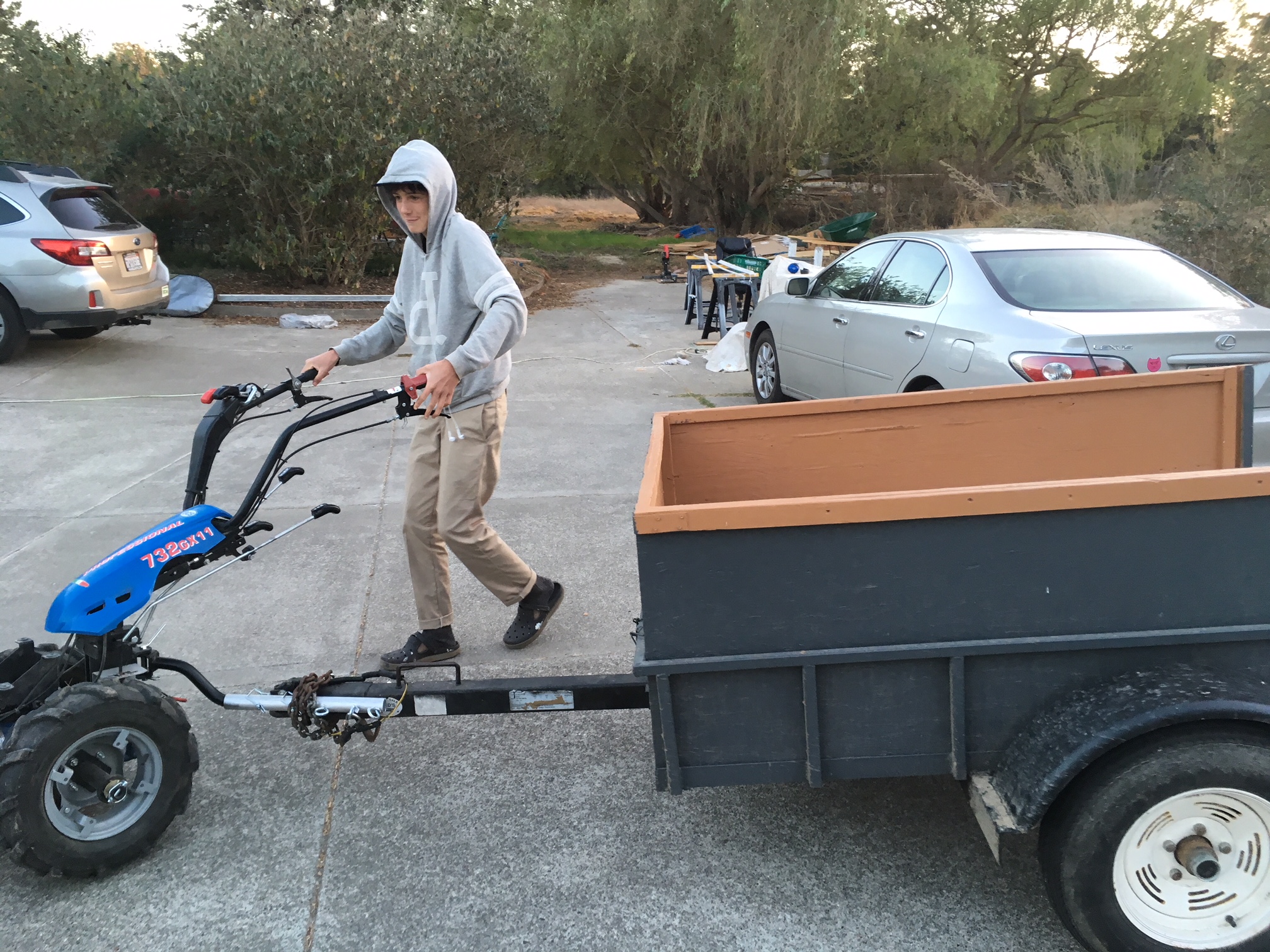

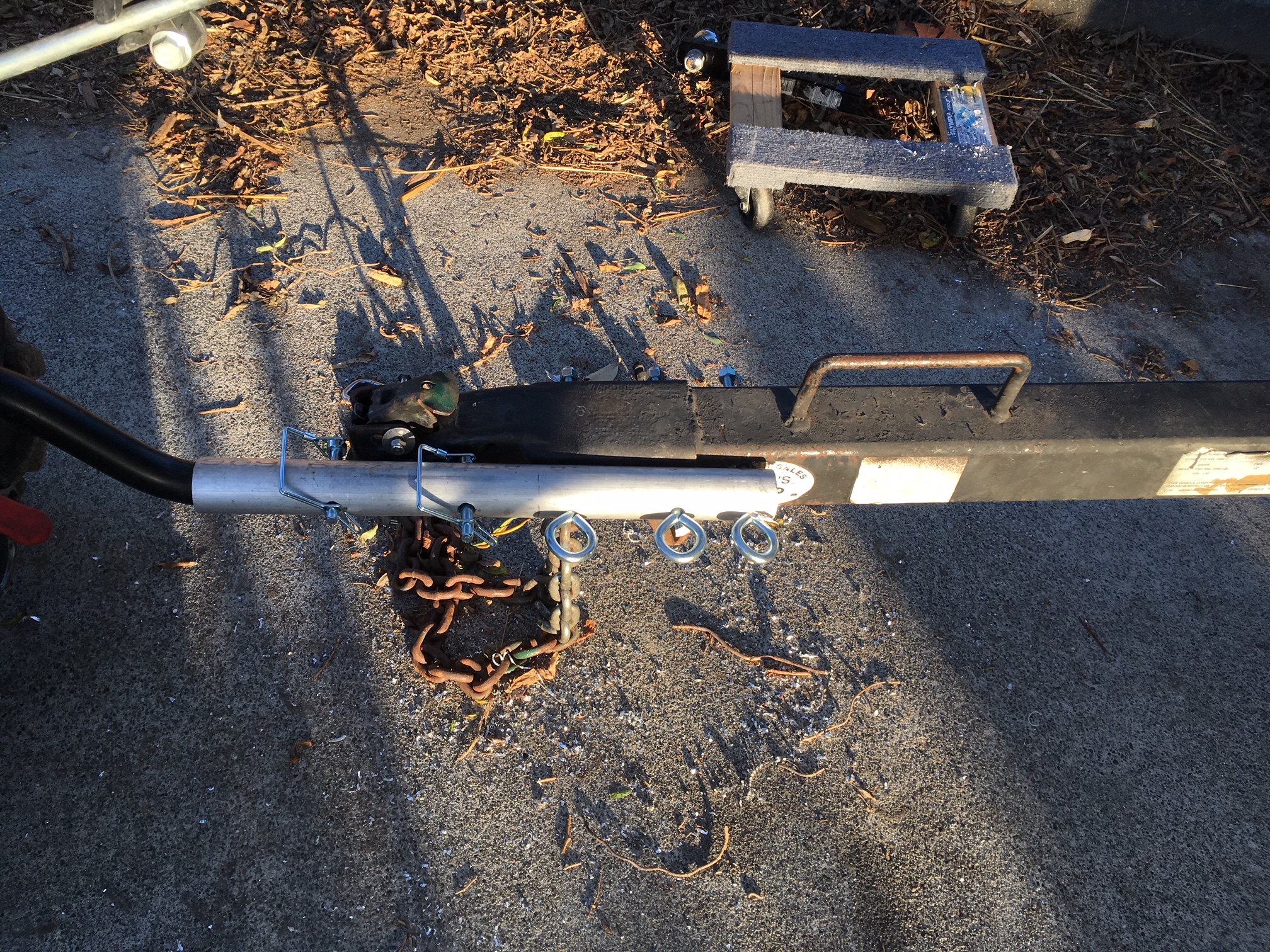

My DIY solution was to buy the curved coupler and drill a big hole in the end of a trailer hitch adapter to attach a trailer with a 2" square tube. Working awesome so far! Posted some pics up here:
http://www.tractorbynet.com/forums/2-wheeled-tractors/381548-my-new-bcs-trailer-setup.html
Nice setup!
My trailer has the ball hitch tongue welded on already, so I'm going to have to attach something to the side, that will look a little funkier, but hopefully still works...

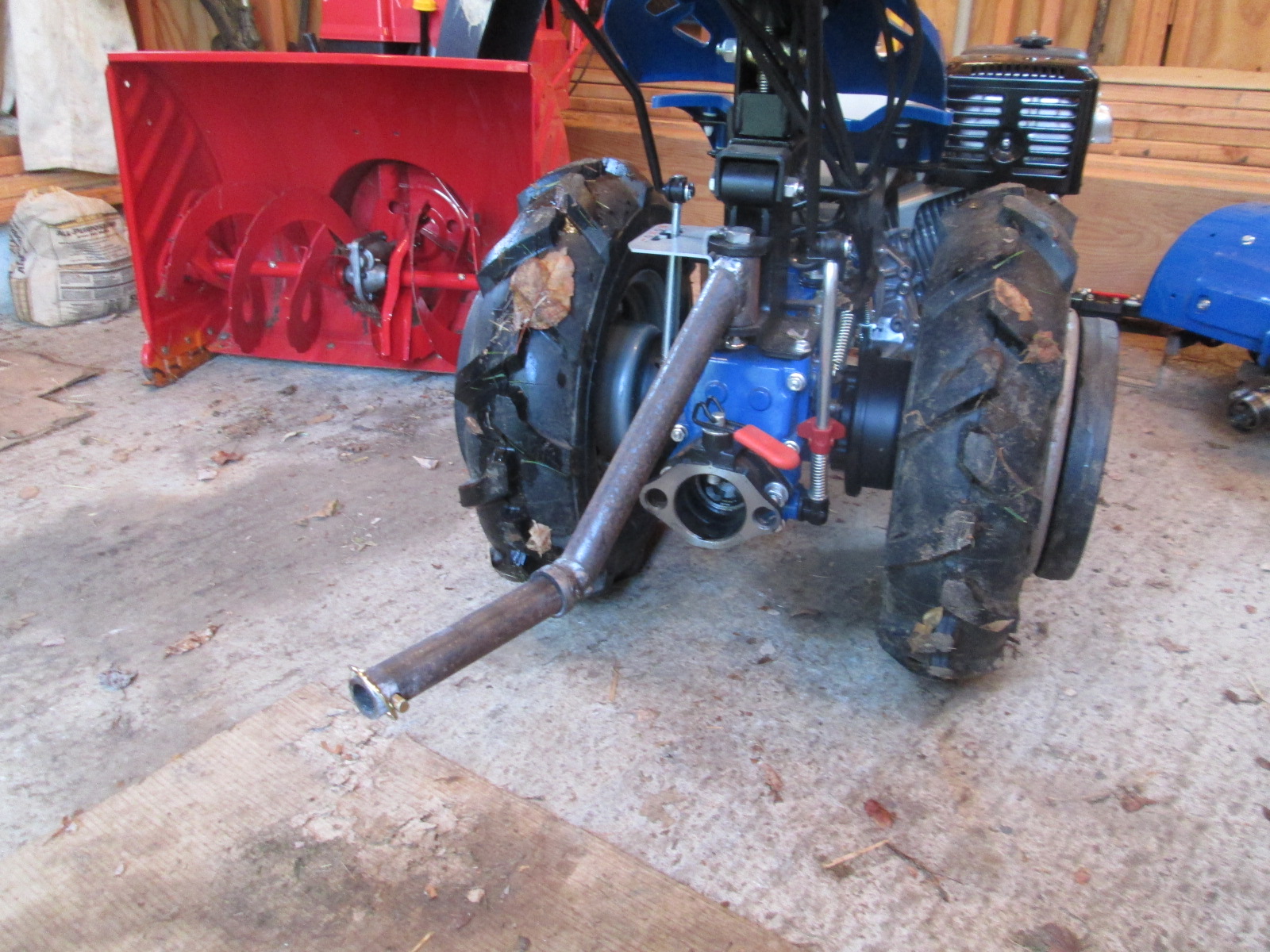

Here's my super simple curved coupler.
You can use it for any attachment that you want to pull from behind and ride on. Here's a disk harrow.
And a wagon.

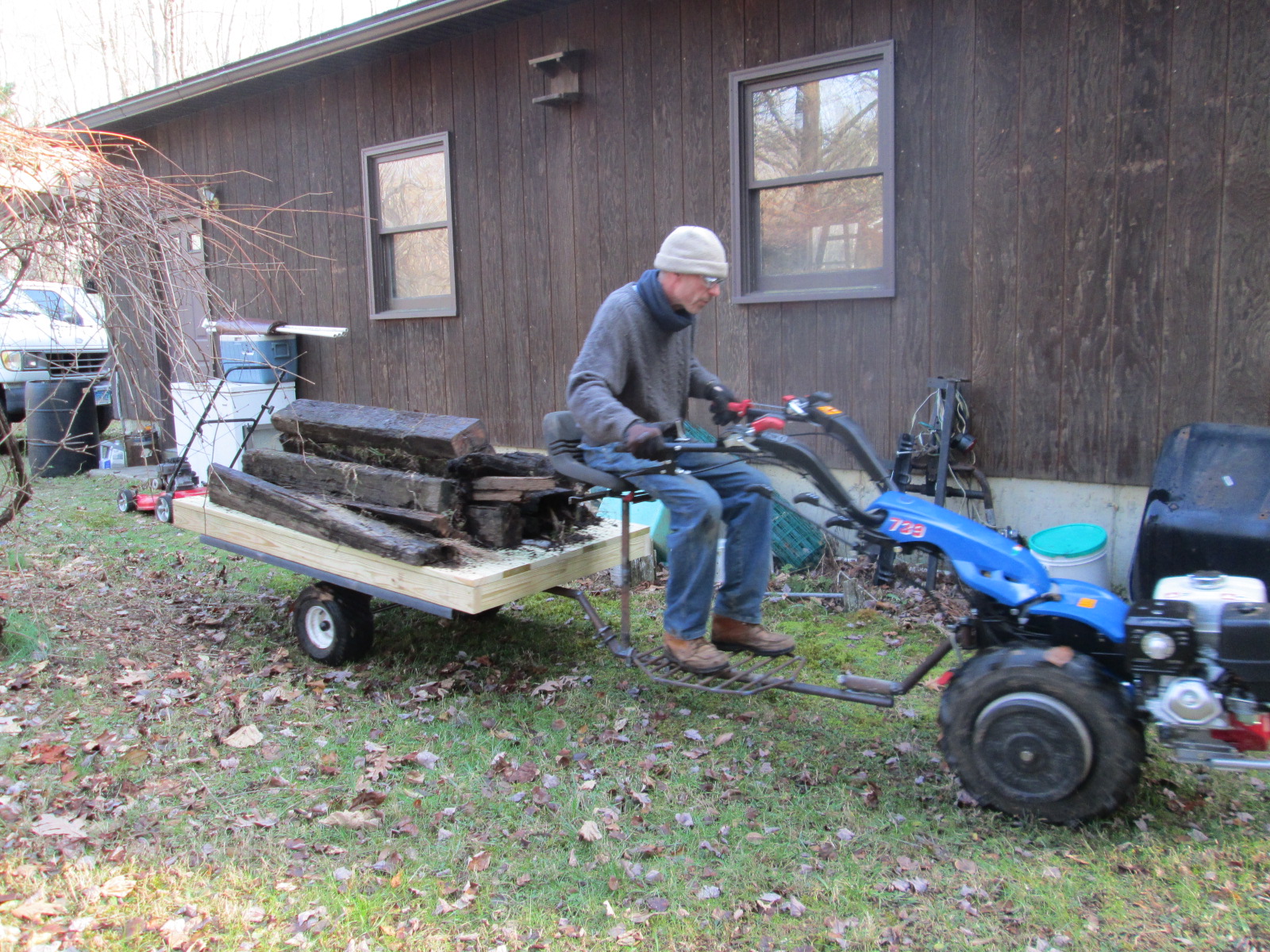

Here's what I came up with.
The trailer is one I already had, a 4'x6', made for the road, however it does tilt to dump loads. It gets me up my 30 deg slope paved driveway with a light load, I have yet to try it out in our fields. I'm hoping to put on a seat on the rail of the trailer. I like the foot rest NibbanaFarm has.
