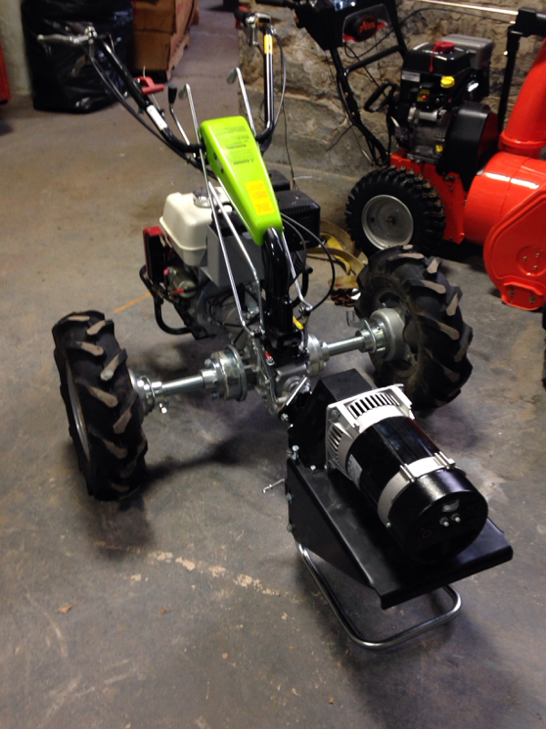

Here is a pic of my setup. I have the generator installed here.
One issue with this setup is ground clearance suffers since the wheels are so far apart.

thanks for the photo. that looks slick. My original thought when purchasing the tractor was to dual-wheel the 10 inch rims to get extra surface area but also keep the tractors center of gravity low. Seems like ground clearance is something lots of folks have issues with though. I'll give mowing with these size wheels a try first, but I possibly should have gone with a larger size.
