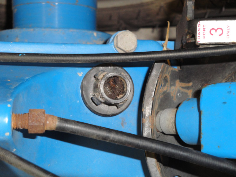

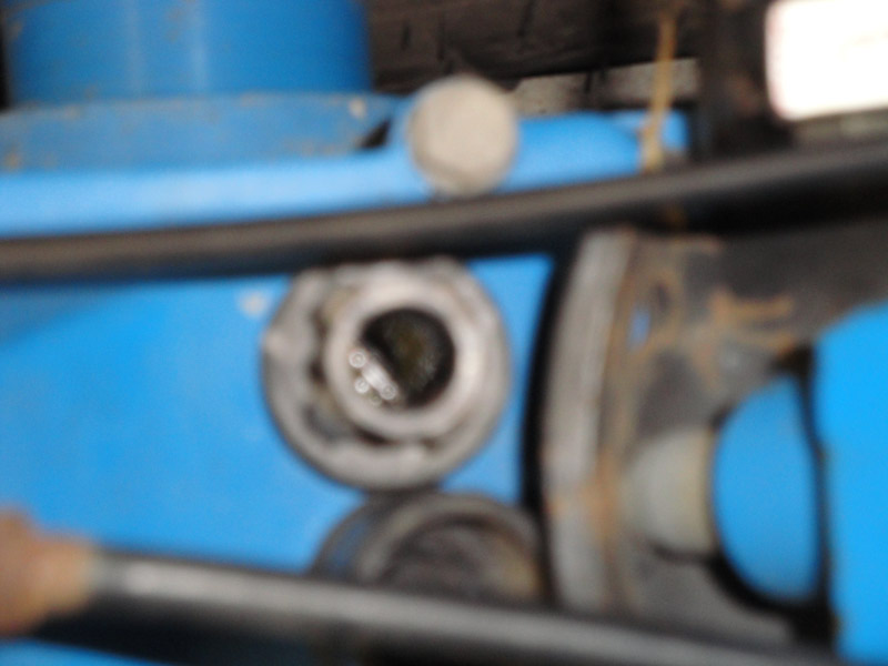

Transmission oil filler area that was plugged with a nylon mesh plug and no dipstick.
I took a long plastic wire tie and put down the hole. There was oil on it put to about 6 to 8 inches. The oil was clear and did not smell burnt so I guess I just do not have the correct filler cap. I will check the tine area for the oil tomorrow. Thanks again.
I think you just got the top off the dipstick, all the black plastic comes out of the hole and the mesh you see is just part of the vent that is built into the dipstick. Take the rest of that black part out, usually they stick pretty tight, and you will see the rest of the dipstick.
There is nothing else down the hole except for a piece that runs through the middle of the hole a little way down. Are you suggesting I try to pull up the entire piece of black plastic that the cap sat on? That seems to be mounted pretty secure to the transmission. I went out and removed the plastic piece attached to the transmission that the cap was attached to and that did include the dipstick. I REALLY appreciate your help and I need to get a manual for this tiller as I had no clue nor did the previous owner. There seems to be plenty of transmission oil and it is clear with no apparent issues. I will still replace. Do you now what is the recommended transmission oil.

You pulled the top off the dipstick, all the plastic needs to come out.
Pictures make things so much easier
