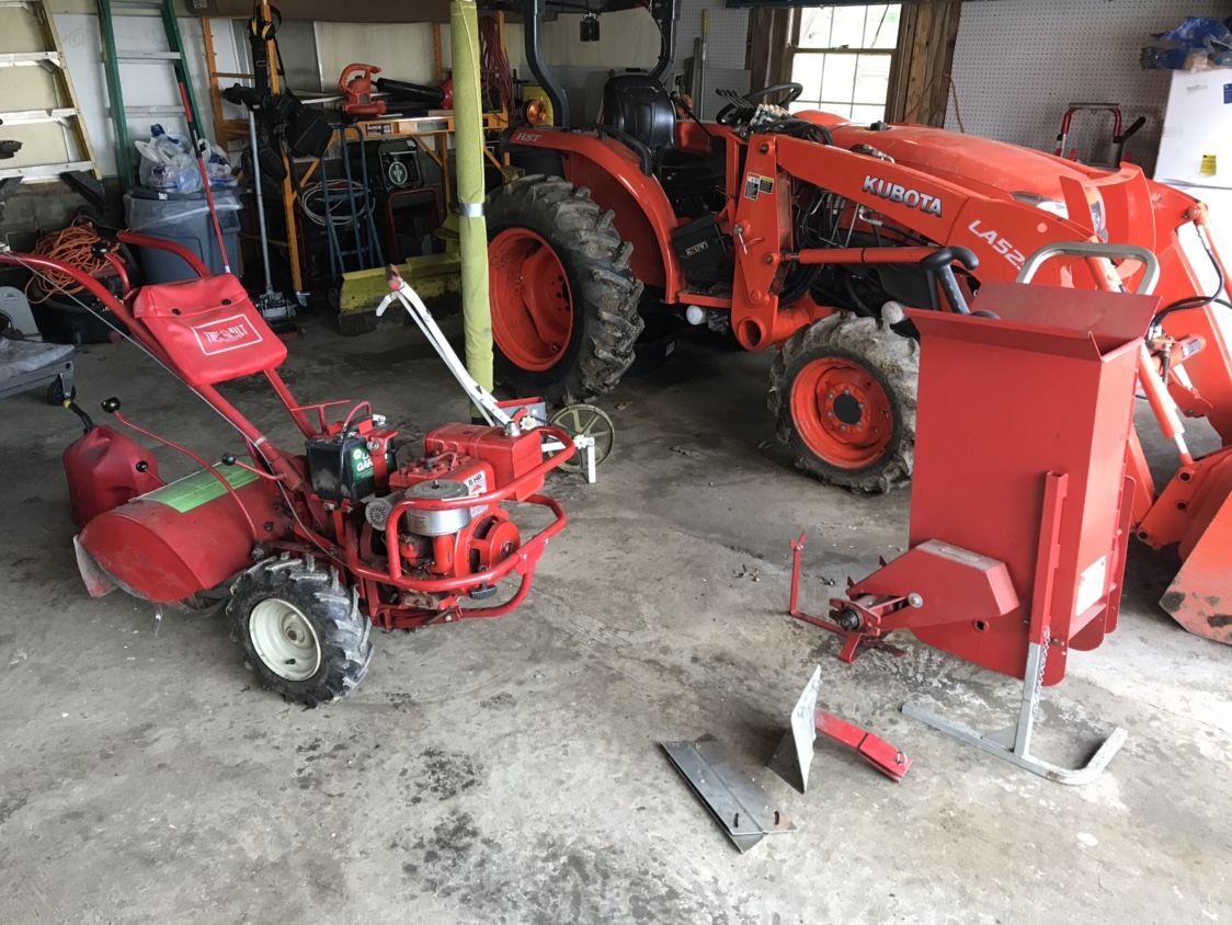

Guys, I didn’t get a Gravely or BCS (yet).
Found this Troybilt Horse with chipper, plow and hiller attachments for 400. It came with the planter also in the picture with assorted seed plates.
Also the manuals, and cradle for tiller and stand for chipper.
Pretty neat ol piece of equipment.
