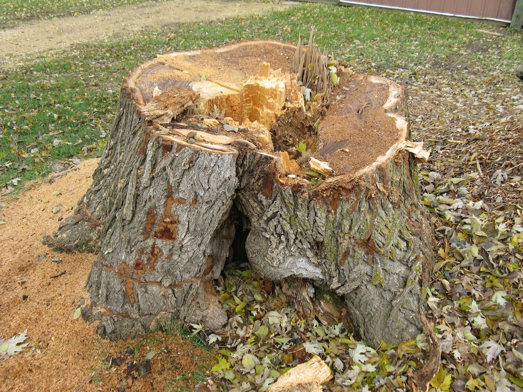

Tree was not dead but still rotten on the bottom. Cut it down last Saturday. Wife and son both were standing well away from while I did the felling. Stump is 42 - 48" at the cut line, approx 80 foot tall. For extra safety to prevent barber chair I wrapped my come-along around the two branches about 15 feet up and wrapped two 2" nylon straps around the trunk about one foot above where I cut. Still made me more cautious that a long tailed cat in room full of rocking chairs.

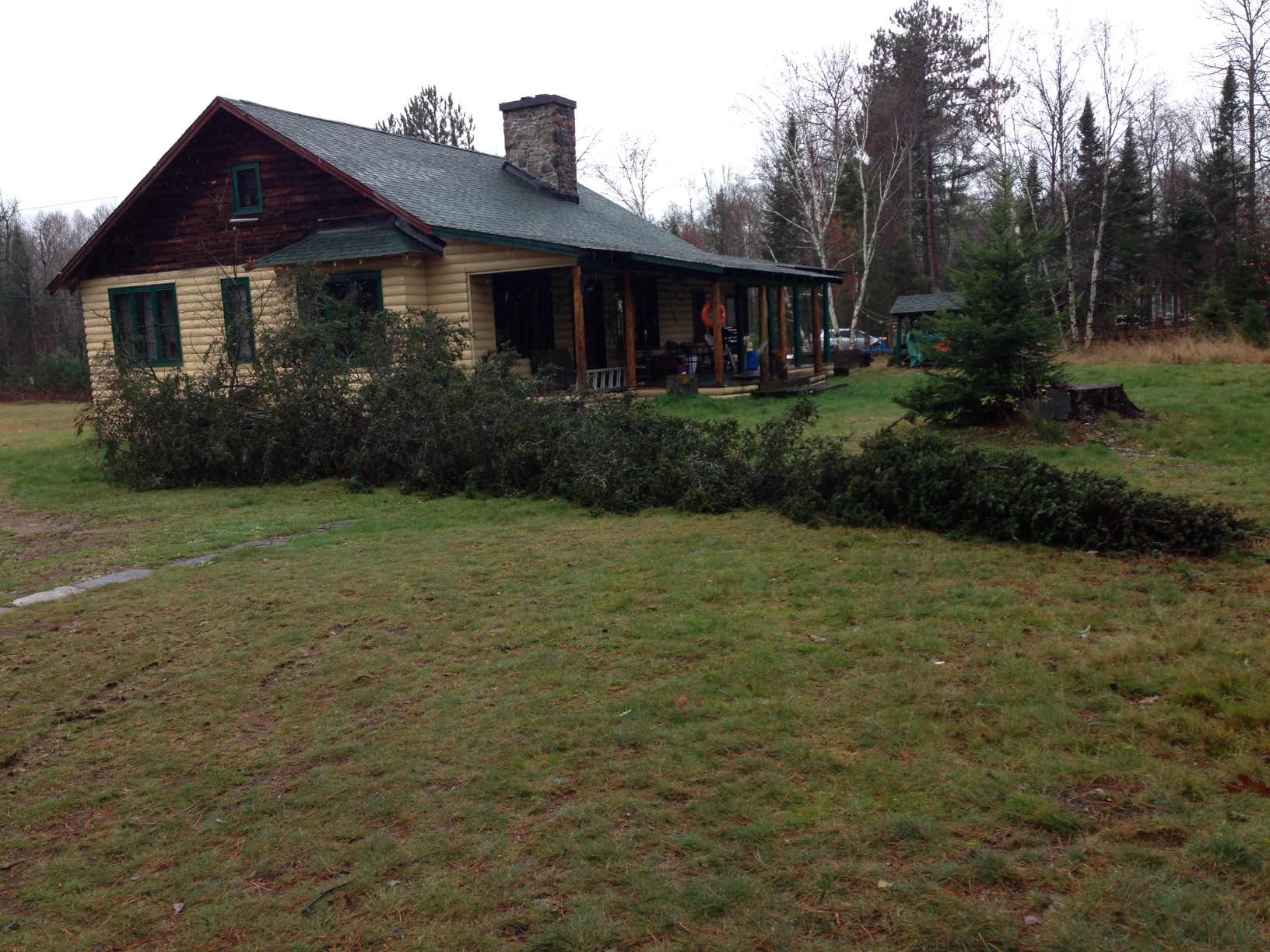

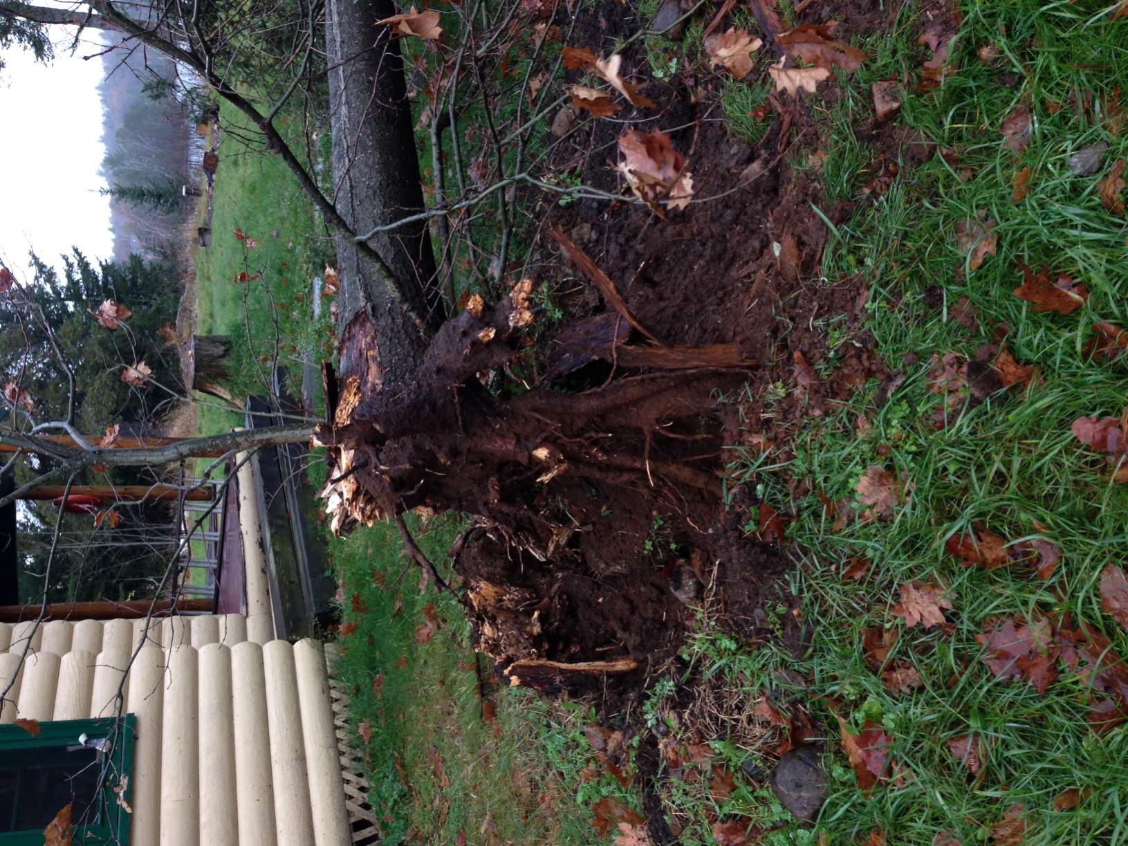

Here's one that went down by itself, during that last big storm up here. Stood tall for many many years, and looked completely healthy.
Luckily, it fell right between 2 buildings! (Fortunately, no stump to dig out.) It's a nice snowy day out right , so I think I'll go out and burn it.
